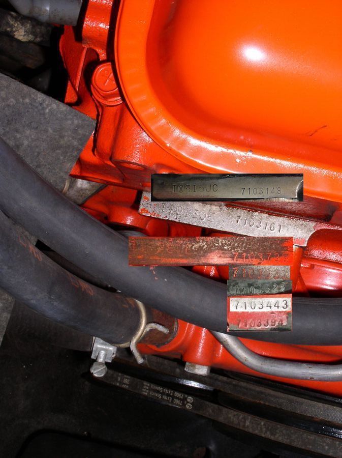

Looking for opinion on stamp, a friend is interested in car . Thanks

It’s a very poor picture to get a good evaluation. But it the pad looks altered

What year is car. On a 63 the location of the group of numbers are oppostie what you show. The vin is on the bottom of the pad and engine number on top.
Big blocks have this stamping reversed from the small blocks. For BB the engine stamp is done with the heads off due to interference (if heads were on). This leaves a clean surface for the VIN derivative. Small blocks do not have this issue and have always been stamped with engine assembly info on the upper part of the pad........leaving a clean lower part for the VIN derivative.

You need a better picture that is taken closer to the pad so you can enlarge it more. I am a complete amateur on stamp pads. I am curious what the experts have to say.

Trust me, you don't need another picture of that pad to make a determination on it's originality.
