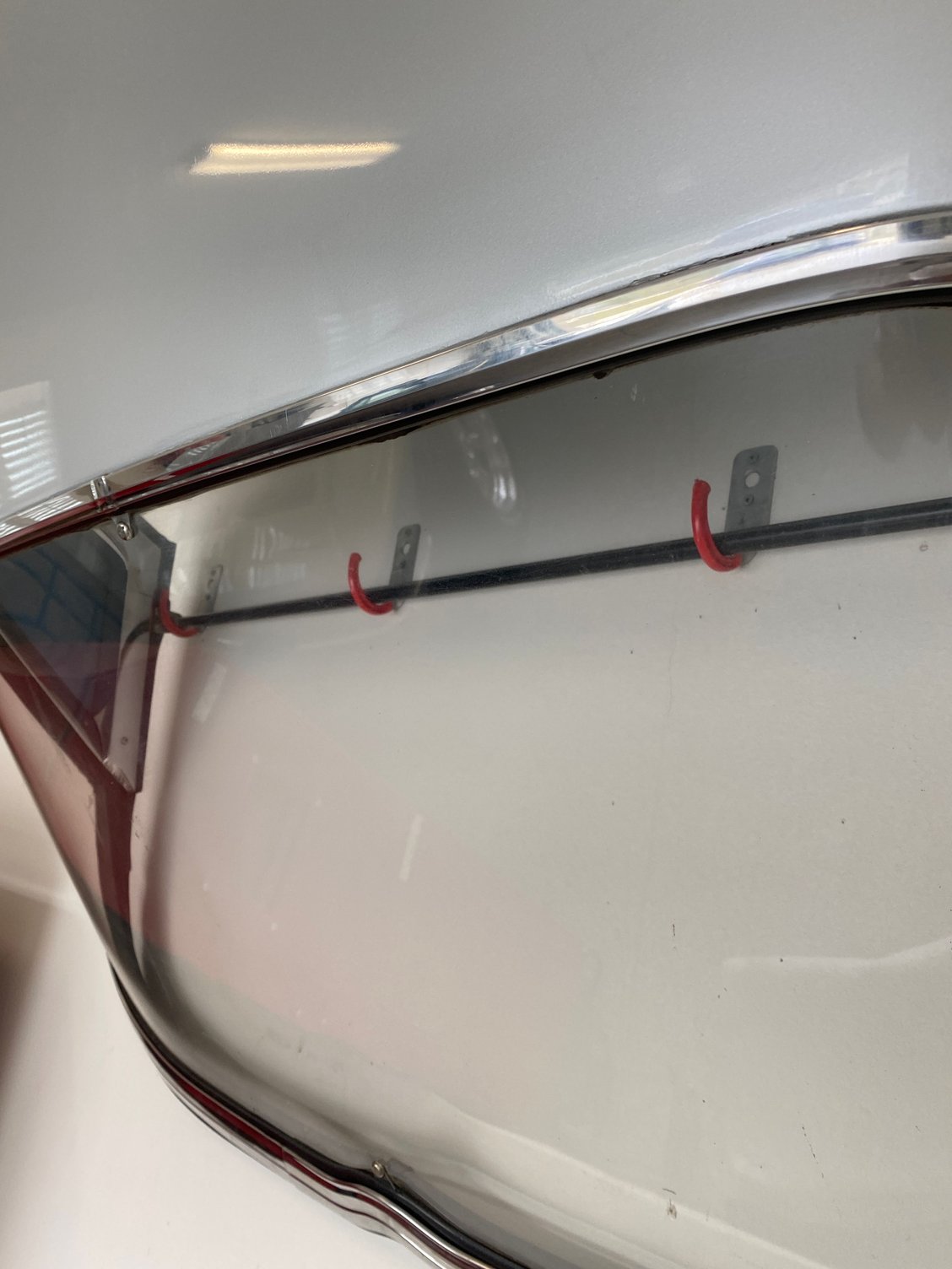

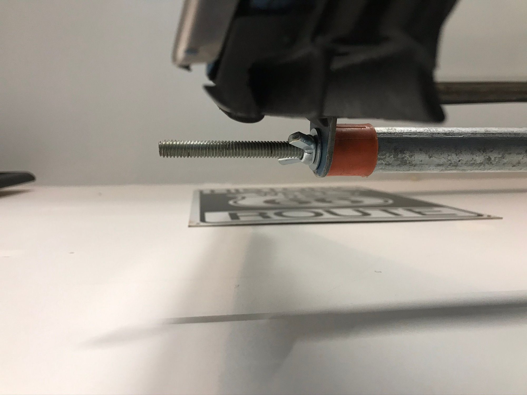

I finally got my hardtop stored on the wall out of harms way. Used 3/8 all thread rod but also used a 3/8 black steel structural pipe to add strength. Used 4 cast hangers from Lowes and if you are on 16"stud centers 4 of them fit perfectly and provide a level of security with using 4 of them.

Glad you got it stored without taking up much space. If you don’t plan to USE your hardtop and don’t need the extra wall space your solution works just fine.
However, I like my solution MUCH better for a couple of reasons. You can see it and info on how to build it in post 40, 48 & 56 of the below link. It allows for one person removal and install and only takes up “air space” rather than wall space that can by used for shelving, picture, etc. I have parking stops on the floor of my garage and pull up to them and my car is perfectly positioned for removal and install by one person.

Thanks for the link..I have only put the HT on once in 5 years at that was only to move the car from ATL to the gulf coast a few weeks ago. If I was constantly taking it off and on I would look at lift system.
