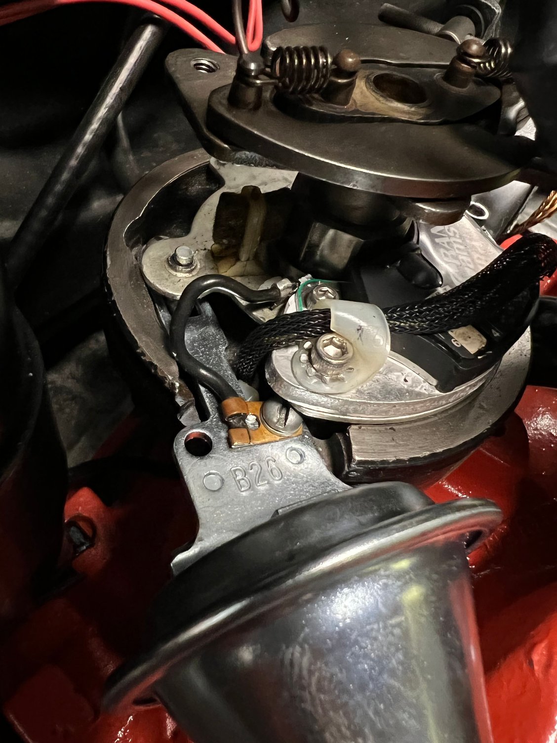

B26 can in.

I finally got to run this motor with the B26 VAC. RPM's @ 650+/-. Vacuum off the manifold is 14-15. The initial timing with no VAC and hose plugged is 8*. When I add back the VAC, timing advances to 28*. This seems excessive to me. What am I missing here?
That does seem a bit high. I thought the B26 produced about 8 degrees of distributor advance, or 16 degrees at the crank. So, I'd expect you to see about 24* all in at idle.
But, does the engine perform okay with the B26 as is? If the engine seems happy with it and you don't hear any pinging anywhere, I think you are in a good place.
I haven't road tested it yet. I ran out of time and back yesterday but hopefully this morning I'll do that. Also, I'm re-reading all of the information I've put together from the timing/ignition stickies and posts on this forum to find out where I'm at and where to go next. I did try to map a curve by using the idle screw and my new dial-back timing light (which I'm learning about on the fly). Rpm's are +/- and read from the dial-back. VAC disconnected and plugged.
8* @ 600 rpm
17* @ 1000 rpm
20* @ 1500 rpm
21* @ 2000 rpm
If I were to guess, it looks like centrifugal was headed for being all in soon. I really wished I had a helper to handle the rpm's to take it higher to find out and next time I will. Is it possible the B26 is too much; adding more crank degrees at idle than I need? Admittedly, I'm not the best student but I do appreciate all help along the way. Thanks guys.

What's the idle speed set at with the VAC connected? Look at your centrifugal curve. 9 @1000!! That's a lot! Where does is start? Chances are the centrifugal has already started adding advance at a little over 600 or maybe be lower, and if there is no more than 13 @ 2000, then it's too fast and too short.
38 @ 3000 (30 max centrifugal, 8 initial) starting at about 900 would be a lot better. Your idle vacuum indicates a little less valve overlap than L-79 , so an optimized L-79 should work pretty well.
Duke
Duke, the data you mention here is not mine. I'm at 8* @ 600, 17* @ 1000 and 21* @ 2000 with VAC disconnected and line plugged. Idle speed with VAC is closer to 650 @ 28*. Each time I connect or disconnect the VAC, idle changes. I've been readjusting the idle, up or down, back to 600-650. Disconnecting the VAC drops rpm's down to near stall; connecting VAC after compensating for the lower rpms, brings rpms up close to 1000. Should I be changing idle speed?

If you are using a dial back timing light with the VAC disconnected you are measuring the sum of initial plus added centrifugal. I merely backed out the initial and started the actual centrifugal.
You should select an idle speed with the VAC connected and keep readjusting it to that as you change things, like timing or centrifugal advance. Given the B26 VAC you do not want idle speed less than what it takes to pull about 14" vacuum.
You still have to learn the concept of a "spark advance map". So do a lot of others. Read my tuning seminar. Search for threads stated by me.
