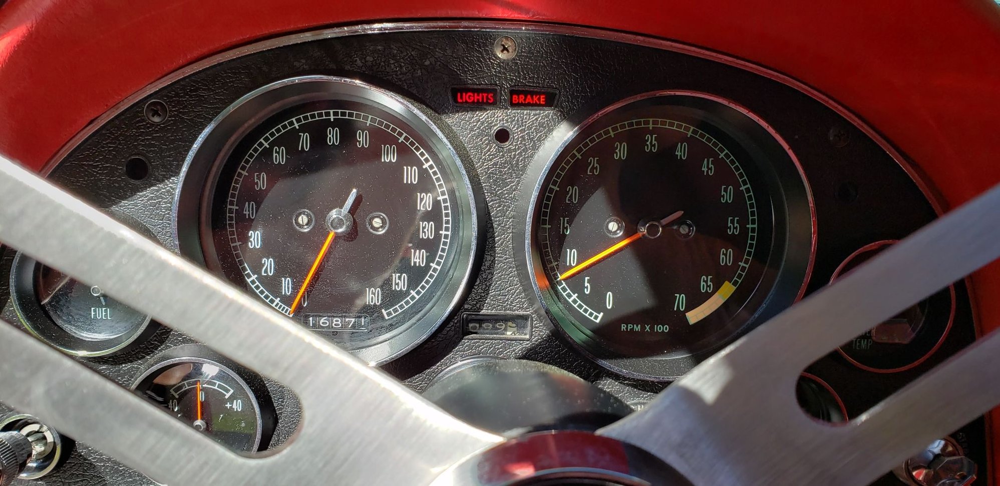

Old Jun 17, 2022 | 05:04 PM
Avispa's Avatar
Avispa
Joined: Mar 2009
Posts: 4,191
Likes: 951
From: Corpus Christi, TX
Originally Posted by vetsvette2002
Joe,
For your 67, yes, they will work. They use the same size base(BA9). Your LIGHTS indicator will not flash though, but the BRAKES light doesn’t use a lamp that flashes, AKA type 257. I don’t see the need for an LED for the LIGHTS indicator as at night it is plenty bright enough.
Maybe on a '67 both will work. On a '66 the LIGHTS indicator will NOT work with a negative ground LED. The socket wiring is reverse polarity. Same thing in the glove box. The BRAKE indicator will work with a negative ground LED. I just had my cluster out a few days ago doing this conversion, so the information is fresh. This is what a 1416 bulb in the LIGHTS indicator and a 3 watt LED in the BRAKE indicator look like out in the sun. It was as close as I could get to direct sun on the cluster. There is no missing these two! Not exactly a "filthy" cluster, although it's time for a refresh on the tach and temp gauge faces.
Does it matter? Probably not. The headlights won't be on during the day other than in the rain and you'll know if your parking brake is on without seeing the warning lamp. That said, to answer the OP's original question, if there's a flashing LED, I haven't found it yet. And regular negative ground LEDs won't work in at least one place (at least two on my car).
Like so many things with these cars, it's a matter of personal preference. Kinda like Nowhere Man doesn't care for power steering. If that's how he likes his cars, then there's nothing wrong with that. "You don't need......", or "It's not necessary" is good advice when the thing someone's asking about brings in a risk or hurts the operation or performance of something else in the car. LEDs are not one of those things for the most part.
