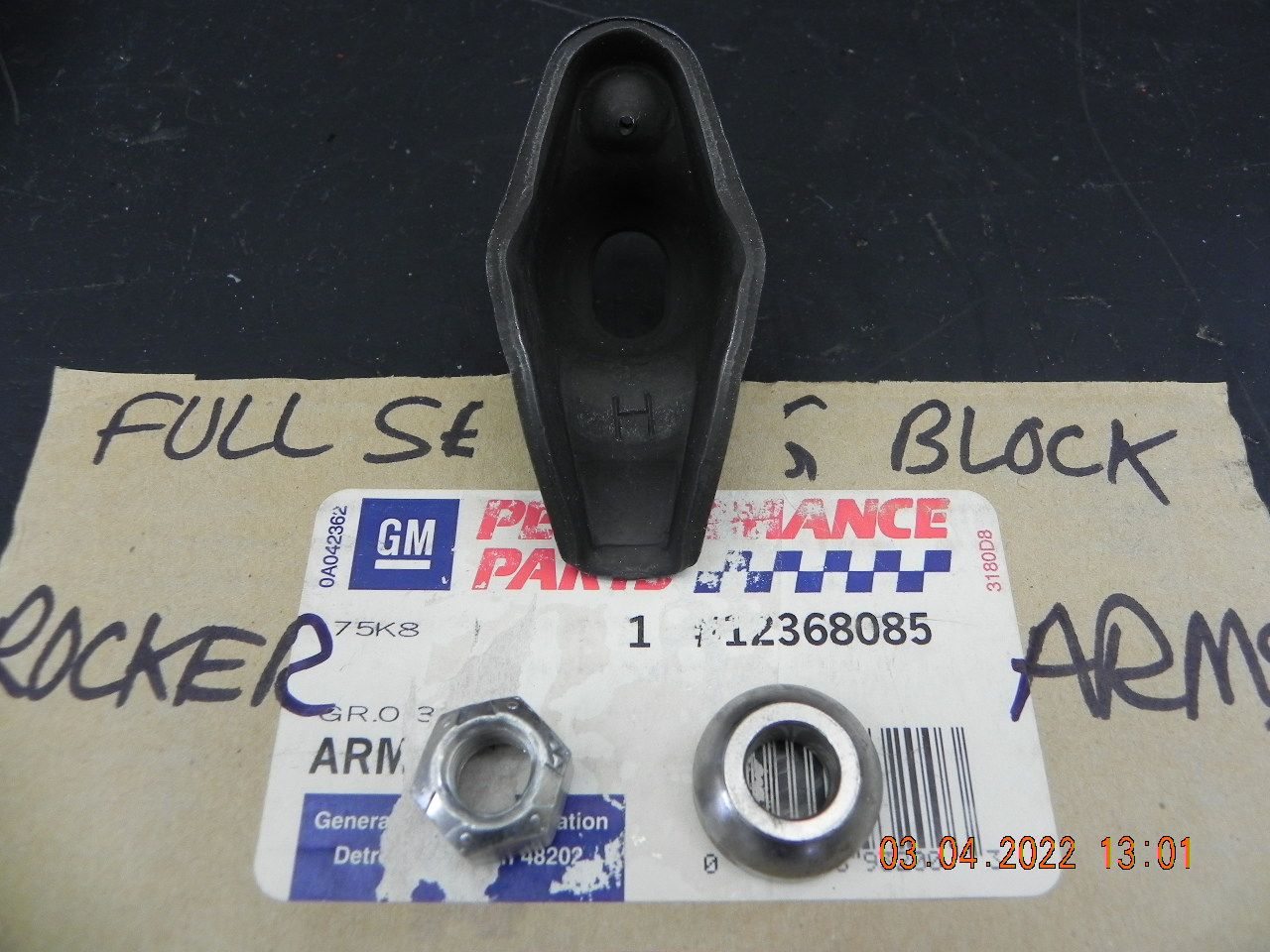

I looked up that cam number on Lunati's site, Summit and Jegs and couldn't find it. Maybe it is an older part number that's no longer produced.
The Speed Pro Lifters I have used and still find on those sites are actually listed as HT817R, not 617.
Rockers with the H are what I believe to be Bigblock versions with a slightly longer slot, maybe not. I have a couple sets, pic attached.
A bit surprised they are using L88 valve springs on what I suspect might be a hydraulic flat tappet cam but again, not sure since I can't dig up that Lunati part number.
