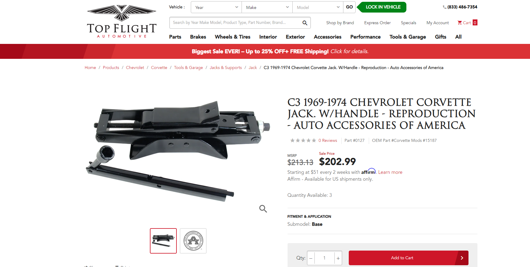

Judging by this picture from a parts vendor I would say you have a 69-74 C3 jack.

Agreed that it appears to be a C3 jack. The C2 jacks are noticeably narrower and shorter. Try to fit that into the well behind the driver's seat so that it sits parallel to the rear axles - bet it won't fit. The C2 jacks have a hex nut at the far end rather than a tapped rectangular block. -- at least in my experience between my '67 and '72 jacks.
