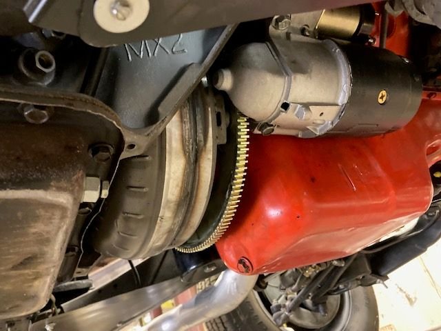

Just did it! TH350C (MX2) build for a 450 range HP....Unheard of for an L71. Most definitely not Factory standard OR optional for a 435HP. A good Corvette Guy could bring back to stock with no issues....Purchase, build and installation including, flywheel, starter and shifter.....
Good Luck!
Fit like a glove! BUT a lot of work, and a lot of saved parts.....
Prep work!
Shiftworks Shifter maintaining the Manual shift plate with a custom Saddle leather boot.....Auto Consoles are ridiculously priced, like everything else....
