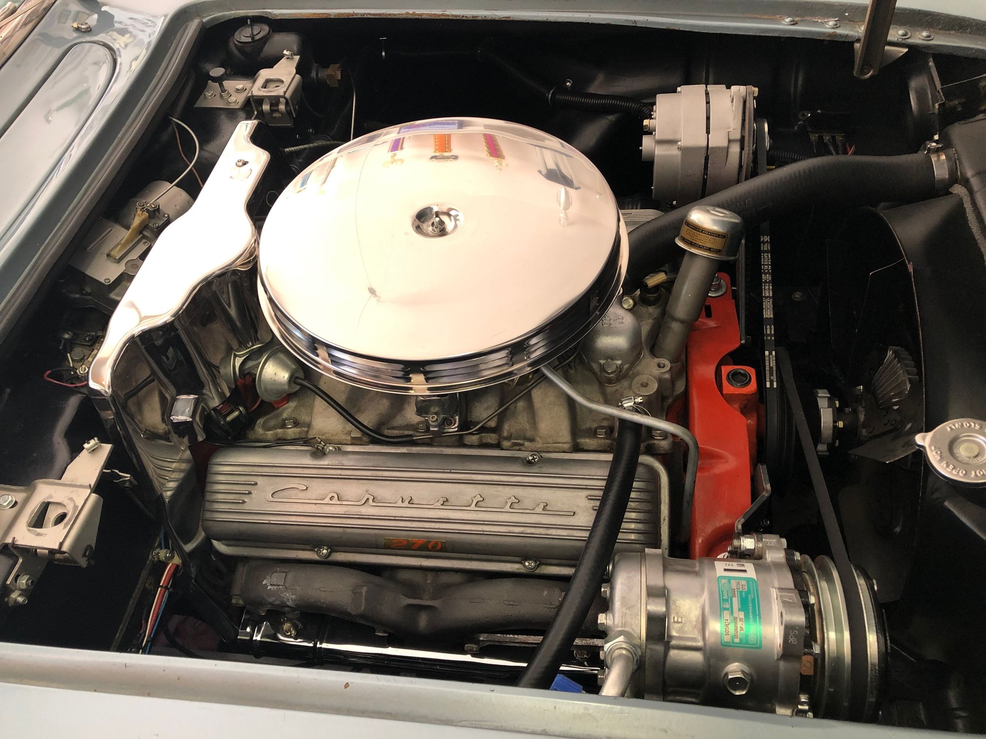

Yes you can, this is what I did. Had the fill tube in front same as you, then machined a hole thru the manifold into the lifter valley. Installed a Moroso baffle bushing and made my own baffle under the manifold. Works great, uses less oil, and was able to use my favorite valve covers.

I can’t take credit, got this idea from someone on this forum. The experts on this forum are great and able to solve just about any problem. If you need more info regarding this mod, just PM me.
My 350,
