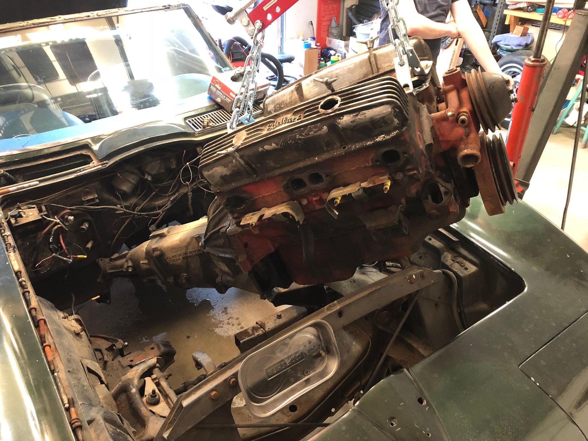

Engine mounts on, fuel pump off to pull the old CE 350 from my ‘64 coupe.

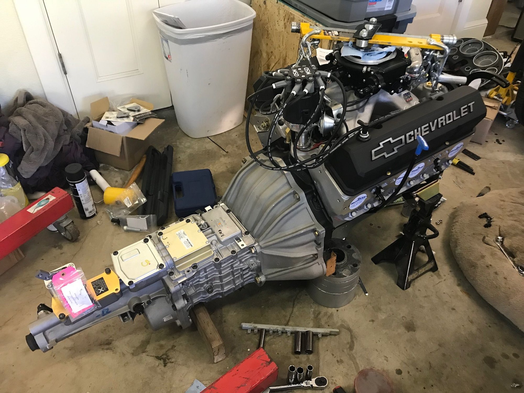

Engine mounts on, no fuel pump as the new engine has EFI.

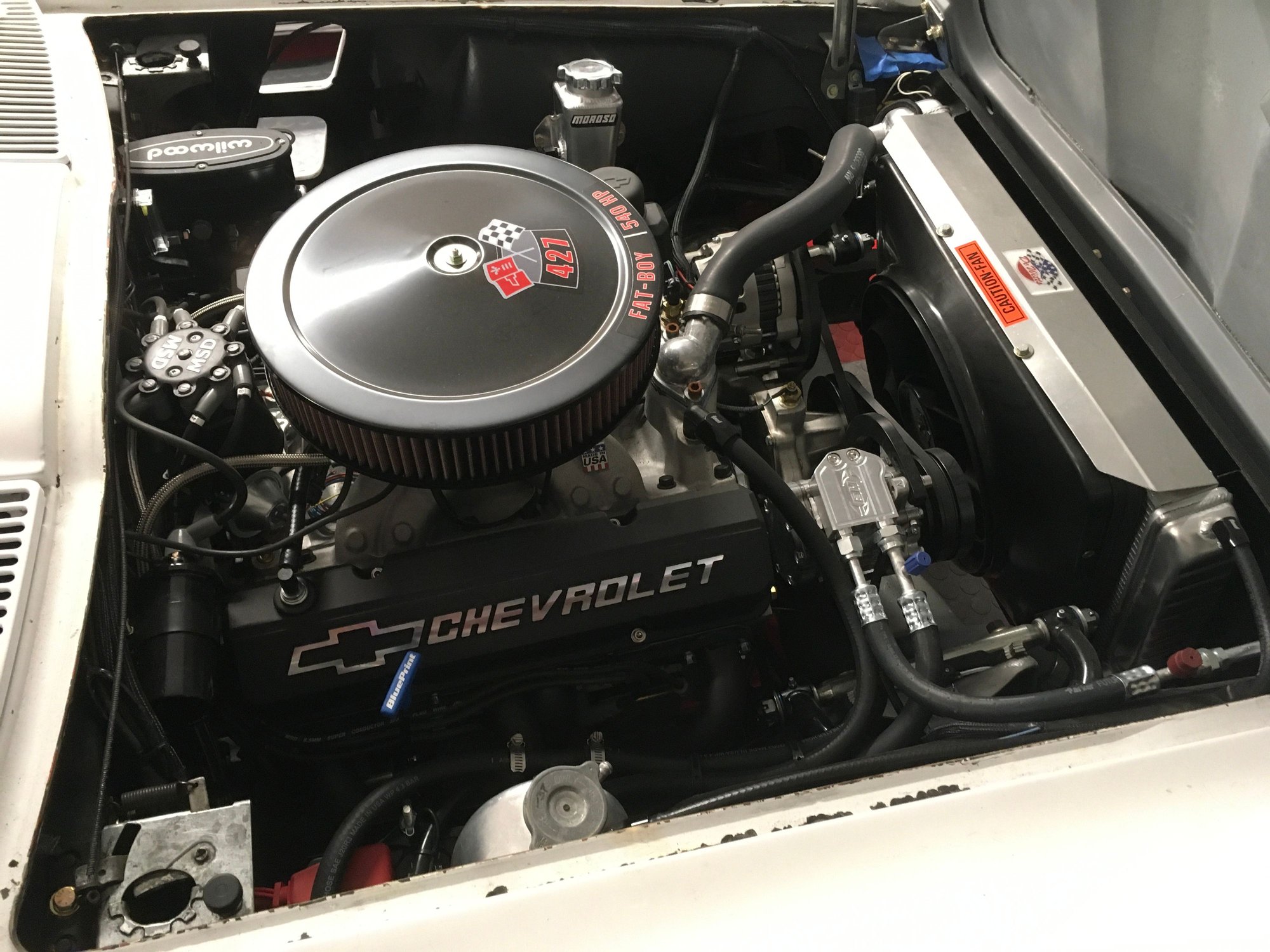

Slid right in, but test fit everything prior to installation.

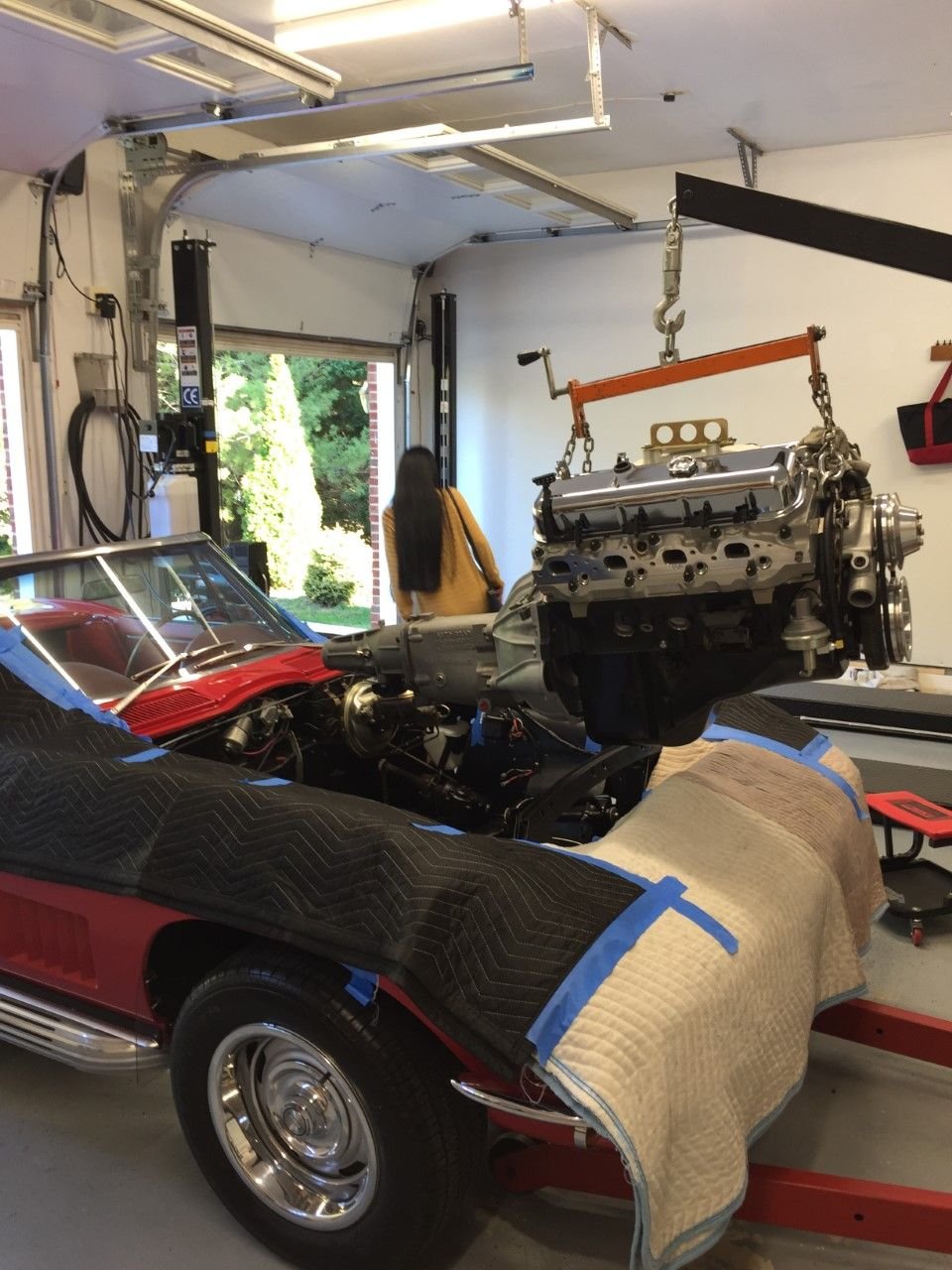

I attached the motor mounts to each side of the block accordingly prior to installation and also put on the fuel pump. Smooth as silk with no issues regarding either.
I was really happy that I had installed the fuel pump ahead of time. I was able to save all my four letter words for another project. C.J.
