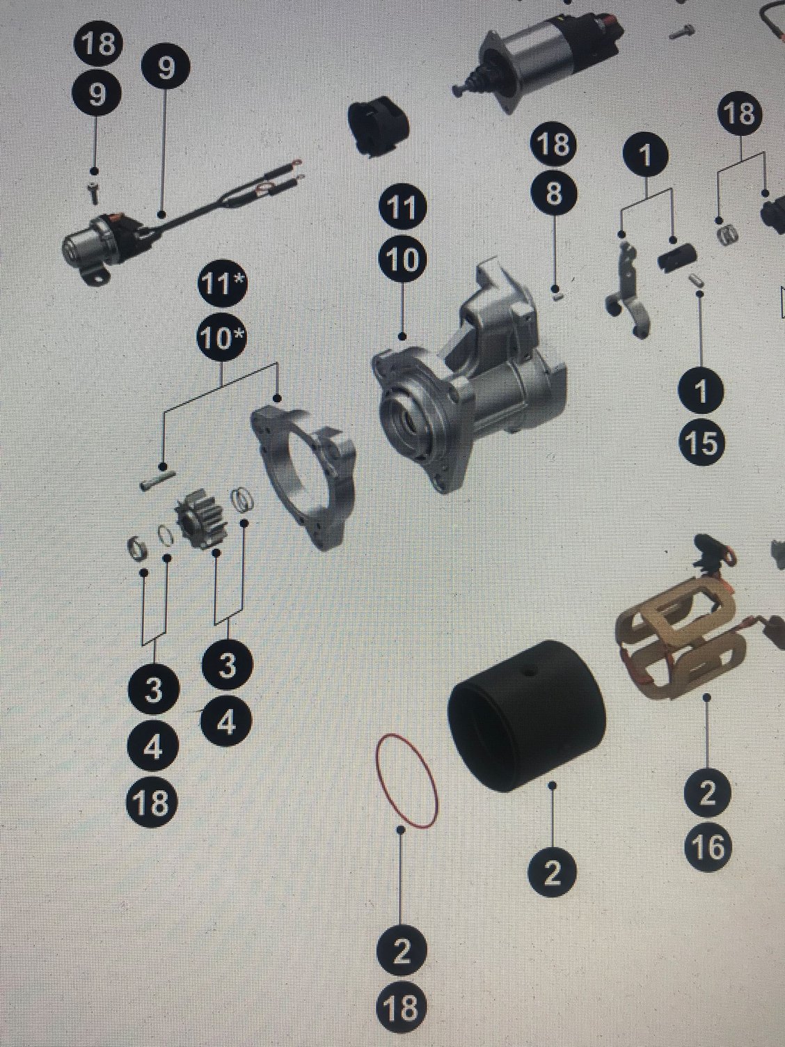

Likely not the clip you found, but there is a clip that looks exactly like the one in your picture that helps to hold the pinion gear in an AC Delco starter. We are rebuilding one and we had to remove this clip, which is why I remember it.
I have attached an exploded diagram so you see where it goes. It is on the right of the two items directly above the round black circle labels of 3,4, and 18. It is also slightly oblong as is the clip in your picture. Strange.
