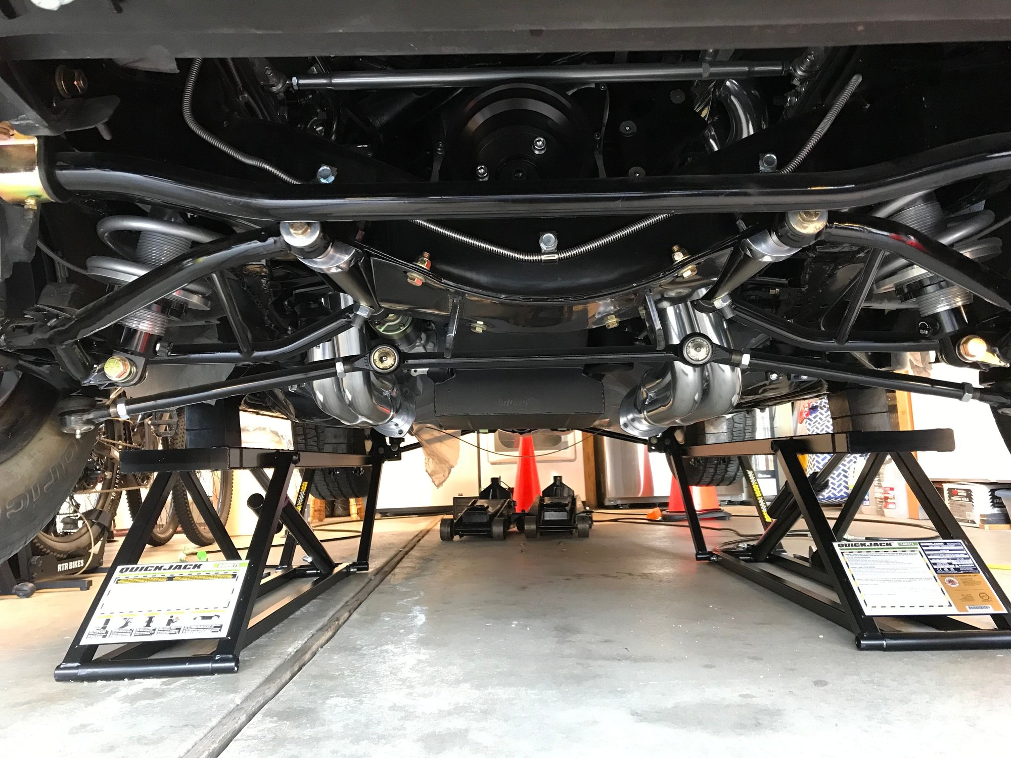

I have very limited work space in my garage and jacking up my car was usually more work and time consuming than I cared to do.
I fought hard against buying a set of Quick Jacks but finally decided that it was time.
I’ve had the system for about a year and now it’s so easy to lift my car.
The lifts stores under my car when not in use and I just slide the lifts into position, attach the quick connect hydraulic lines, hit the switch and safely lift my car.
I was actually able to lift it high enough that I was able to pressure wash the under side with no problems.
Here is a picture on mine up on the Quick Jacks and this is in the lowest position.
