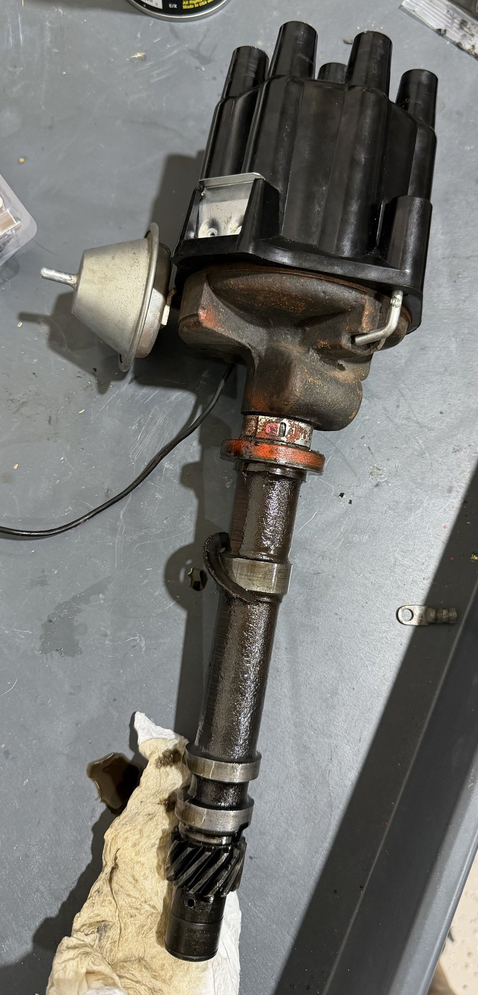

Check the gear on the distributor you removed.. If the top of the gear is " not machined" it should be Iron, flat tappet.....

From: Scottsdale AZ
this is what was in there.
Iron gear, flat tappet... I did not mean to open a can of worms here, better safe than sorry
Appreciated the one I got says melanized steel so I assume thats fine?

you can use the melanized gear on any cam.
Not likely to be an issue with your car.
