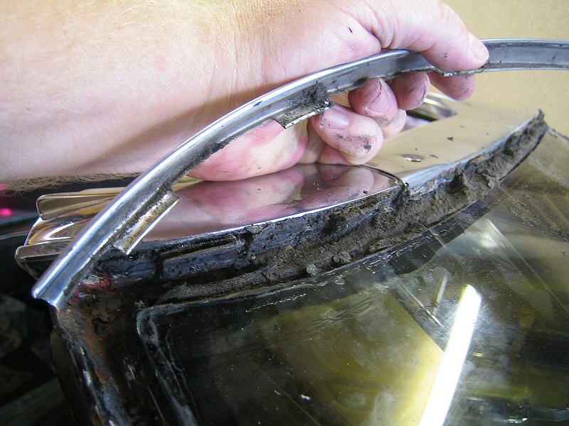

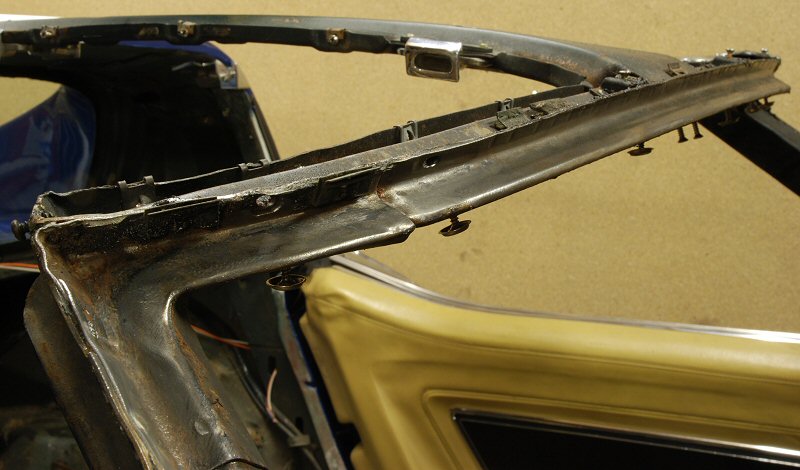

Hi Alan, here is a pic of my header that I took about two weeks ago. You can see that the clips are still in position at the top of the windshield, yet, no holes. I do believe my windshield was replaced as the sealer was so soft I was able to remove the windshield by just slicing behind the windshield with a utility knife and pushing it out by hand. It was still gooey. Underneath the t-top molding was the disintegrated spongey matter that must have absorbed any water like crazy if it got in there. Check out the broken clips, rust and crud inside.
