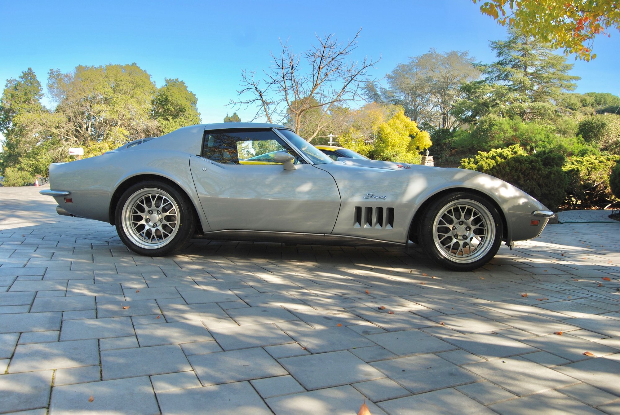

Originally Posted by Stuey1975
Edit: They did stop making 18X9.5. So my options are ....
18x8 front 18x9 rear or 18x10 rear
Can someone please help me find out what sizes and tires I need without doing anything past parking brake moving.
I would like to have it straight bolted on with no mods but if I have to move the parking brake that is ok.
I like that deep look on the back wheels, would 18x9 on rear look ok and what tire sizes do I need to go with because I cannot find the 9.5's to match any info anyone has given on here.
1979 with factory wheels now.
My 69 has 18x9 with 4.5 BS, tires are 255/45. The suspension is stock up front. No rubbing. T

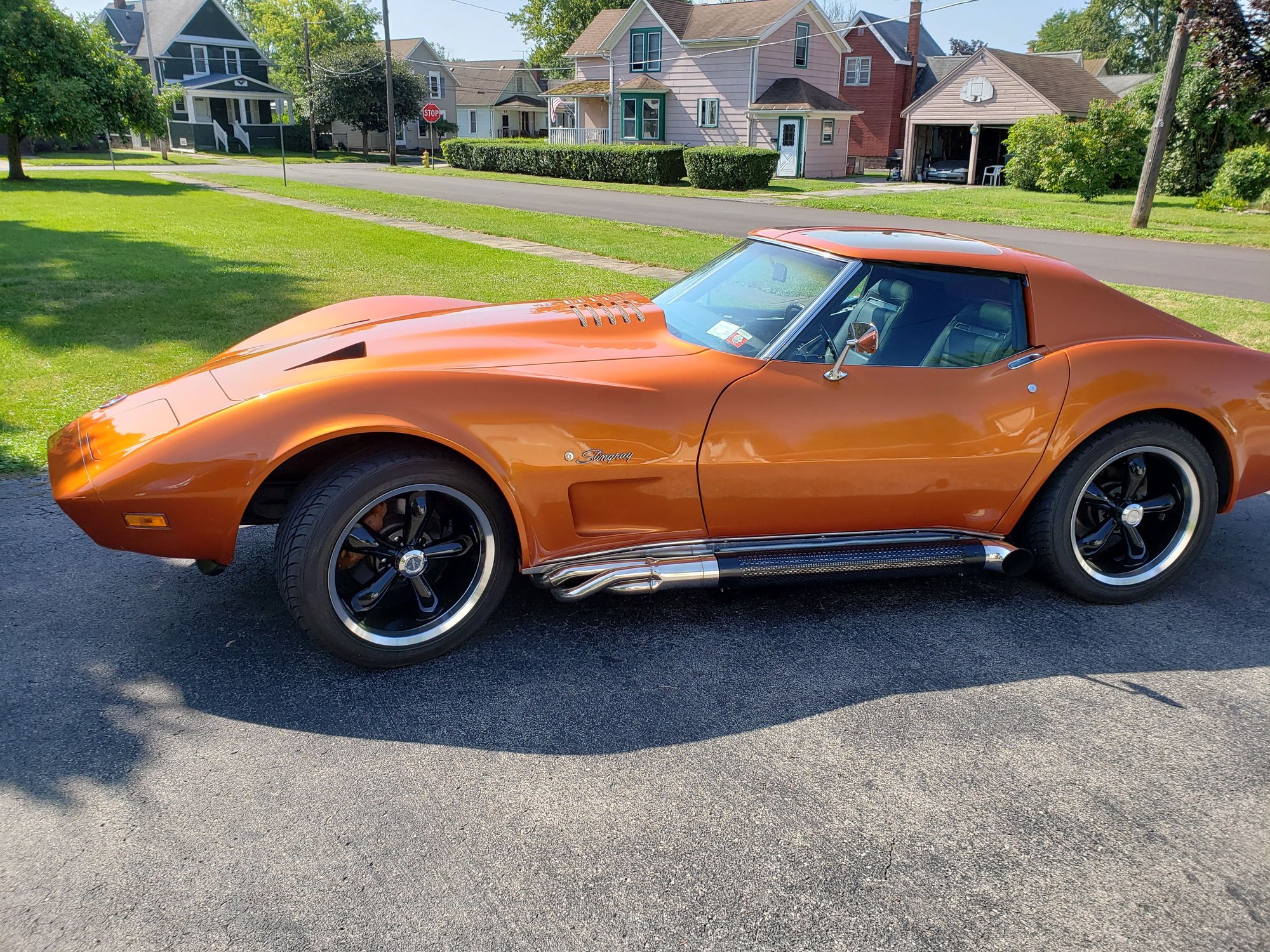

Originally Posted by Factoid
Got my wheels and I think they are perfect! My ‘69 is a dark royal blue and I think these will look great. I get the Michelin 255/45-18 tires mounted tomorrow.
They are a little darker than the Summit picture, but not as dark as the website picture.
I have the black version of these wheels on my 74 with 1/4" spacers... They have been selling them on ebay as well for years for a pretty good price.. I paid about $450 for all four but it was about 5-6 years ago.
not the best pic to show them off..
