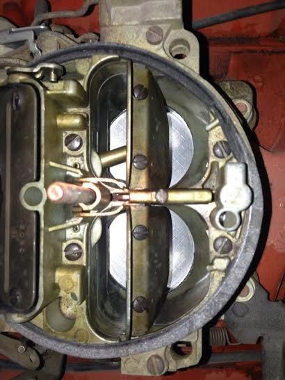

Fixed!
At least the secondary main discharge nozzle!
I went for a run and the car runs great on the secondaries!
But, I cant get it to idle right… the primary valves seemed bended… I should have replaced them. That will be the next job!
Some pictures!
Thanks for the help!

Your engine inhaled that nozzle?

It's quite possible: The tube is thin-wall mild steel, and is pretty soft - it will crush like tin foil. I've seen these nozzles go right through an engine with no damage at all to the engine. The tube gets pretty mangled, though...
