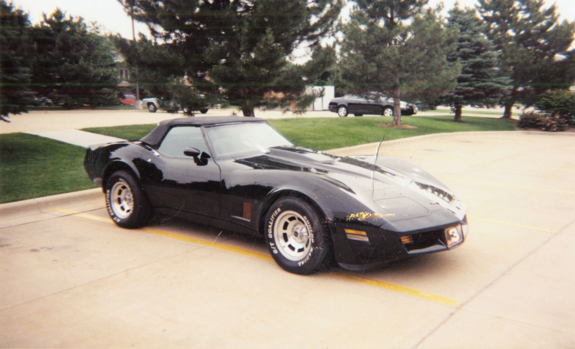

I had a "St Louis" 81 a few years back. The original paint was cracked. It was a 10 footer - closer inspection made her look like the surface of a dry lake bed The mom and pop operation I used sanded her smooth and then painted her with base/clear in the original black. I'm not sure if they sealed it first but it looked nice for several years thereafter.
Sorry for the rotten pic but this was before I had a digital camera and the only photo I have left is a bit nasty. This was just before I sold her at the Mecum auction in Bloomington, IL. The car was made into a convertible and attracted a lot of attention back in the day.
