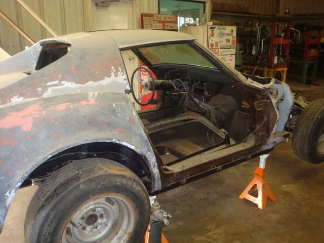

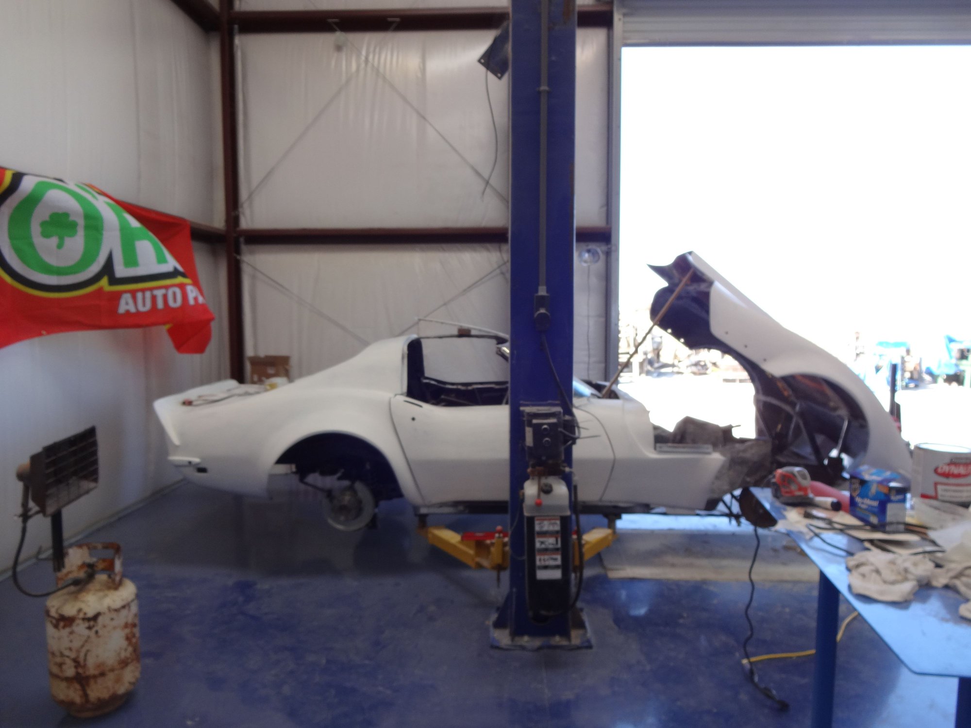

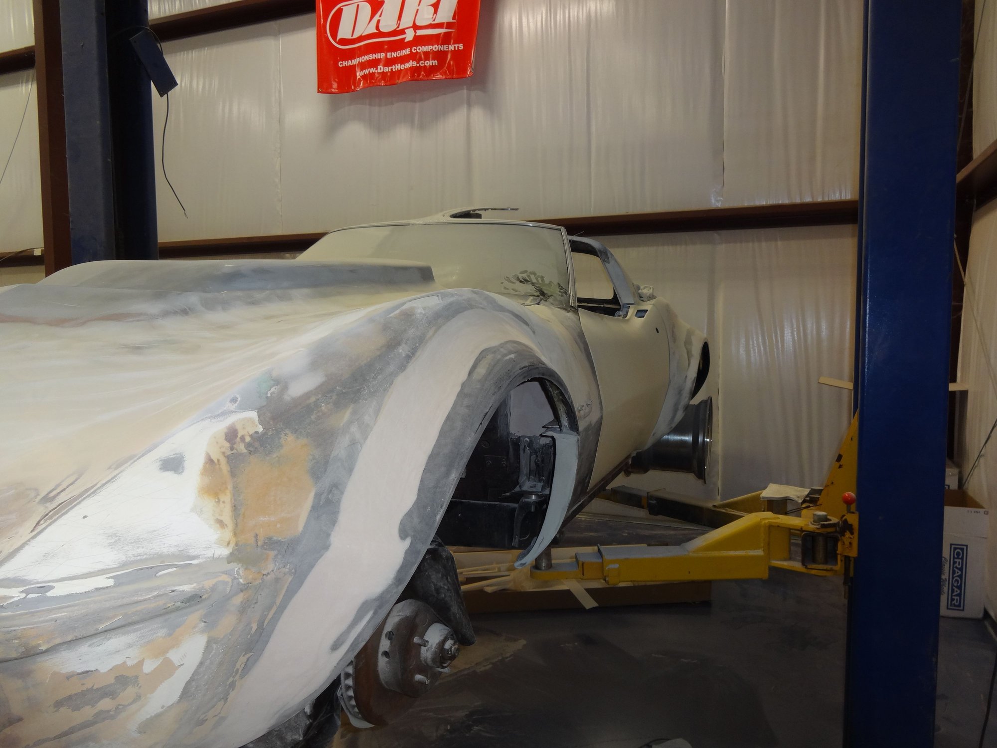

I've read about other builds and looked at the pictures....so I wanted to share some of mine. I've got a lot of great ideas from this forum so maybe I can pay back or inspire someone else. I hope I get the pictures posted right! Since I started the build I built a new shop and it is now in the new shop with a lift.
Would love to hear comments or suggestions.

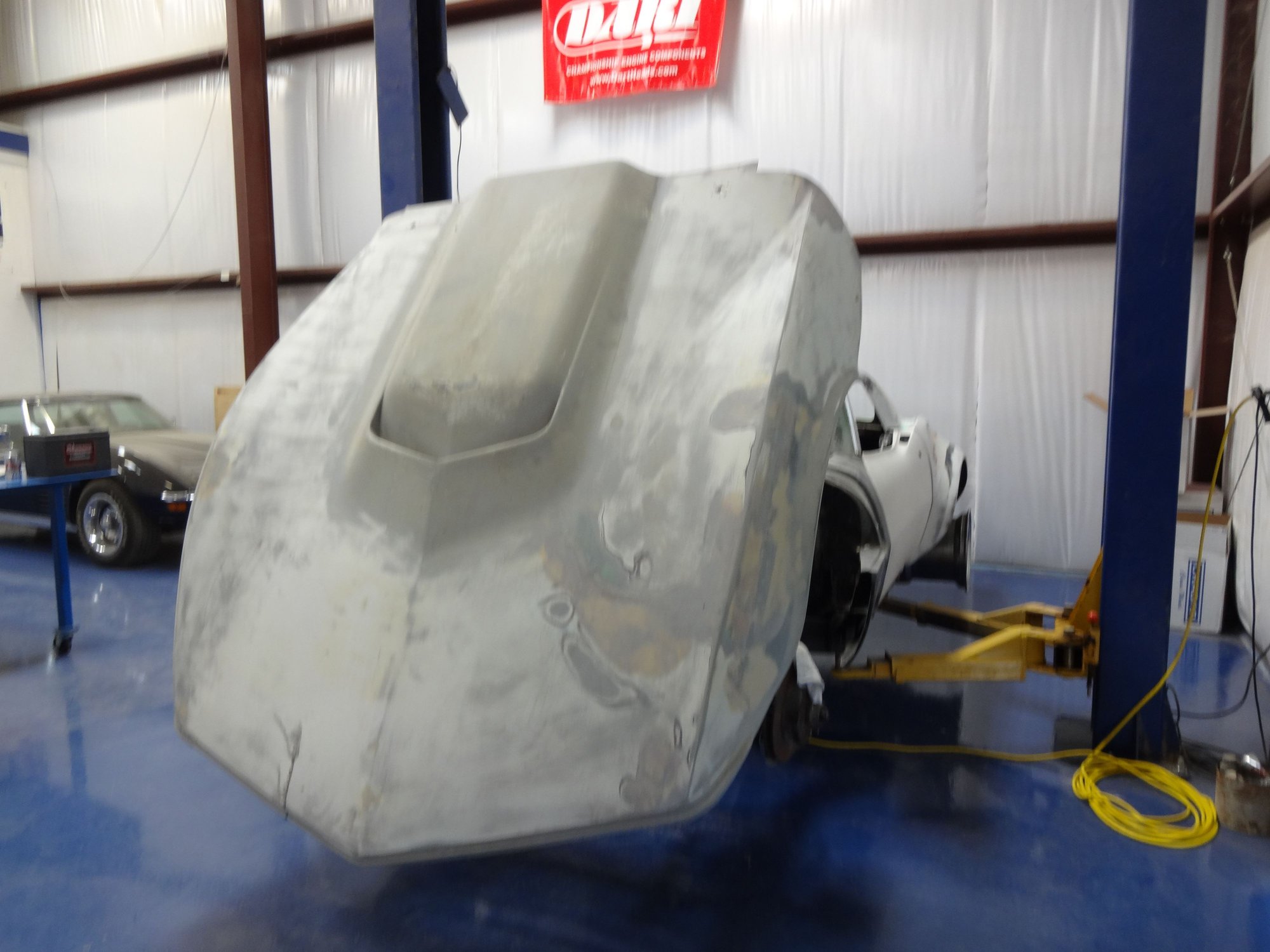

I dont have a high tech set up but my 69 build is on here and I too am doing a tilt front clip,
Do you have some pictures of your hinge/pivot point, I like to see how others do that....

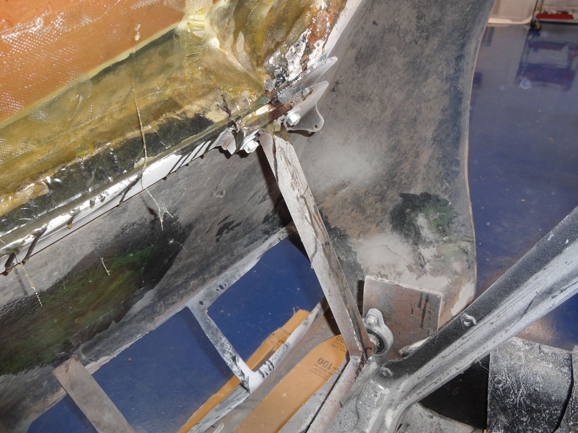

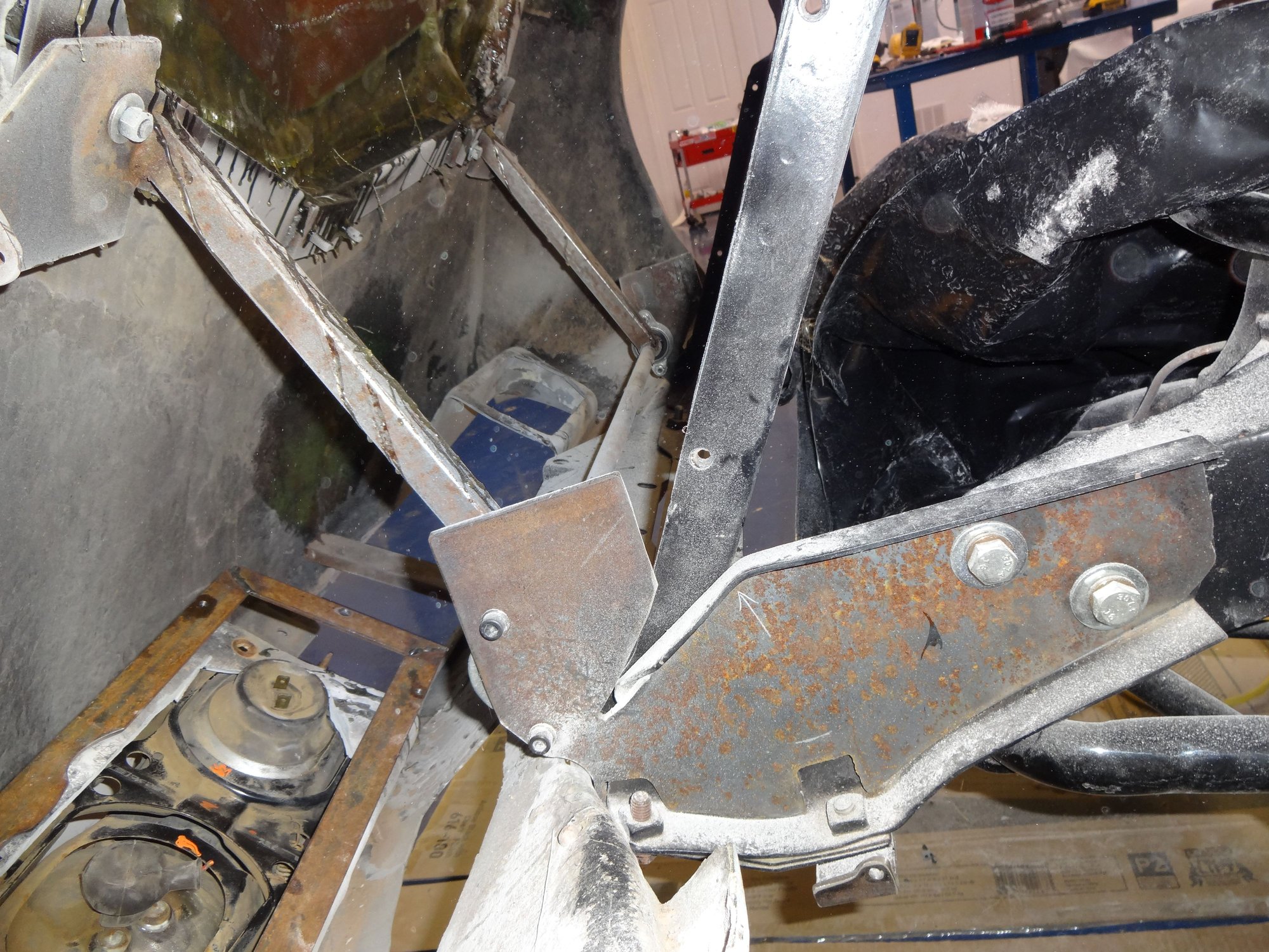

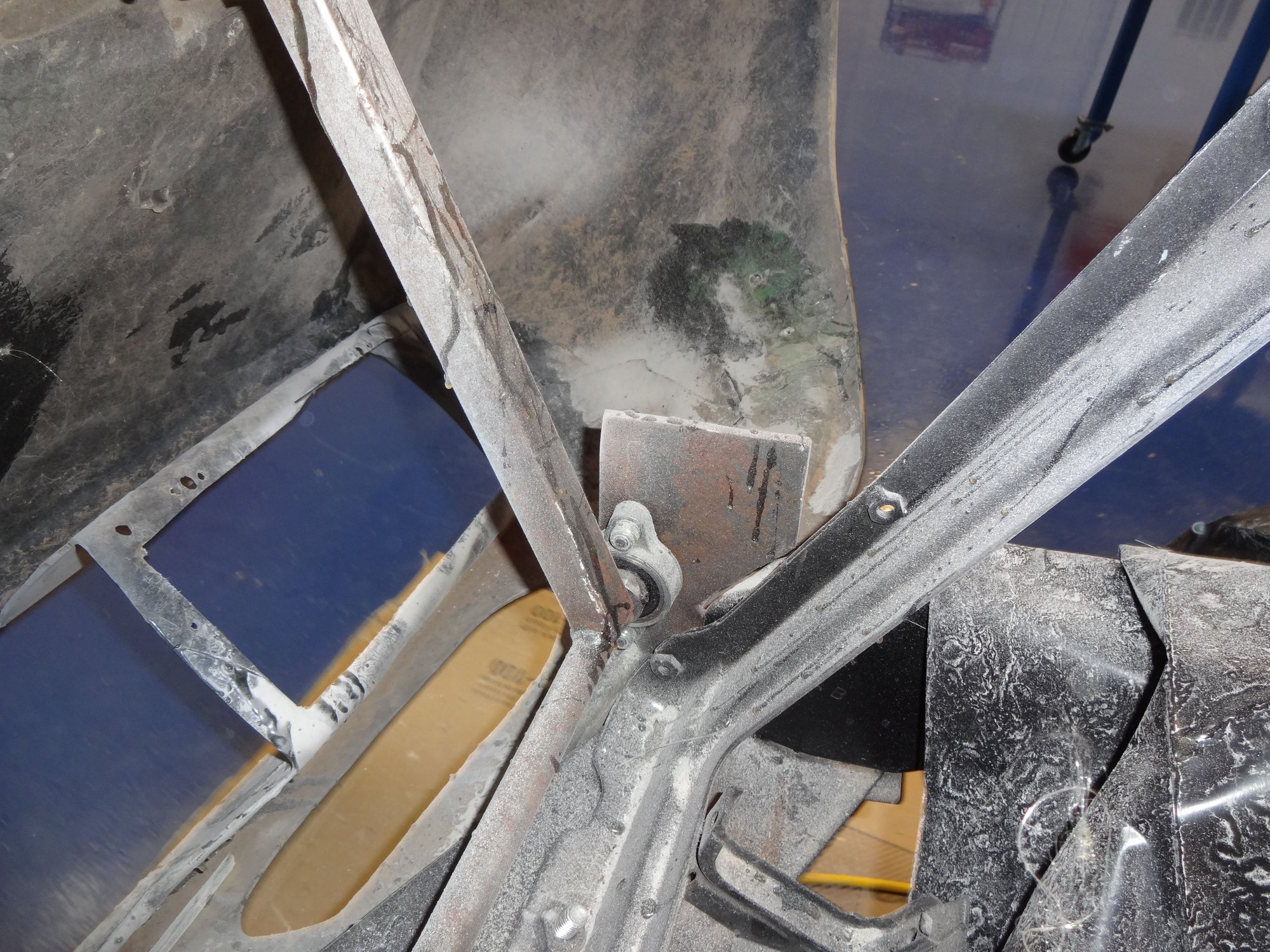

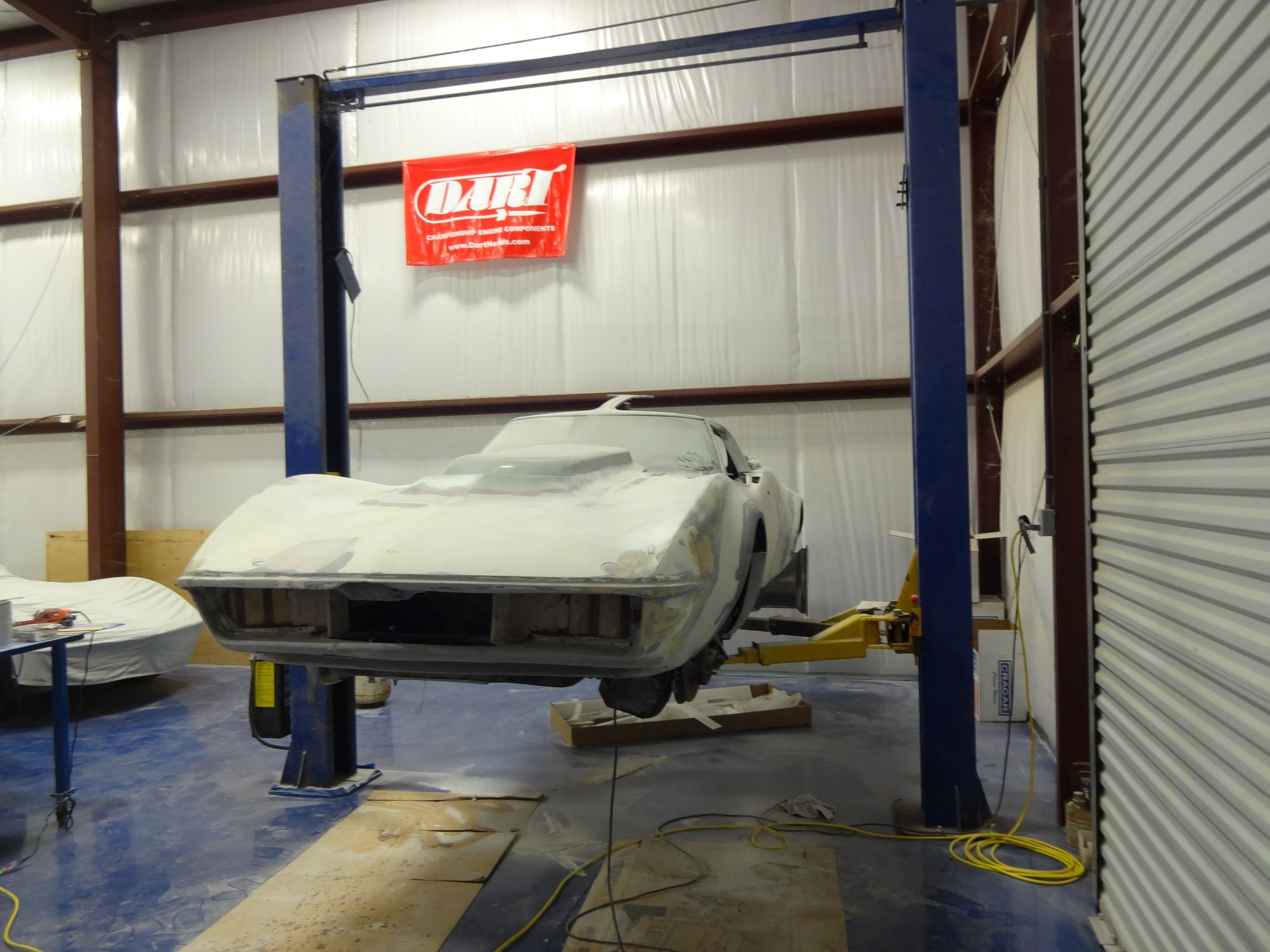

Still needs cleaning up and powder coat. I have 2 12 volt actuators that raise and lower it. I used 2 3/4 bore bearings and a 3/4 solid shaft for my pivot point. The actuators are at a 10* angle.

I can remove 4 nuts and the front end will come off. I'm not a body guy, but I want to do this entire car myself...well with help from my wife. I'm an engine builder so that part isn't a problem, but this body work is a lot of work. LOL!

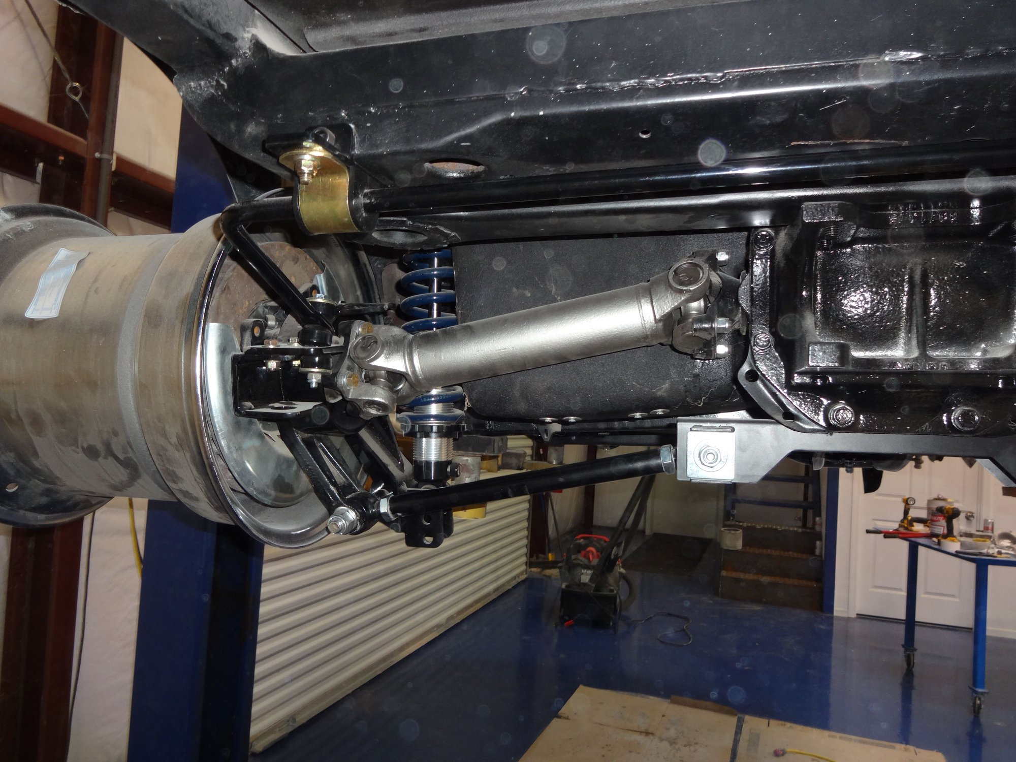

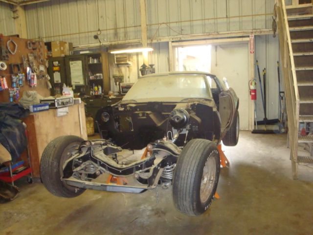

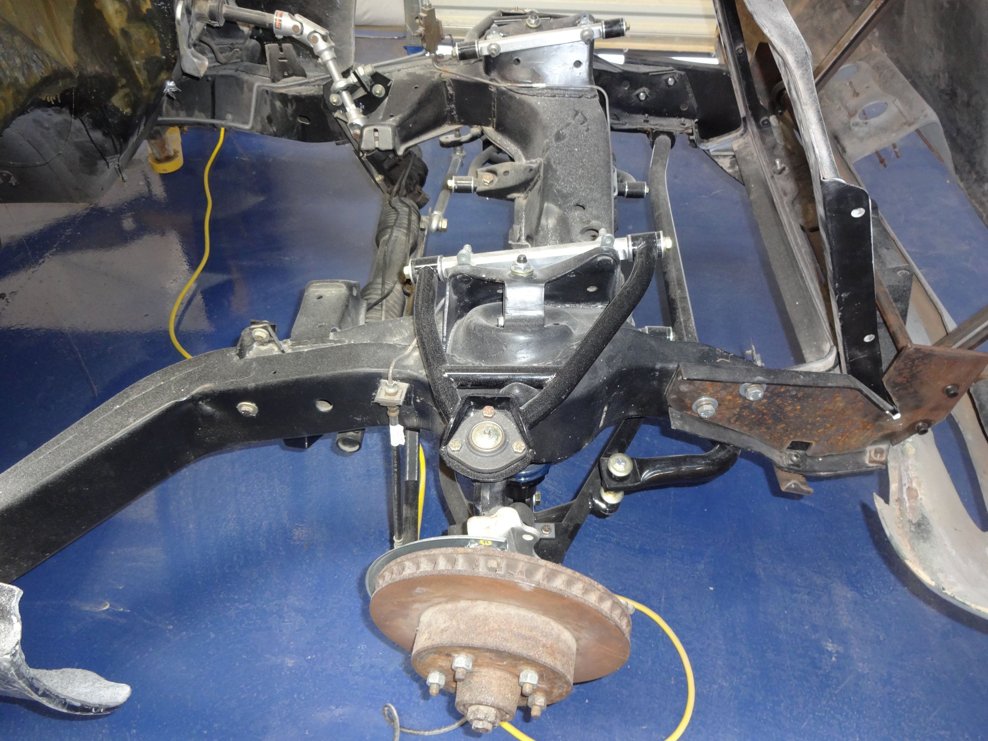

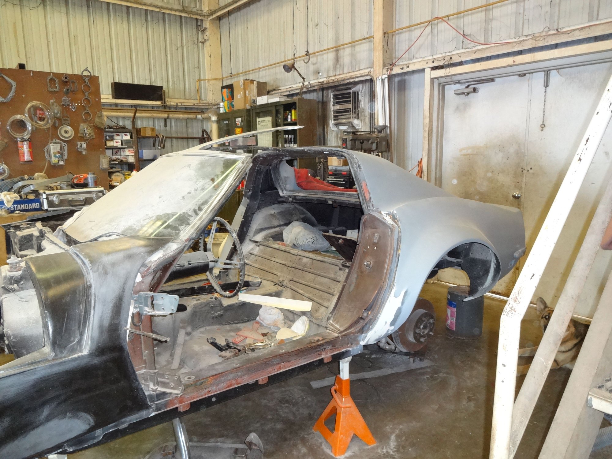

Van Steel offset trailing arms.
Van Steel upper and lower A-arms.

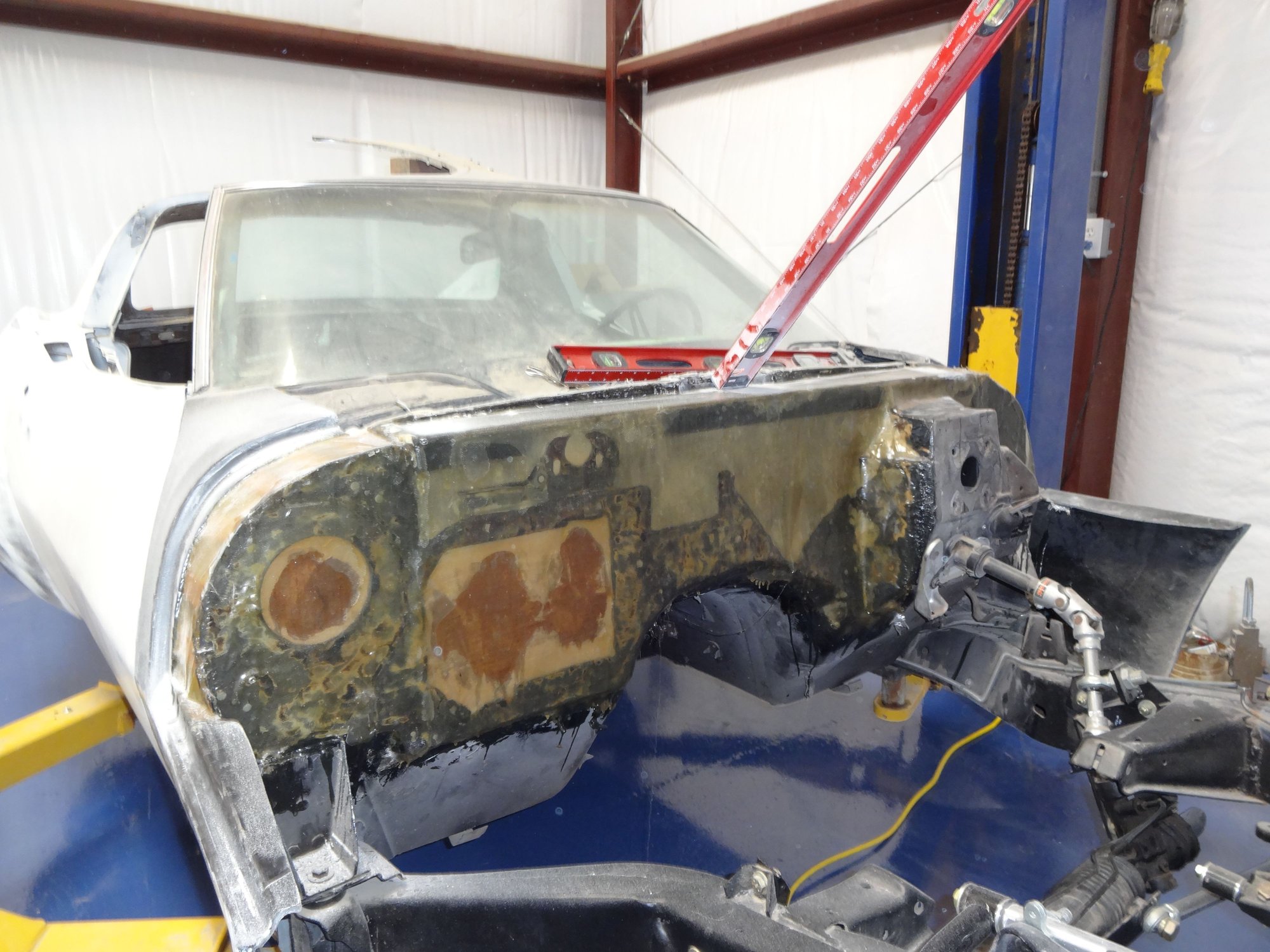

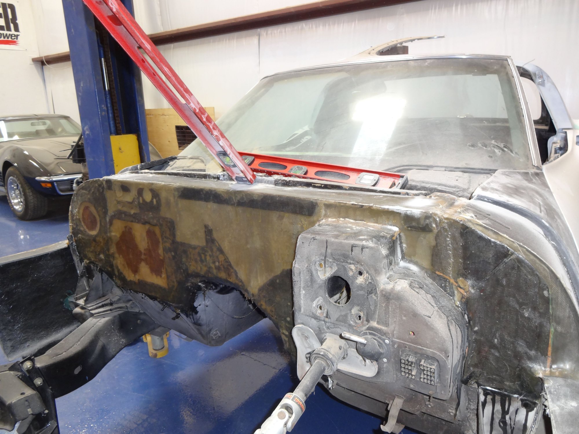

Smoothing the firewall.

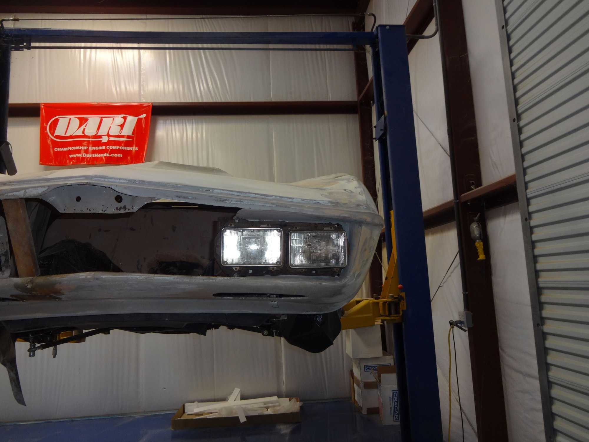

Head lights from a '84 Nissan pickup.

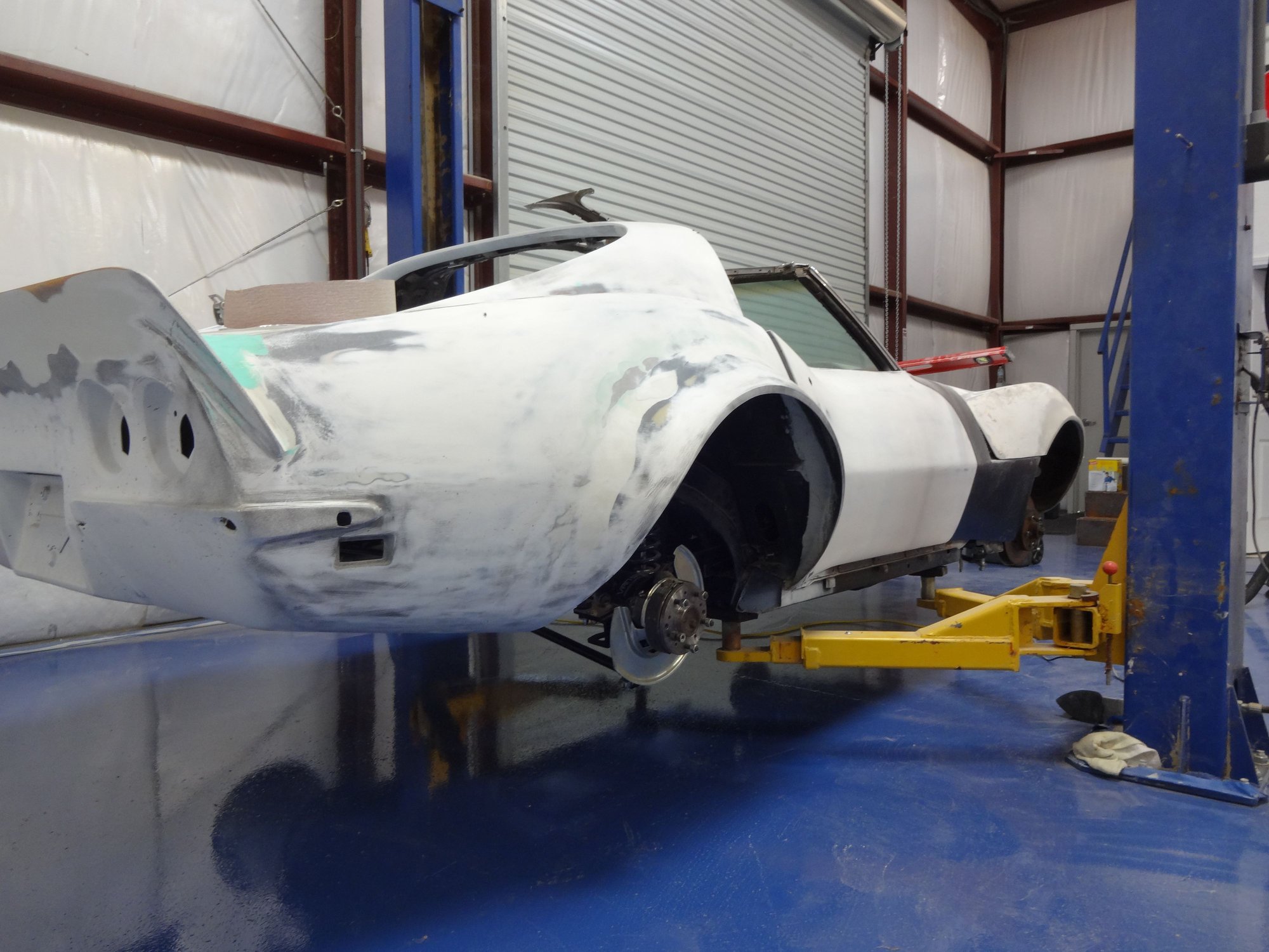

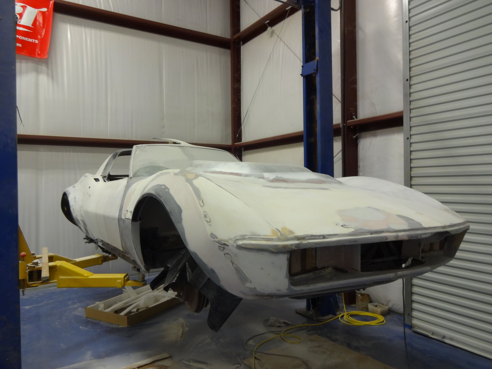

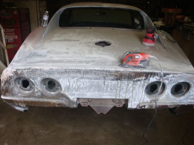

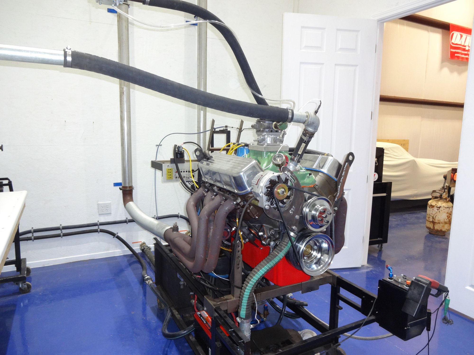

Update pictures. I'm not a body man....but I'm trying!
632 BBC.
Engine's I can do.....body work is a different story!

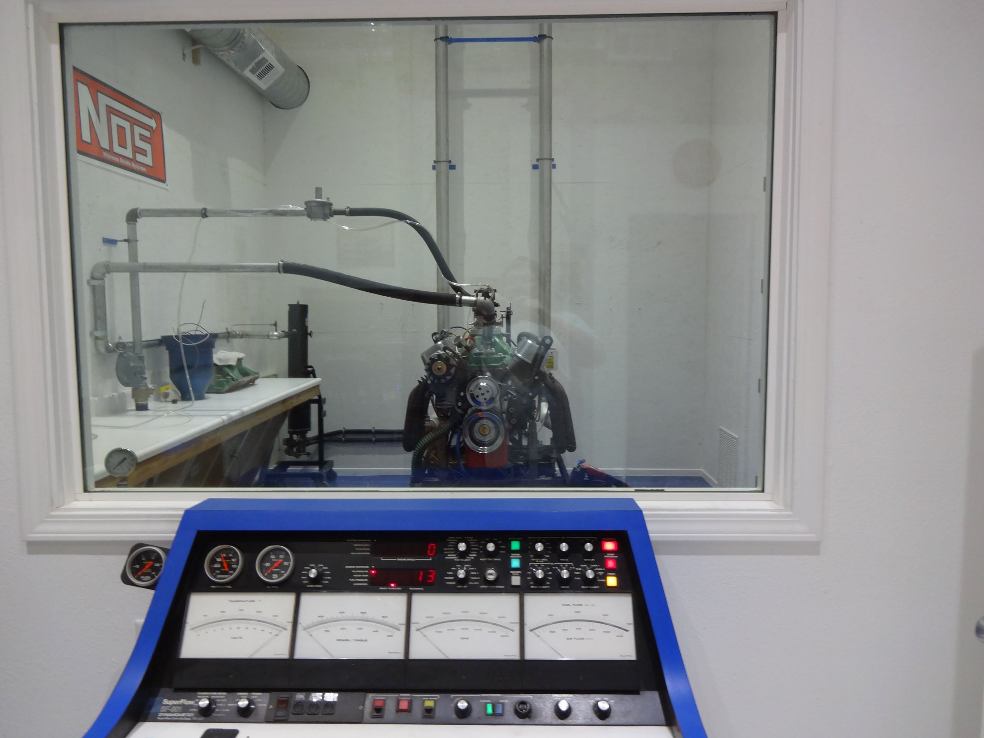

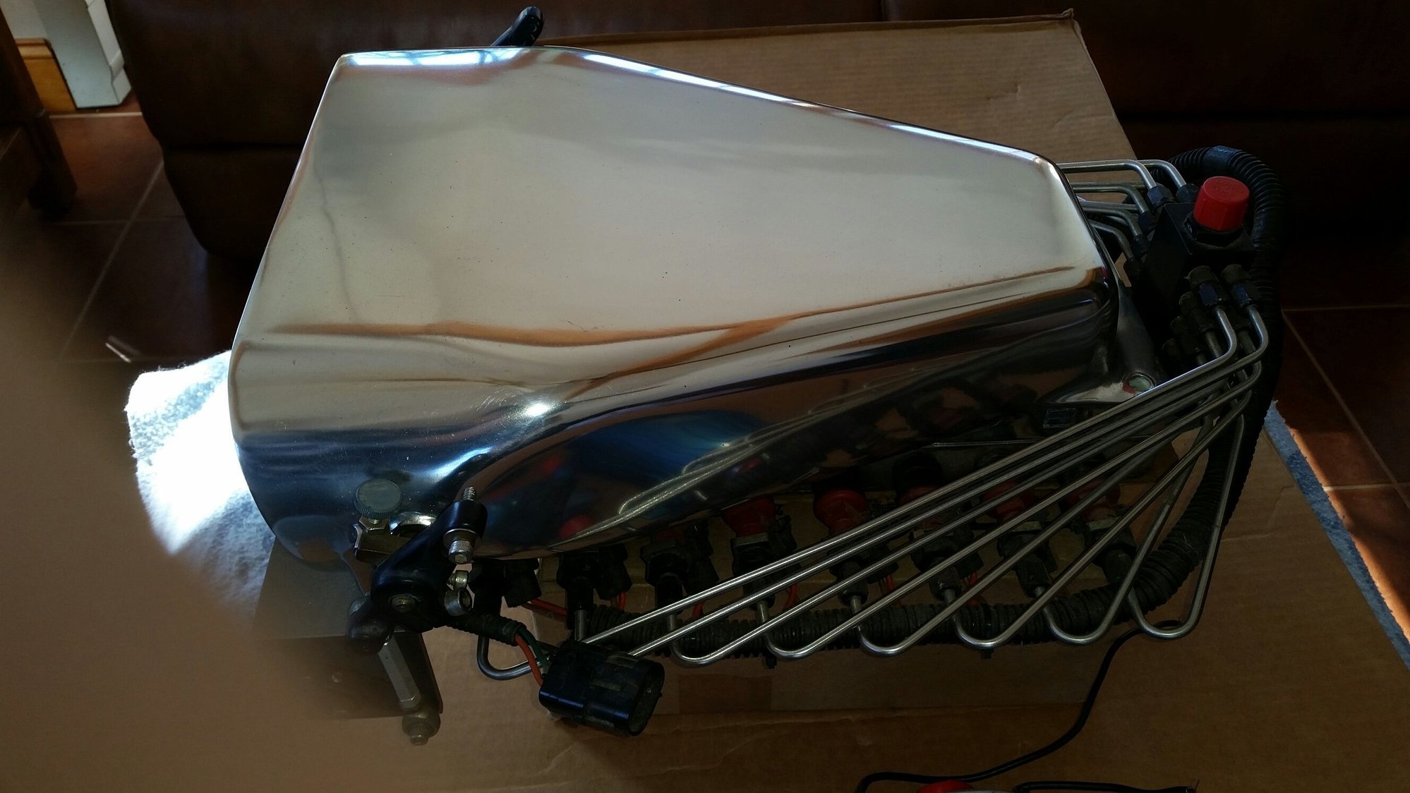

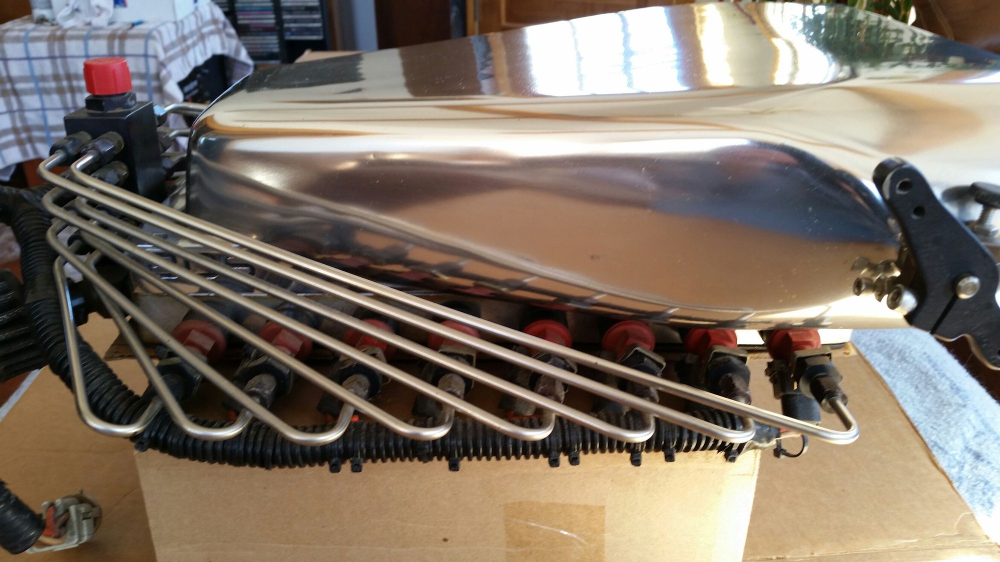

Still doing body work but thought I'd post a couple pictures of the injection setup.

Looking for 1200hp. Starting with a Dart block 4.500 bore and 4.250 stroke so 540" with a Littlefield blower. Going to run Brodix heads. It will have A/C and power windows.....I plan on driving it. Thanks again for the interest....I'll post more pictures.

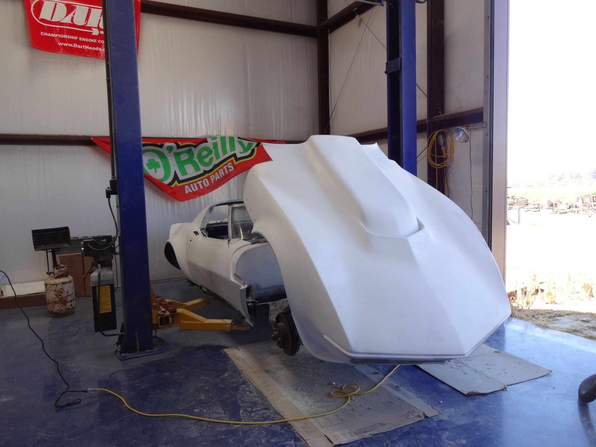

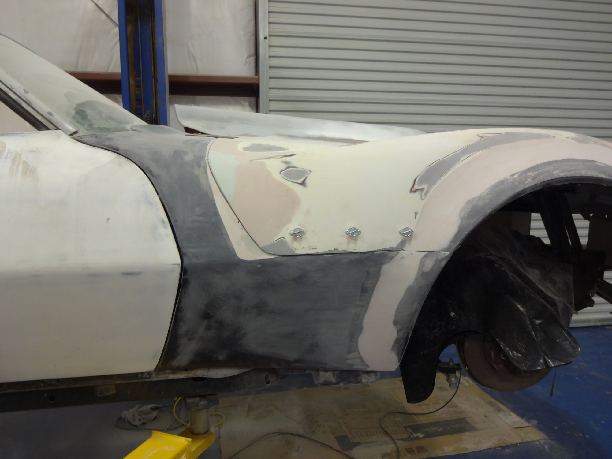

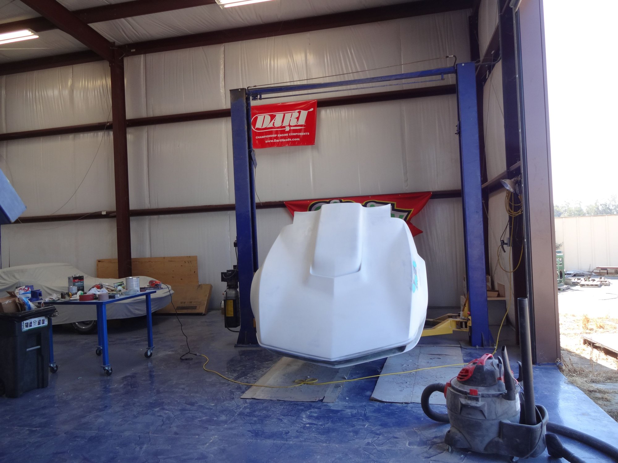

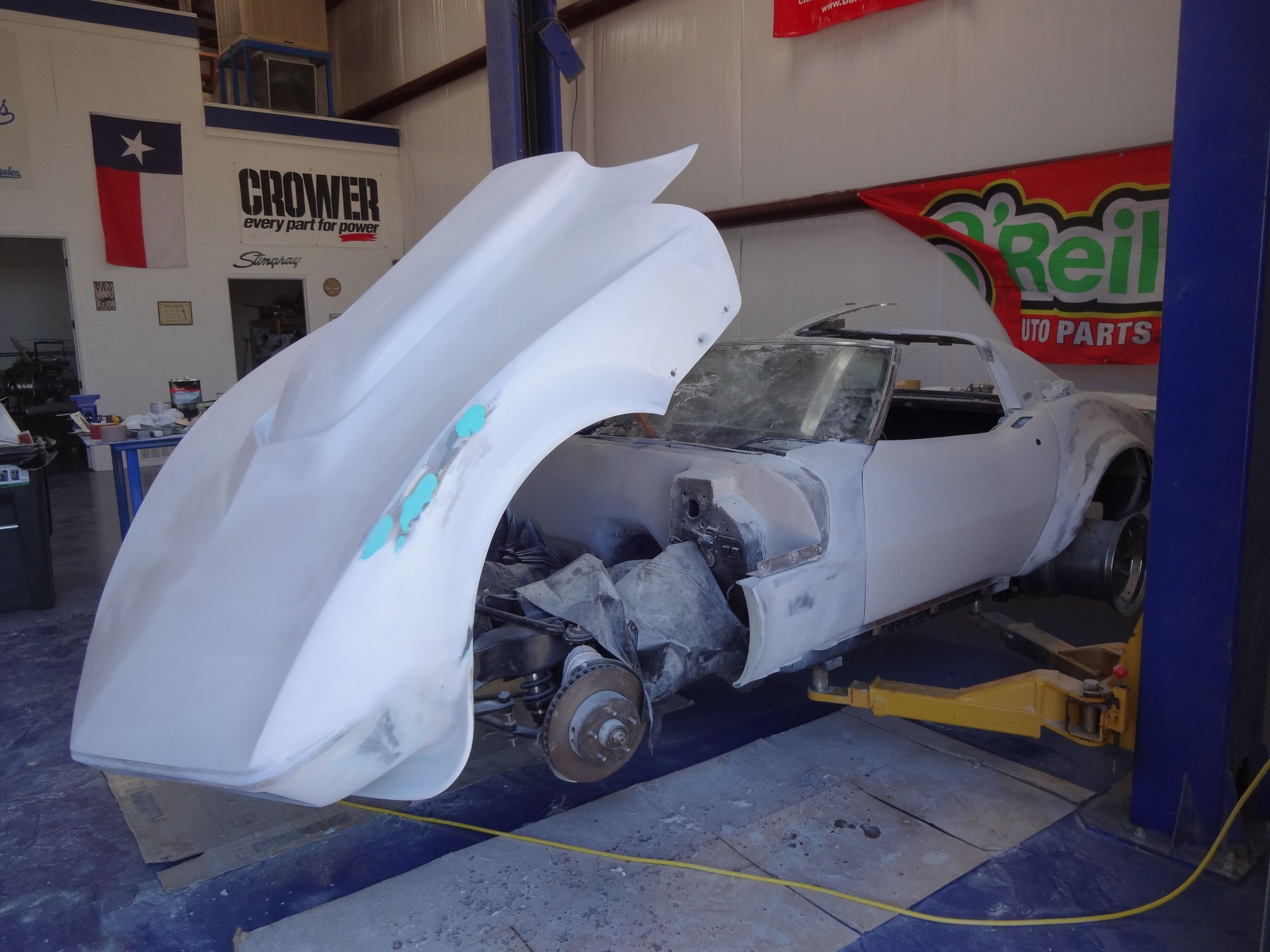

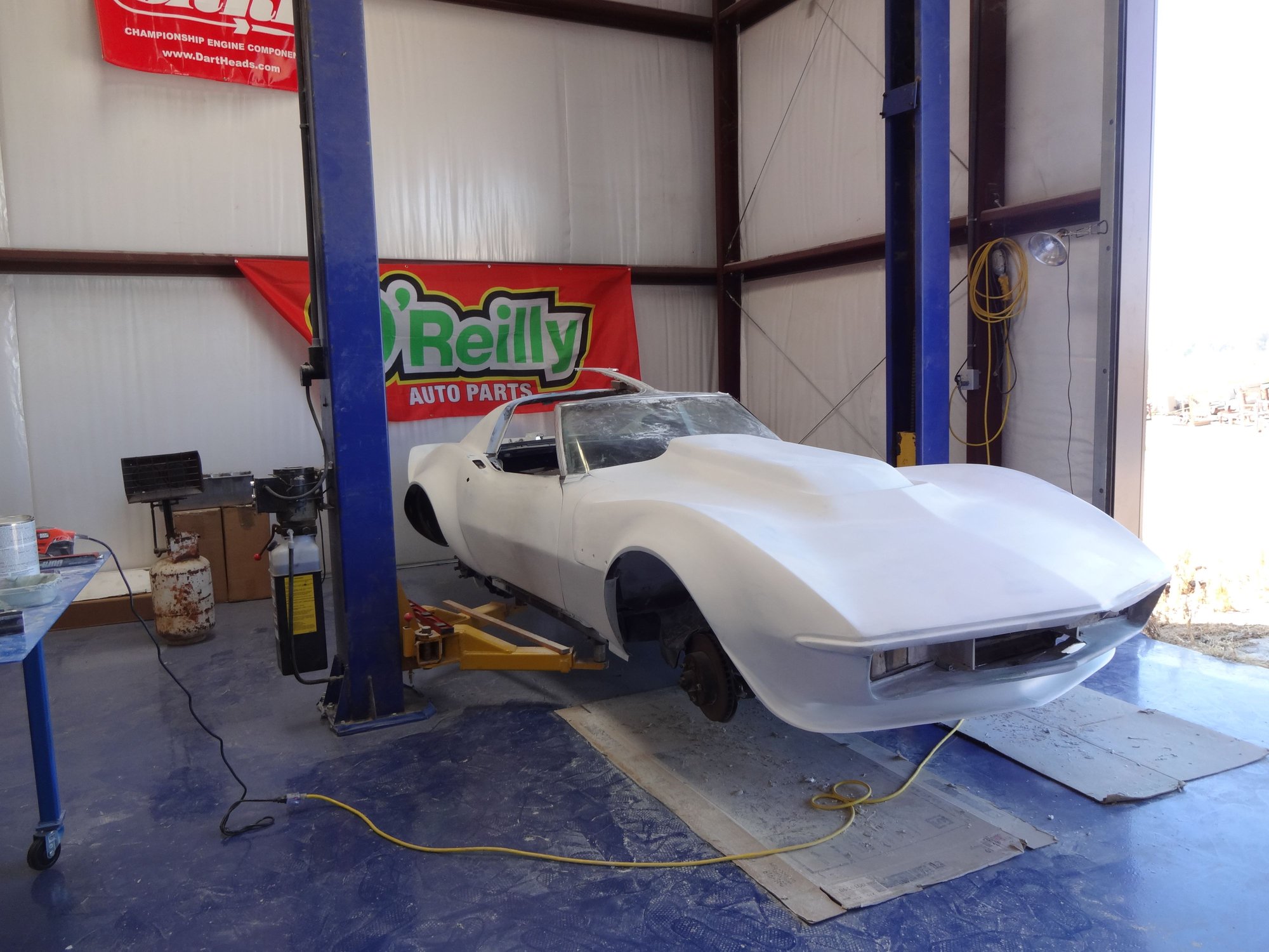

Not sure who made the front end but I extended it to cover the windshield wiper door.
Josh at Custom Imagine Corvette's made the front spoiler. I had to modify it a little to fit the flares.
The front will tilt with 2 12 volt electric actuators. It's held down with 3 butterfly spring loaded dzus buttons on each side..
