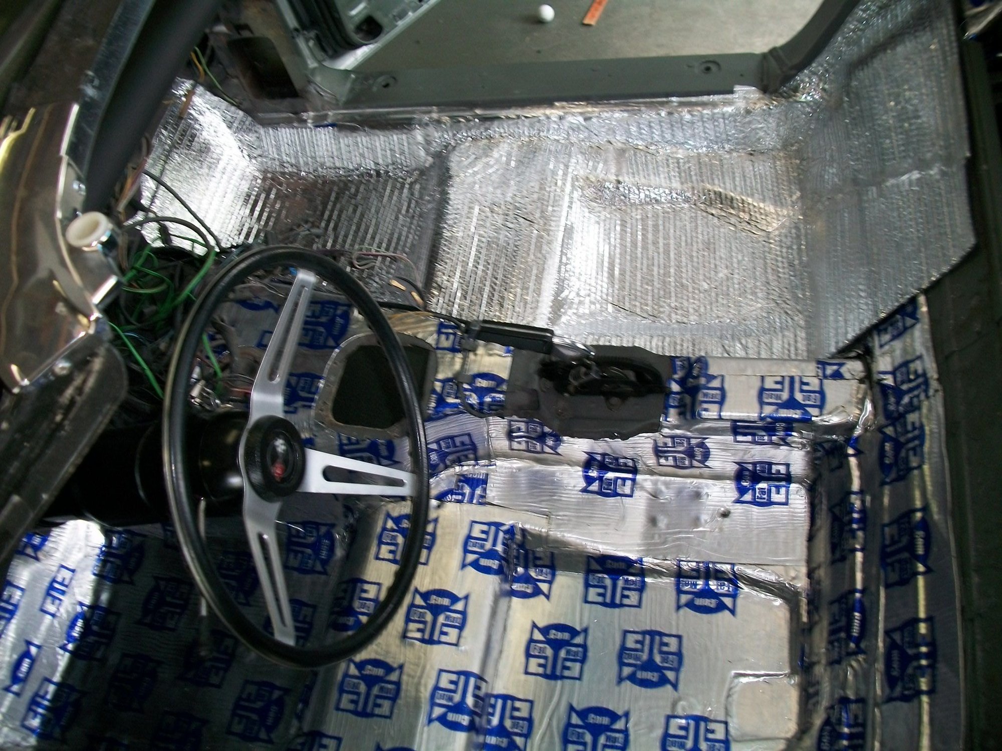

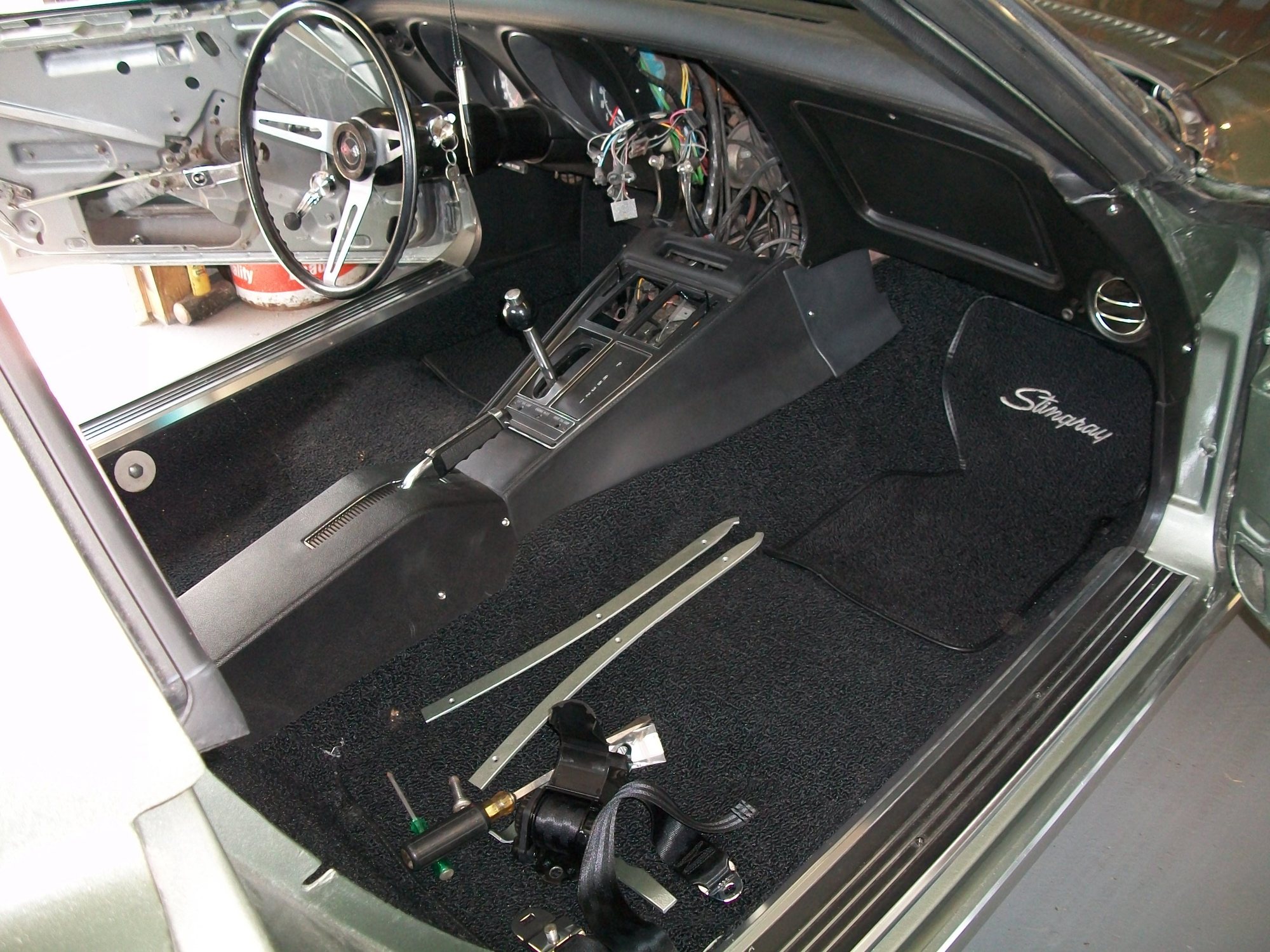

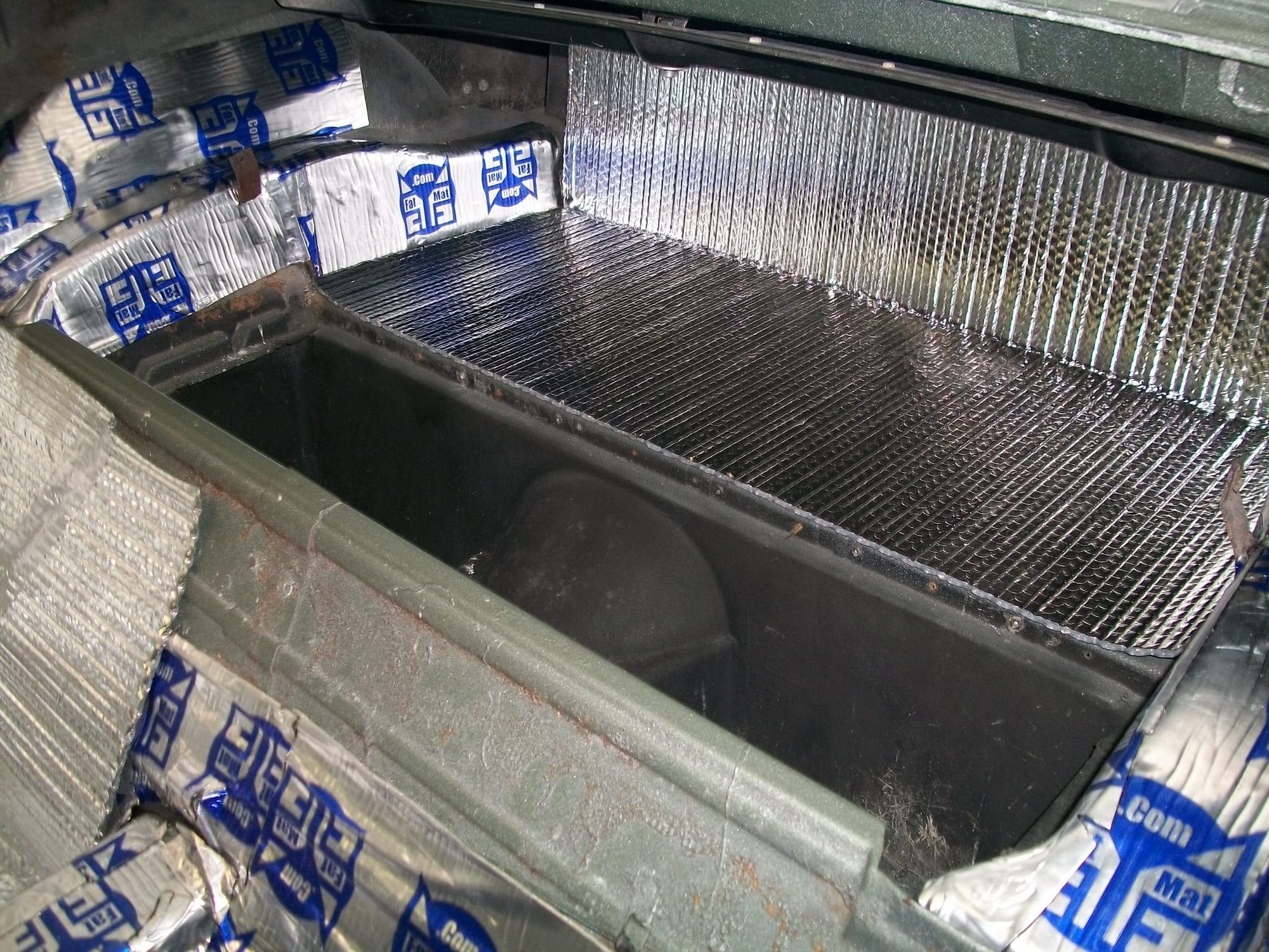

I did "FatMat", with Reflectix on top of that. The crinkly sound does go away after carpet is installed. The carpet fit perfect right over it, but I had to cut some of the jute padding off the back in a couple spots... specifically the "footman" loops for the t-top straps in the back.... and the dimmer switch.

Thanks; beautiful interior. I'm getting there slowly
