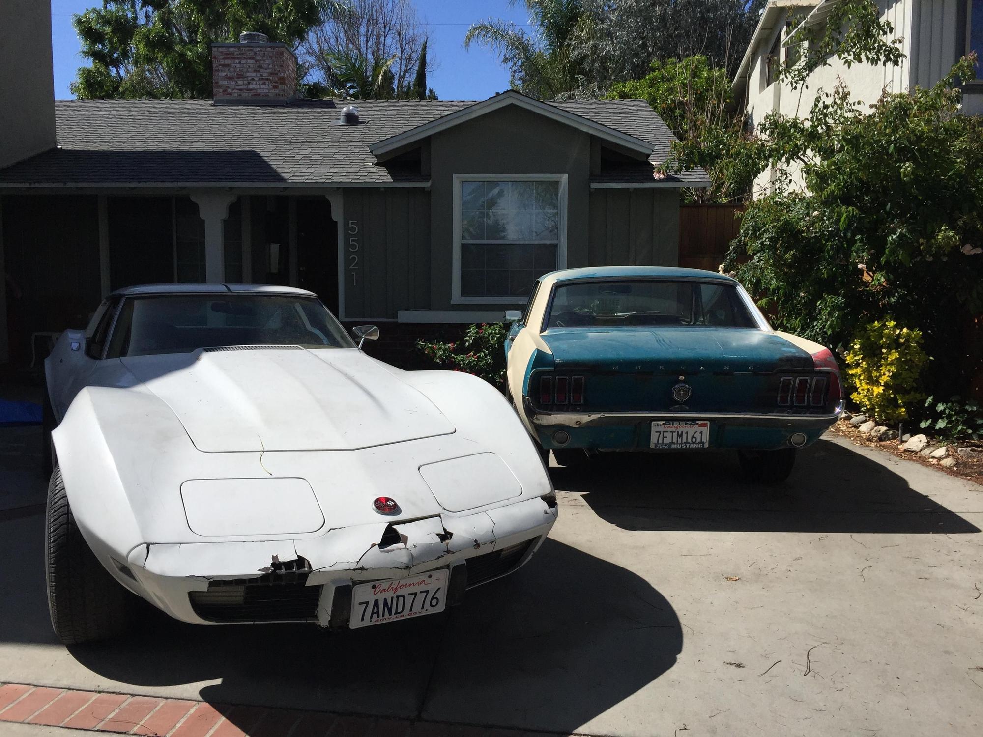

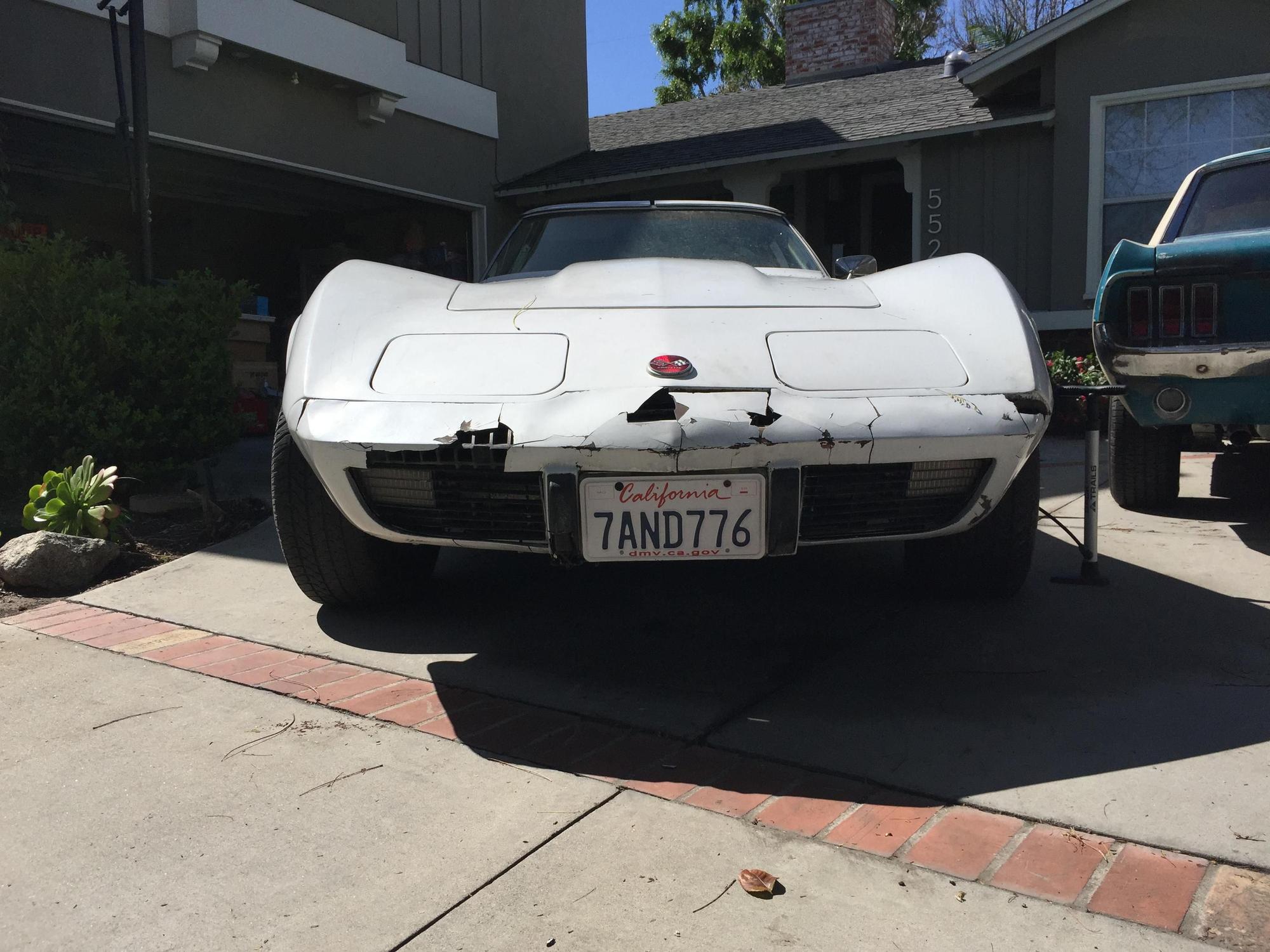

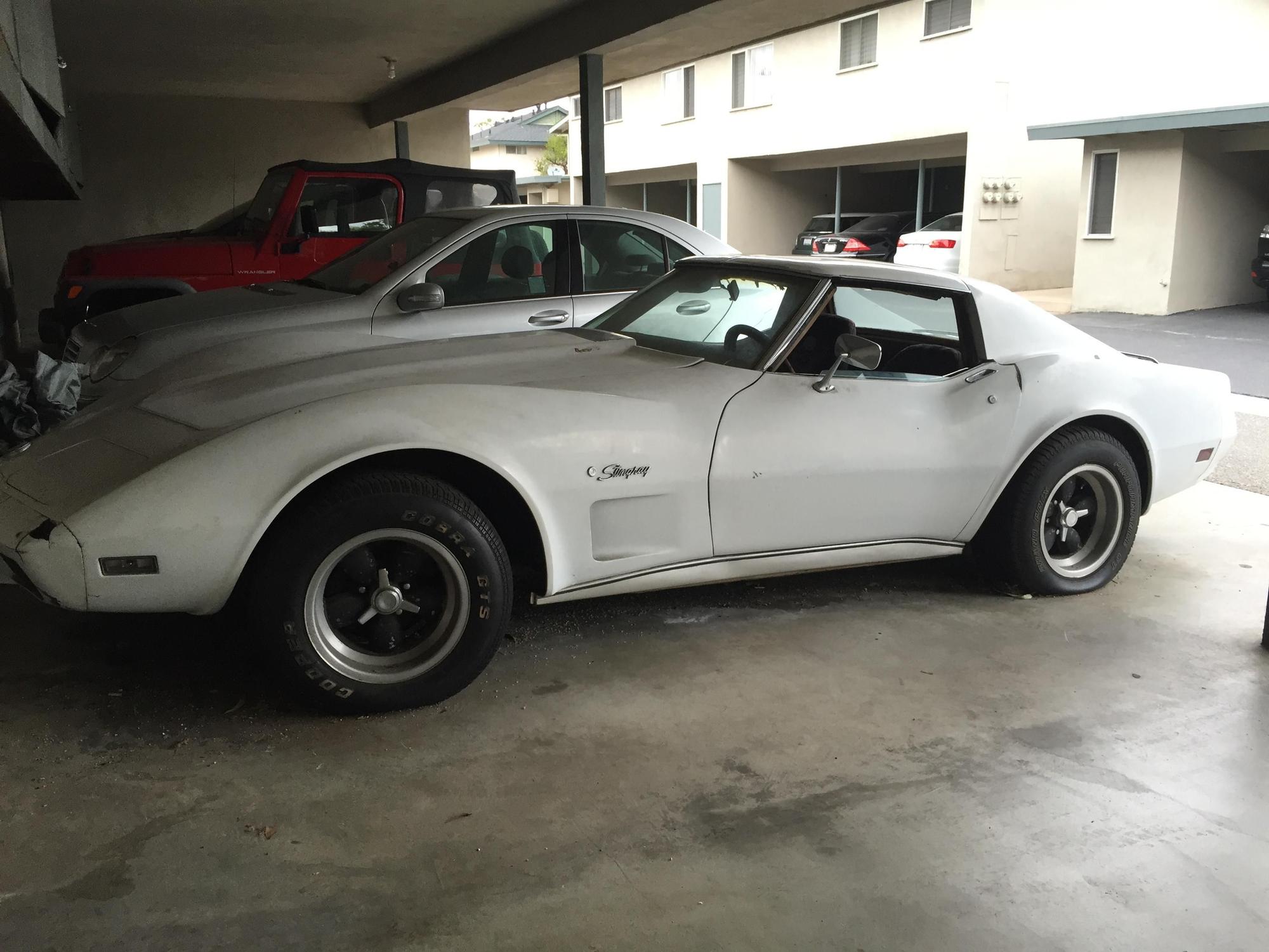

Hello! I recently had the opportunity to purchase a rust free '75 Corvette T-top car with a 350ci and 4 speed automatic for $800. My baby is a 1967 Mustang (sorry?) but this was an opportunity I couldn't say no to. The car is extremely solid and complete with 59,000 original miles, but hasn't run in 3 years. The previous owner was over his midlife crisis and had lost his license, which is why I got it for the price I did.
Some backstory. I bought my '67 Mustang in June of 2014 as my first car and I've completed an engine and drivetrain swap, added disc brakes, rebuilt the suspension, learned to weld, done all of the metalwork, and I'm in the process of doing the bodywork. It's a slow process but she'll get there.
Unfortunately, my savings and budget compared to the cost of completion are not equal, and I know I may make some enemies saying this, but the plan with the Corvette is to get her running and sell her as quickly as possible while still doing the job right.

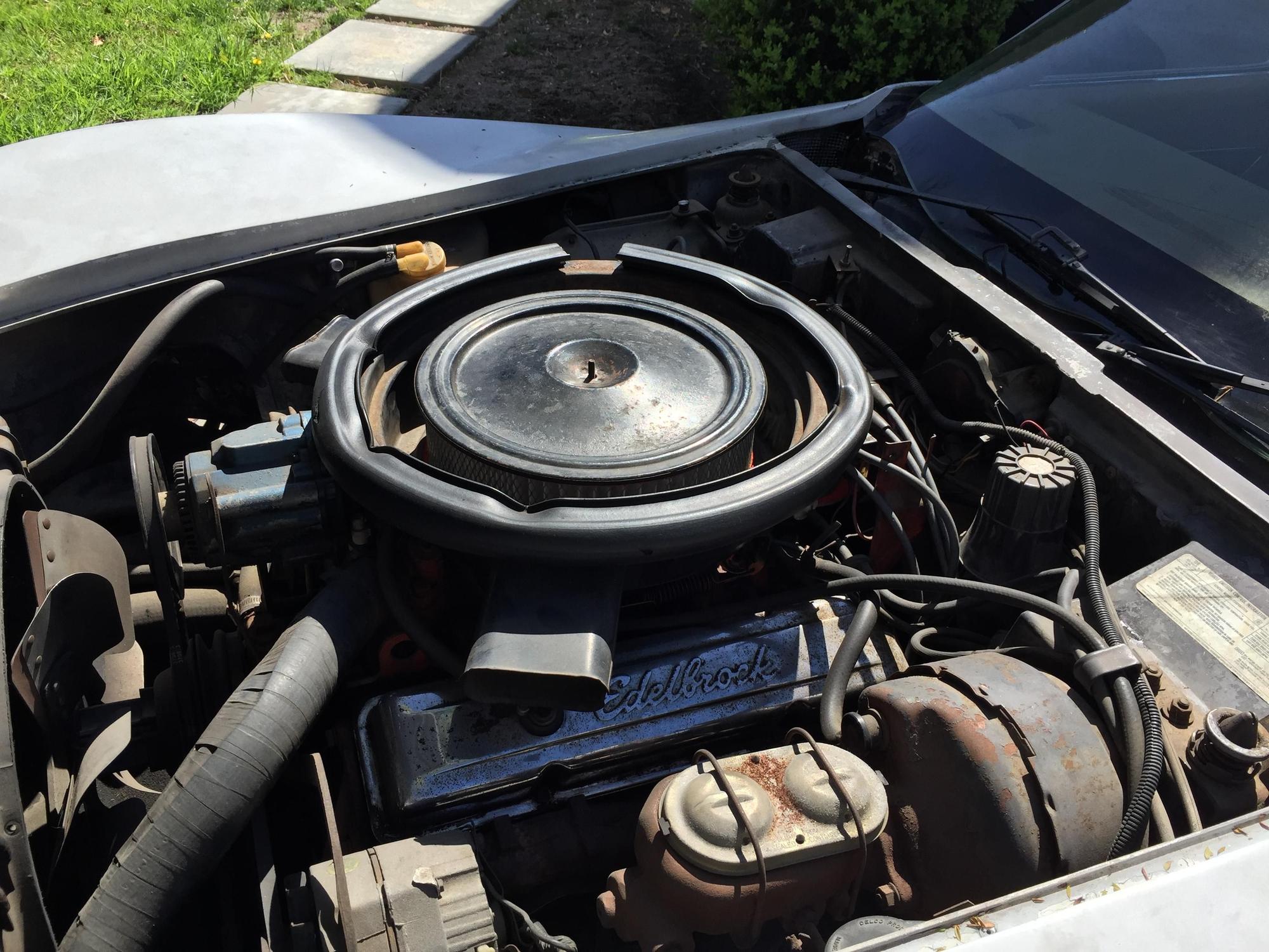

What I'm thinking of doing is changing all of the fluids, making sure the gas tank is clean, and buying several fuel filters to run before the carburetor to make sure it's not horribly gunked up before actually trying to start her. Before selling the car, I'm going to find a set of used front tires (the current set are bald and cracked but the back is okay), replacing the bumper cover, and replacing the seals in the T-tops so it doesn't leak. I want the next owner to hit the ground running.
Here's the issue. I have a pretty decent knowledge of old motors without SMOG equipment but this '75 is really throwing me for a loop and I'm not sure if the steps I'm planning on taking are the correct ones. And that, little man, is why I come to you fine folks.
Any advice regarding my plan of attack would be superb! Here are some pics of her.

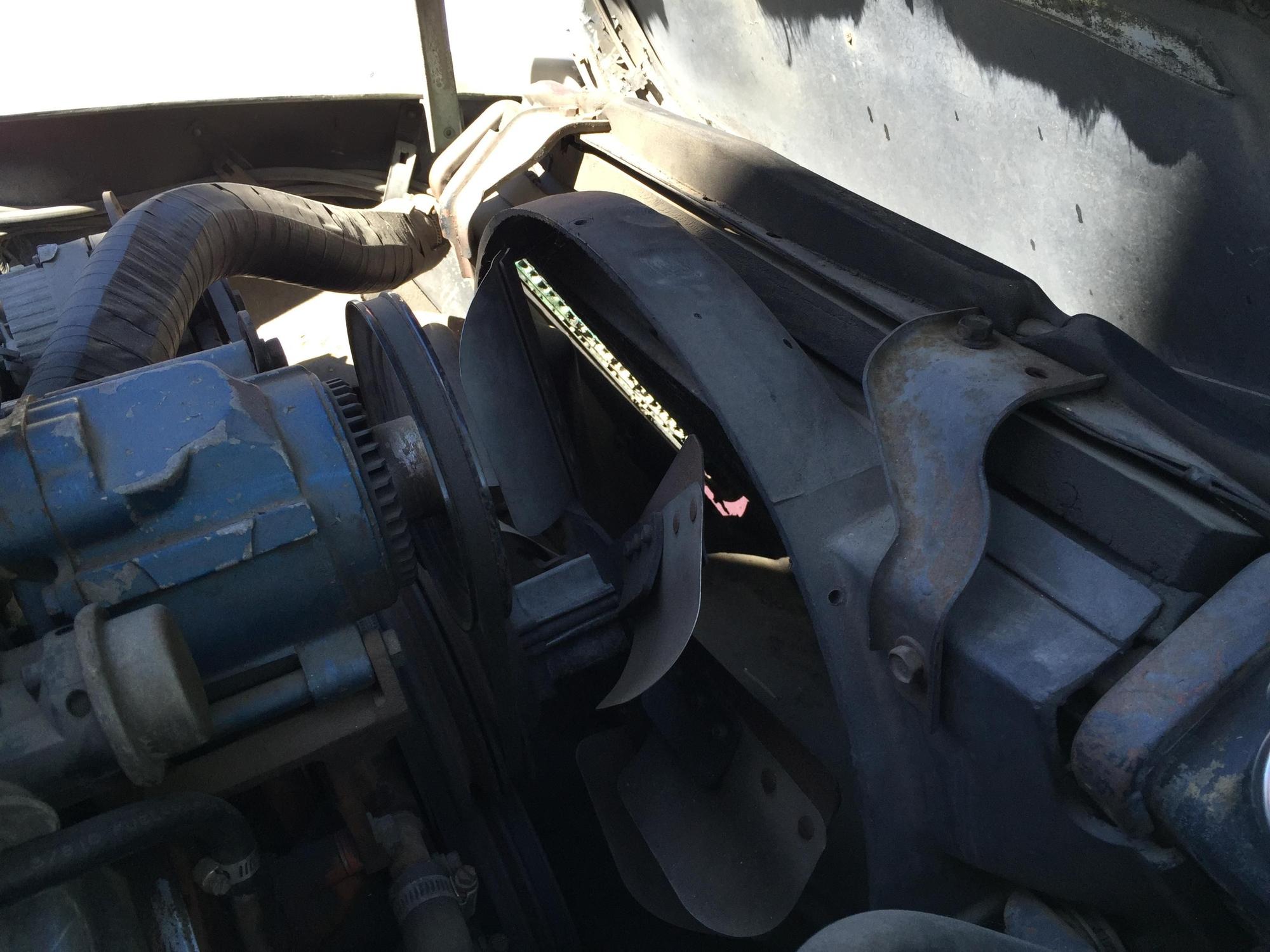

Rookie suggestion: Go for it....stick with your repair list........the car could use a new dedicated owner to rebuild/restore it.
Is part of the shroud missing around the mechanical fan? If so, the engine will run hot.

Not to my knowledge. There's definitely a shroud there and it's not cut. Now, is it the right shroud? I couldn't tell you. I'll take some pictures tomorrow when it's light out.
The emission system looks to be complete but I'm expected some vacuum issues from the old rubber hoses and that's where it gets complicated. She does have a clean title at least.
I'm actually having trouble pinpointing the location of the fuel filter...

The radiator shroud should be part number 339175, which should be at the top driver's side of the shroud. My guess from the picture is that you are missing the shroud extension, part number 331870. They run from $100 for repros to $150 for originals. I've actually got a few originals laying around.
The fuel filter should be built into the carb where the fuel line connects if you still have a Rochester Quadrajet carb.

As it's a 75 and in California, should be smog exempt. Disconnect any rotten vacation lines and plug at the source. Save all the stuff in case the future owner wants it. This'll help with getting it running better. For what you've doing, don't worry about the emission system now.
What's up with the upper radiator hose? Looks like it is wrapped up in electrical tape. Maybe new hoses to prevent an "oops" while trying to sell it.

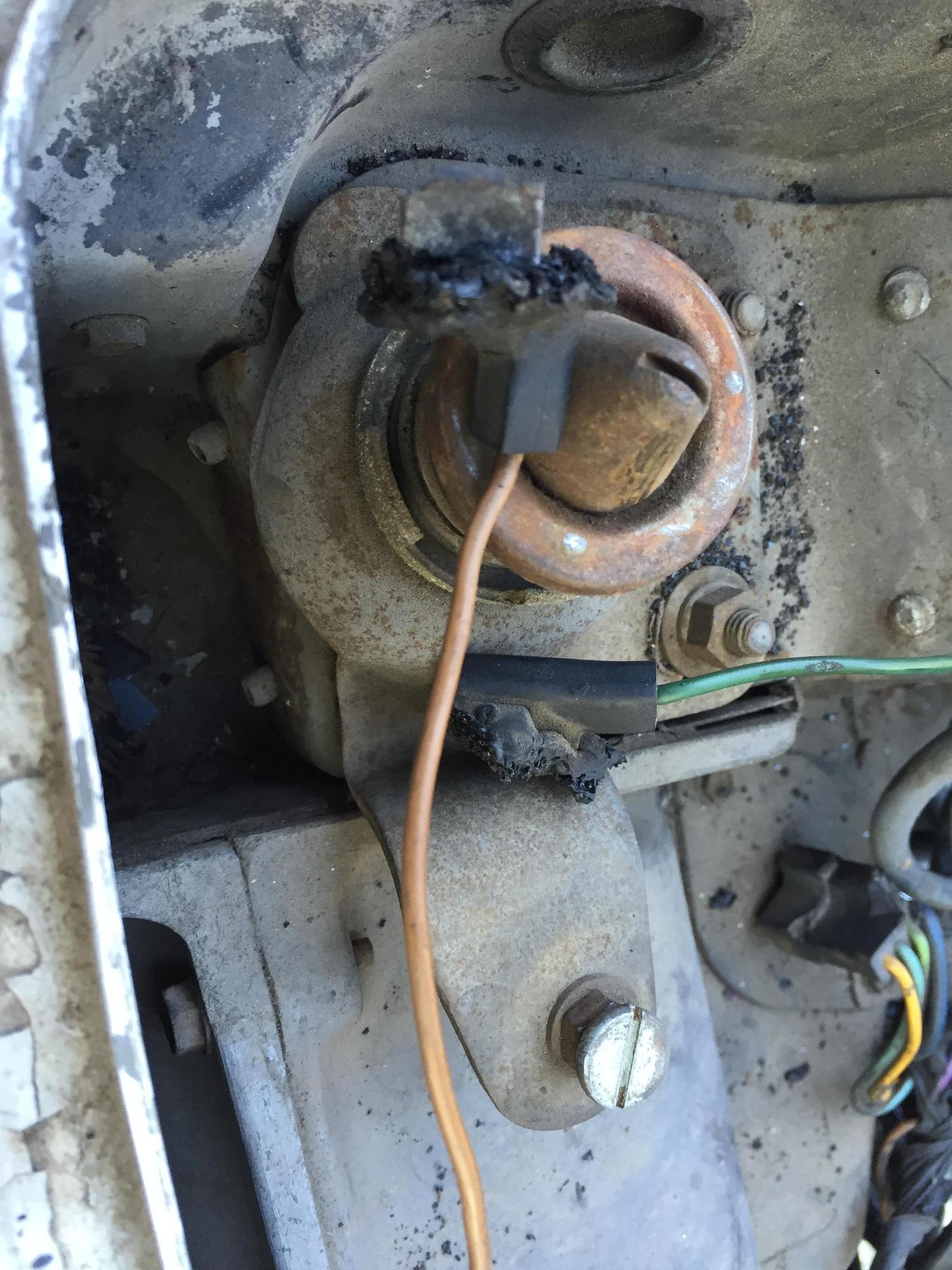

I broke out the magnifying glass and did some more detective work. These two wires, orange and green, appear to have melted. I'm not a Corvette expert but I don't think that's up to factory specifications.

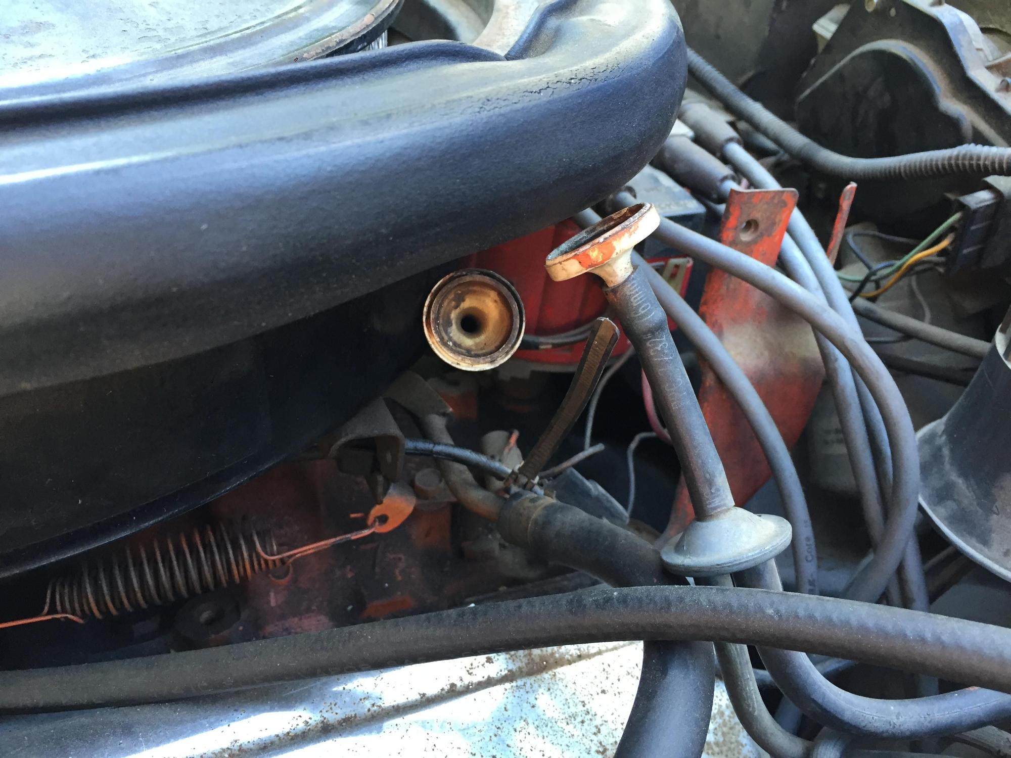

And then this... thing? I honestly don't know what it is. But it's split in half and it appears to go together. I'll see what I can uncover in the shop manual but it's not easy when I don't know the part name.
I'd say you're right. Part number 339175 is indeed intact and there's something missing. I'll add that to the list of things to track down.
And it's got the Rochester Quadrajet. The filter is probably located in the front where it says filter...

The white thing thats on the 2 hoses that split and looks like 2 funnels was a filter for your vacuum system

The white plastic piece that is broken is a Vacuum filter, see below.
