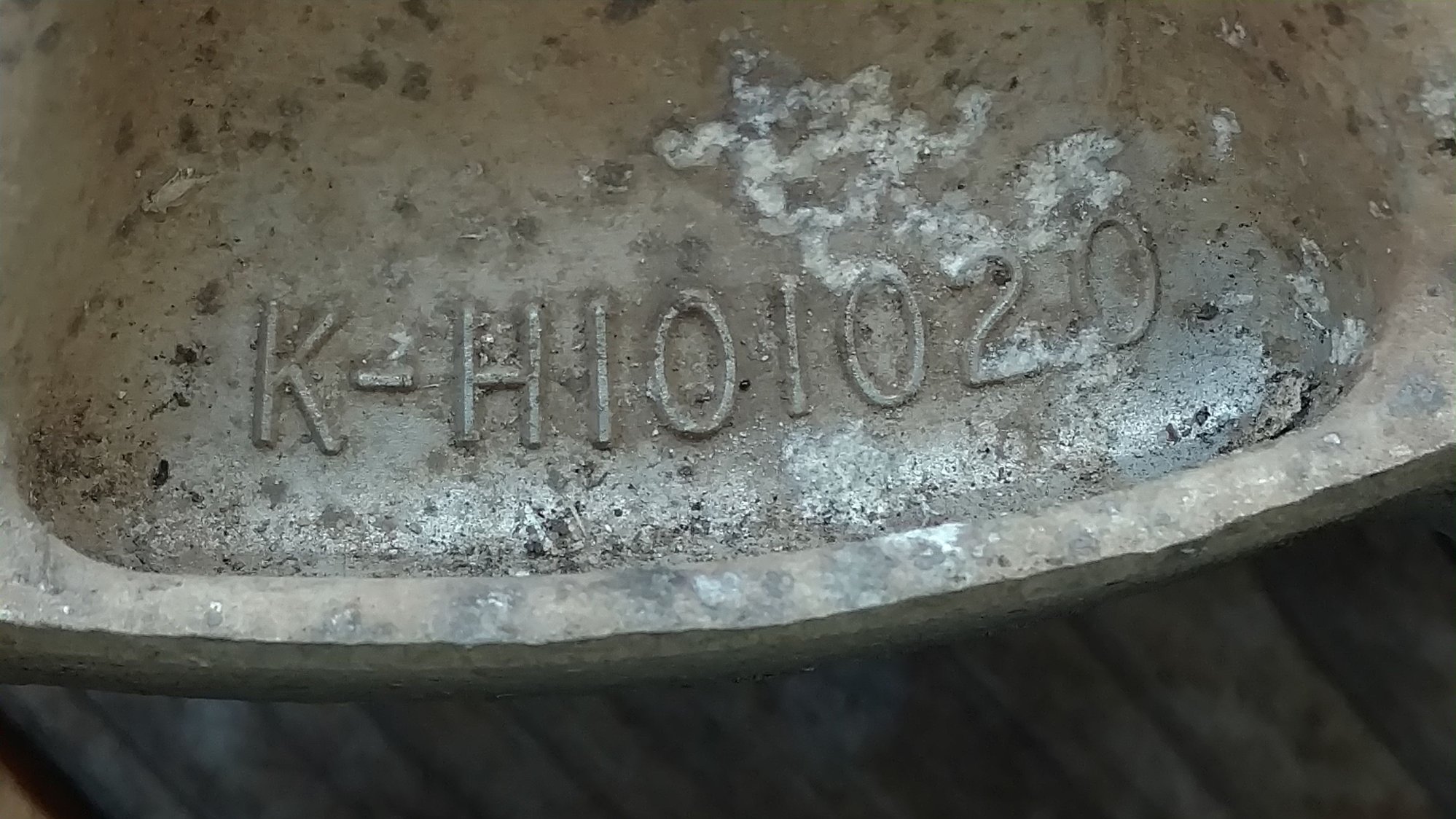

Got lucky and found some local that was parting a 79 C3 with several parts I needed for my 79 project car. Among the parts were some original Kelsey Hayes Aluminum Wheels. They are in very good condition with just one minor spot where there is a small curb scrub. Of course they have some oxidation and need a good cleaning. My question is what is the best method to clean and polish these to get them back to looking new. I know modern wheels have a clear coat on them but I don't believe they did that back in the 70's. Here a couple pics of what they look like. From what I can see of the stamping on them, they are a matched set, but I haven't cleaned them at all to verify all markings match.

I believe they were clear coated, at least my '77s were. The clear coat yellowed so I stripped them. Hit them with some billet aluminum mag polish and repainted the centers. Those look like they may need a bit more aggressive treatment though to bring them back. The problem is trying to restore or retain that original "machined" finish. Those will probably require a good scrubbing with emery cloth and steel wool. You'll end up with a more polished finish but they'll still look great

I'm thinking about trying Mother's aluminum mag wheel cleaner and see how that does. Will test on the back first to make sure it doesn't harm the finish, but I'm thinking it would work.

I bought a used set like yours a few years back $200 all 4. Looked similar too.
1. I wet sanded the wheels with real light grit wet dry 1500 paper until clean & smooth.
2. Then used a cordless drill with a polish wheel pad & compound rouge then white compound. This took all day but well worth it, wheels look terrific
almost chrome now.

That's what I used on the wheels off a 76 that I purchased for my `73 - - inside barrels and face-repainted the black and final polish with Semi-Chrome and a ball buffer. . .probably 4-5 hours per wheel.
