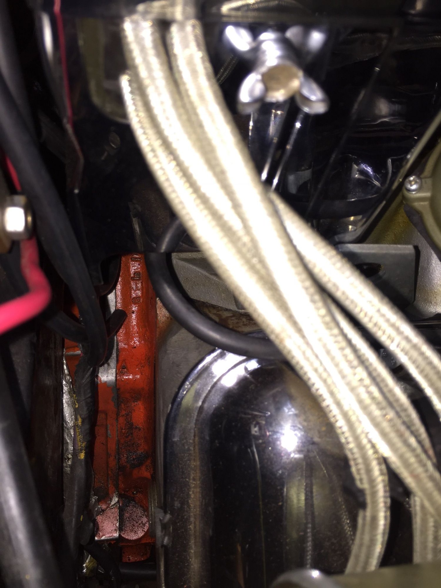

I have looked at a 69 L89 coupe for sale that at first appeared to be numbers matching until I looked at the block which is a 3963512. The car was assembled in October 68 as vin number 194379S705903. From my research, I understand that block was not used in Corvettes until late in the model year, which would indicate it is a replacement block which has been restamped with the original numbers. Can someone more familiar with this situation either confirm or deny this possibility? If it is a restamp, but all the rest of the engine components are correct, how much of a hit in value would it be? Current owner is asking $46,000. Front clip has been replaced and does not fit great. Rear end is from a 1970. BTW, I did not see the block casting date. I know they were produced starting in 68, but I don't think they would be correct for an early production 69. Any thoughts? Also, owner has no documentation.

Ok, Stan, here is another bit of info - the block casting date appears to be I 4 8 or I 4 9, Sep 4 1968 or Sep 4 1969. What do you think? See below.

It "looks" like I 4 9.
Let me back up a moment. It is possible to see 3963512 blocks in October of 1968 so it isn't a stretch that some of those blocks might have September 1968 dates. So far so good, but here's the problem...
If this car was built in October of 1968, the block would have to be built and assembled before the build date of the car. Assume for a moment that we are misreading the date code and it is actually an "8" for the year... Works OK, but a couple of problems. First, I don't recall seeing a "4" cast into a block that looked like that. Second, blocks this early usually had the date code cast into the passenger side of the cylinder case, not the bellhousing flange as the later (around January 1969) castings are. I am not sure whether this casting orientation occurred on 512 blocks as it did with the 439 and 270 blocks... I just don't remember (I've made some calls). In any case, if that is a "4," I'd be digging for more information.
If the last digit is a "9" then the casting date is off almost a year after the car was built (plus the issue with the "4"), so the answer there is pretty clear.
Forgive me if I missed it, but did you post a photo of the stamp pad for this engine? I don't recall seeing it. In any case, a photo or two of the pad would certainly be helpful.

Ok, here is the stamp pad. Still trying to determine if it is a restamp or not. The pad has obviously been abused somehow. Intentional or not is the question. The vin derivative looks identical on the pad and the trans. First characters are deeper and more pronounced than serial numbers in both places.

Hello Stan,
I have a 512 block in my 69 coupe that was built in Feb 69. The block was cast Jan 28, 1969 and the date is cast on the passenger side of the block. So that L89 would have an unusual location for that cast date. However, my engine is a 390hp so I don't know if that makes a difference.
And the 4 does look odd. They are usually closed on top but I don't know all the fonts they might have used.

Look like I 4 9 to me

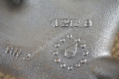

Here is a date code from a exhaust manifold. I only show it to demonstrate the 'open' 4 style of font. Apparently they did use this type during that time period.
Ed,
Good information. Might be brain fade, but I don't recall style of "4."
Assuming the "4" is correct, it appears to be I 4 9... Located on the bellhousing of a 3963512 block. For September 4, 1969, the 3963512 casting would probably be the only casting number being used for a 427 and puts the block casting date in the location it should be.
Now the problem comes when you get to the pad.
The pad surface is obviously damaged... The dual disc clutch may not have been available... The block casting and assembly dates are after the car was built (by almost a year)... There are some other pad issues that might be in play as well.
If the date actually is I 4 8, then you run into the question of the orientation of the date... Why isn't it on the side of the block?
Throw in the fact that there is no documentation on top of all of that.
If it is a neat old car and the purchase price wasn't/isn't too high, a lot of what we are looking at really isn't critical... Just drive it and enjoy it. If, on the other hand, you're looking at a high dollar car billed to be the "real deal," then you may want to look at other options.
Do you own this car or are you looking at it as a potential purchase?
