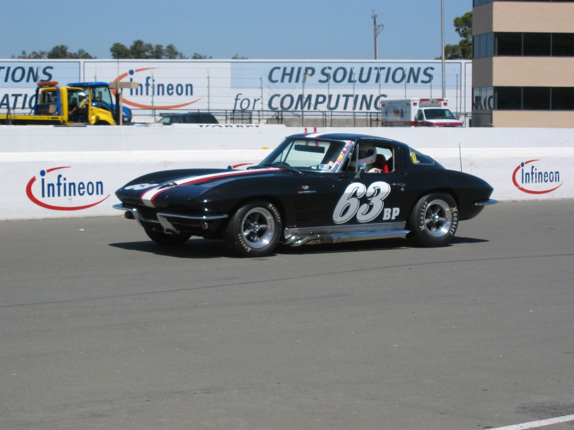

I love the American 200S wheels (the "daisy" wheels). I had them on my 62 for many years. From what I remember, I think as many or more, road racers used the 200S wheels in the late 60's and 70's, then used the Torque Thrusts.
The 200S was quite common in the Trans-Am from 67-72. The factory teams all ran Minilites, but many of the privateers and lower buck teams, ran the 200s wheels. A lot of guys racing A and B Production Corvettes in the early 70's, ran the 200S wheels too.
I had the chrome plated version on my 62, the 200CP, which is no longer made. Here's a picture of my 62, taken in the early 80's at Pocono Speedway. These were 15x7's, with GR70X15's (same as today's P225/70R15).

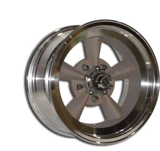

Originally Posted by statik
Are you committed to American Racing? Vintage wheel works makes a good wheel in the tt style.
http://www.vintagewheelworks.com/products/wheels/v40
This is a VERY nice looking wheel, I like them even better then my TTO's VN 309. Wish the would produce this wheel larger than 8 Inch x 15. I would like at least 8.5 or 9 Inch x 15 for the rear. But this wheel Looks great!
