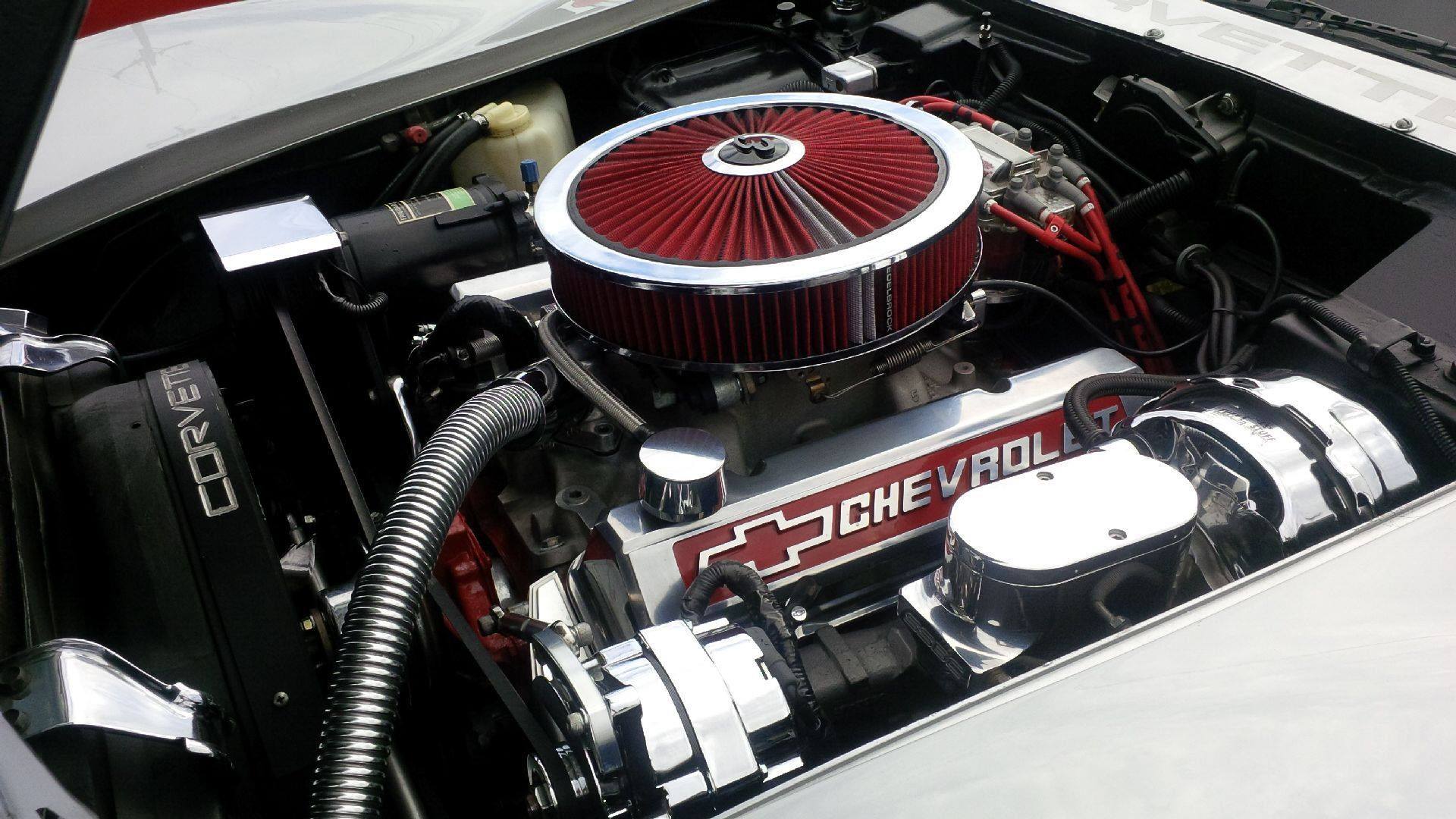

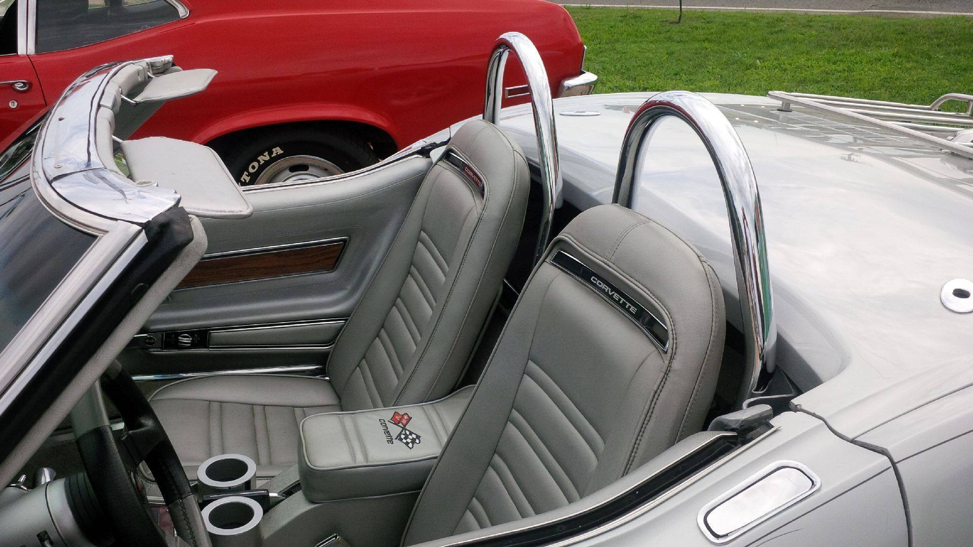

I've had mine going on 18 years! When I bought it, it was a nice, plain-jane Corvette Convertible and over the past 18 years, I've added the roll bars, the front spoiler, redid the interior, replaced the original engine (still have it on an engine stand in my garage), dressed out the new engine, and changed the wheels and tires, added the luggage rack. NEXT on the plan is for a new paint job. I drive mine everyday...even in the rain (but not in the snow/ice). Have fun with yours!! Love to see some pictures of yours....
