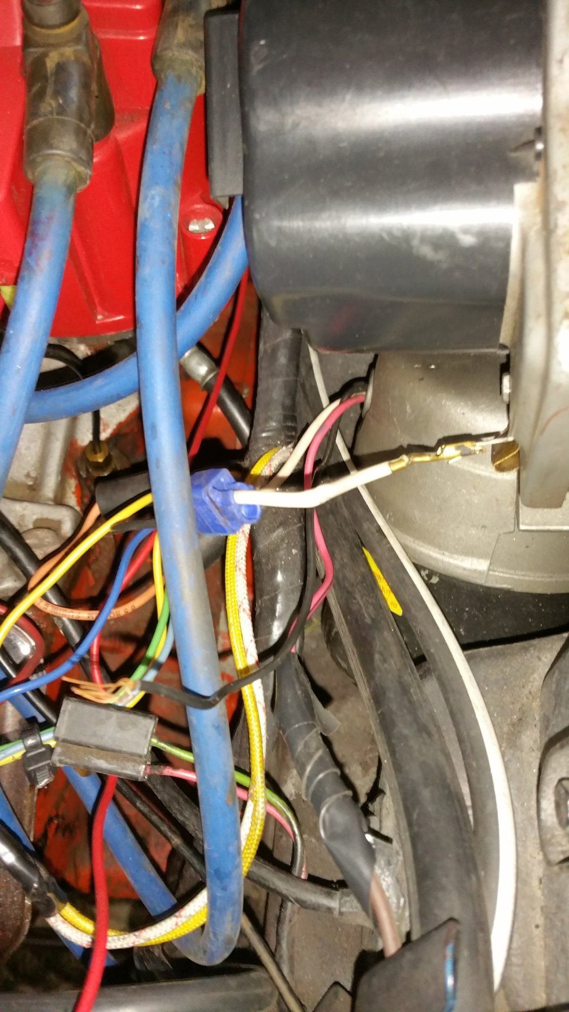

In addition to this i found the wiring to one of the lights had been repaired incorrectly. (the method of repair was fine, but it was now wired so it could't come on at all)

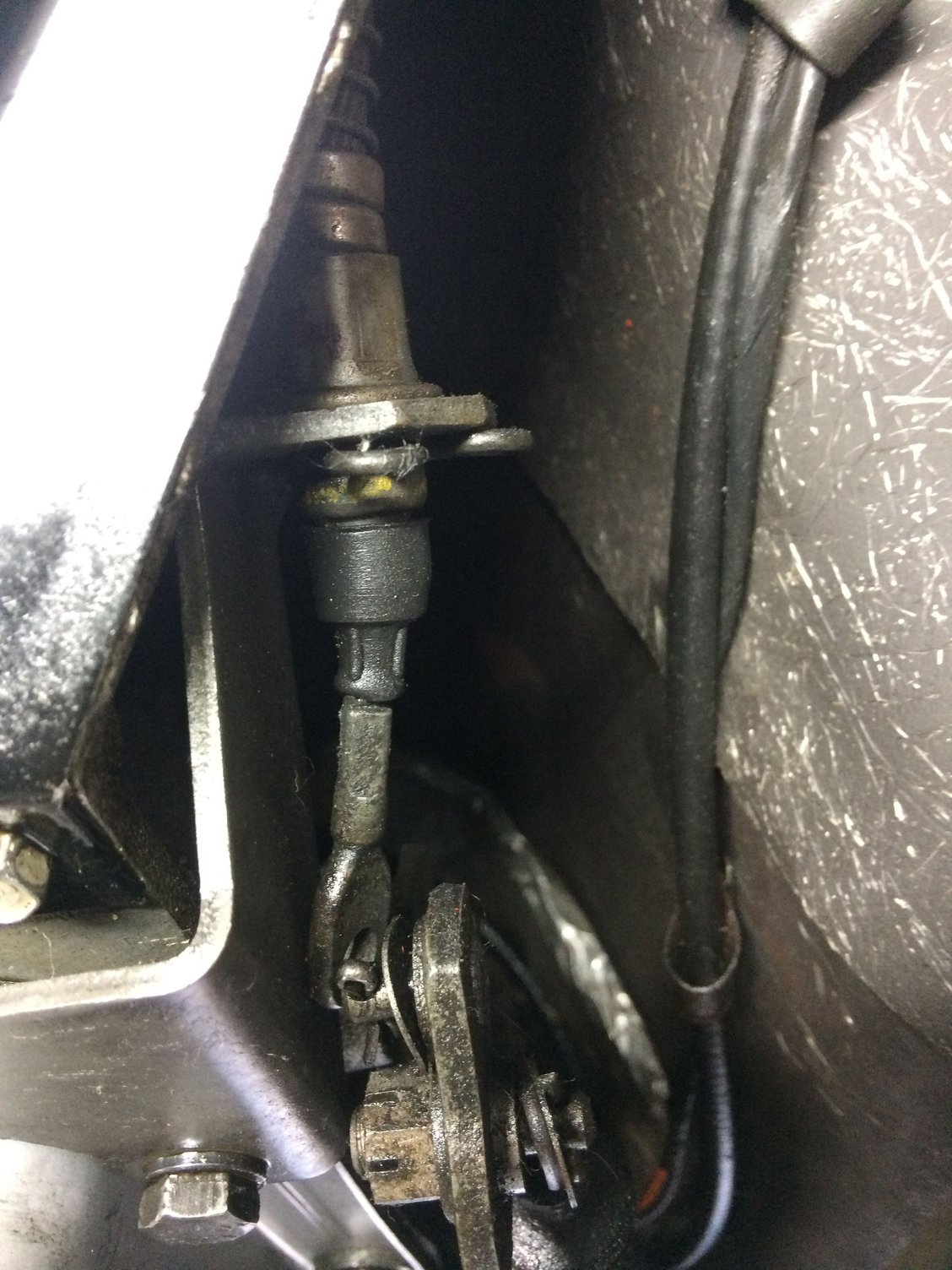

When the headers were installed the O2 sensor was removed and never replaced. The carb was then tuned so the car would run fine but none of the vacuum leaks were fixed.

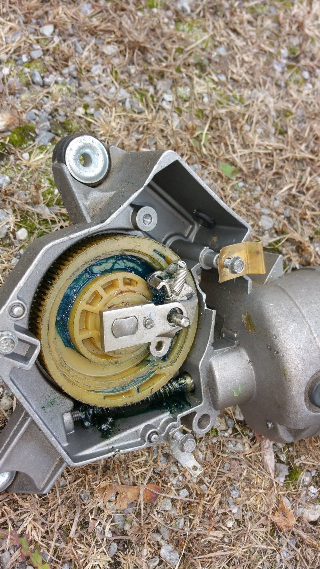

. He bought a brand new acuator can and bent the hell out of the arm, had to buy a new one. To get the wiper arms to align he had to strip the threaded adjustments and crank the hell out of them past the adjustment stops, had to buy new ones

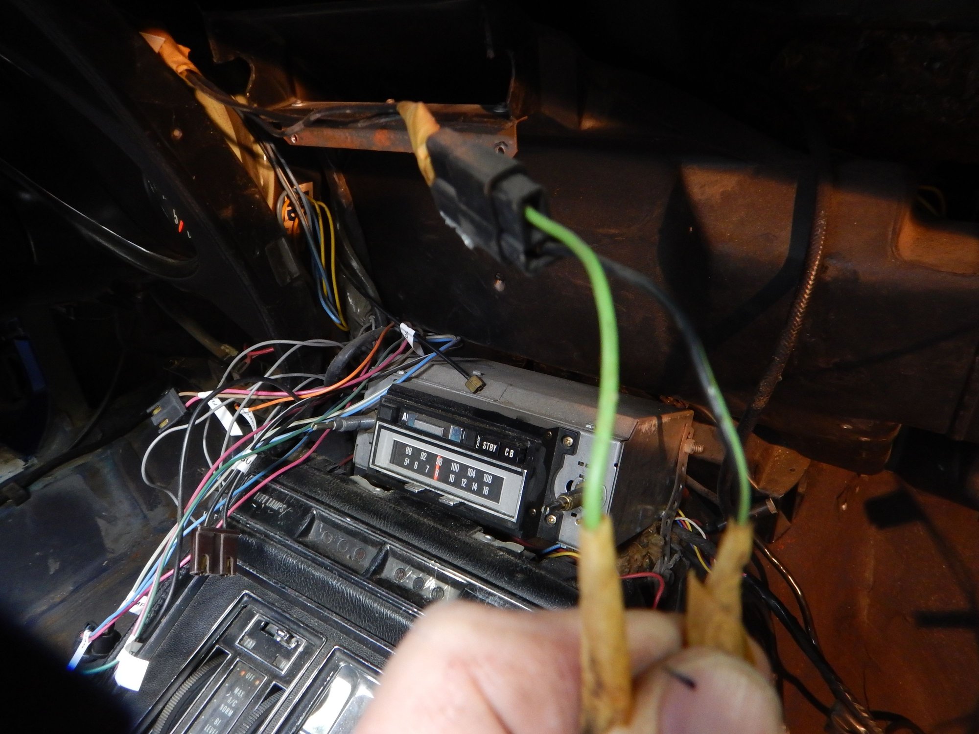

. He put a new inside wiring harness in the dash, thank you. But cut all the original wiring and left some there which was confusing until I pulled the dash off to fix bulbs. He didn't connect the grounds, put sockets in wrong holes, and didn't put in all the bulbs, so when I put on my high beams my right turn signal indicator came on and when I put on either signal there was a week flash behind the cluster, some sockets were empty. When I went to replace bulbs in the guage console I found he cut the back off to out in a voltage meter, that he held in place with seat foam and duct tape. replaced everythinig with used parts and Had to buy a used one.

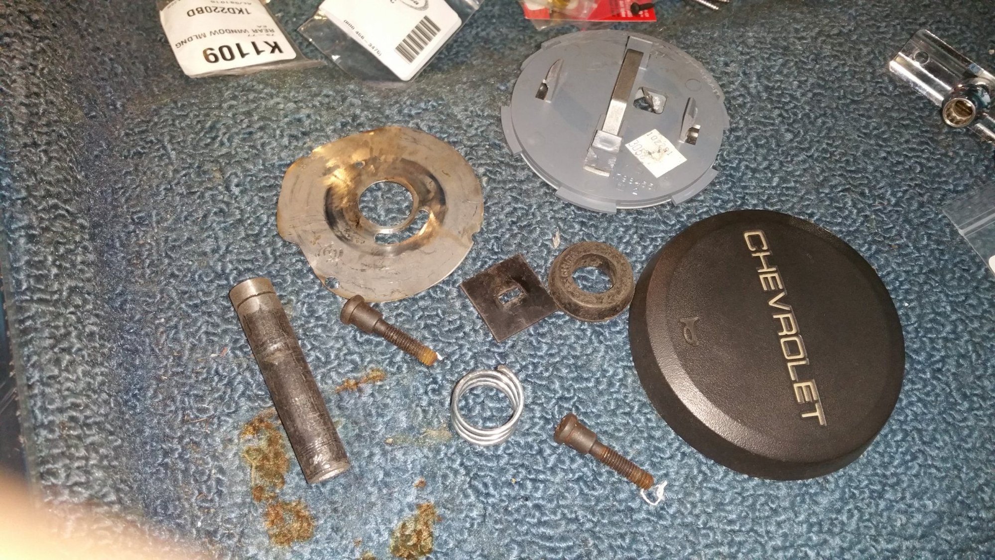

So I dropped the steering wheel to get at the dash and deciced to look at the horn parts, Buba took parts from I don't know what and just poured them in the column to get that to work occasionally, what a mess. 3 prings, some long round bars, it was just a mess. I threw it all away and I had to buy a new one.

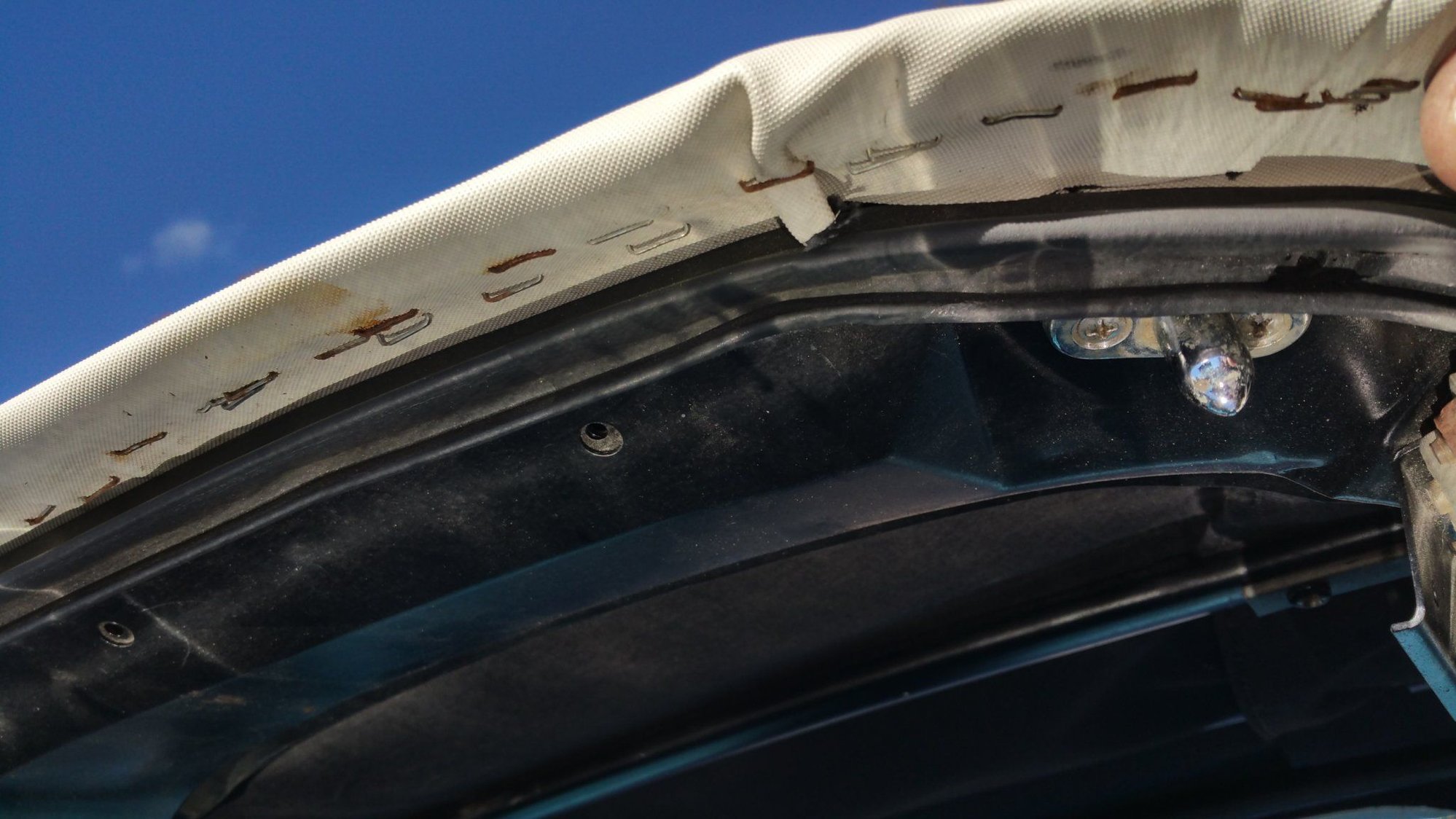

Onto the soft top. weirdest looking bunch of weatherstripping i have ever seen, I though it was just torn up. Bubba put the canvass on himself, used a hole box of staples to prove it, he just didnt bother to look and see if it was centered, and didnt bother to adjust the frame before he put it on, so the top is on the frmae crooke and the glass gaps are huge, hence the extra weather stripping on top off weatherstripping to fill it in. I pulled all that crap off, put on the hardtop i bought and readjusted the glass. Then put the soft top back up and readjusted it, its servicable, but windy and the plastic window is wrinkled and coming apart so, I have to buy a new one.
While I was putting the tops up and down I notice the rear deck was apain to operate, Bubba wen tot eh hardware store and bought some lawn mower cable since it looks likethe origianl adn wired it in, but when he got to the mechanisms he wwrapped it around and made some sort of knots so it would operate. Had to buy a new one.
After all the bulbs were replaced I tried to fix the stereo. He used a regular nut instead of the super thin ones that go over the ***** stalks to retain it. Of course it was the wrong thread pitch so he got a bigger wrench and just kept turning it until it got tight. Well it was an after market stereo that had the fake old school face and the digital one that lit up behind it, the ***** are just quarter turn electronic ***** but after his work they went completely around because he had twisted the stalk internally and it ripped the mother board all to hell and broke all the internals. Had to buy a new one.

2) 3 Zip ties holding the horn pieces together. Oh and who needs a horn since the zip ties kept causing the horn to sound... so lets just toss the actuator.
