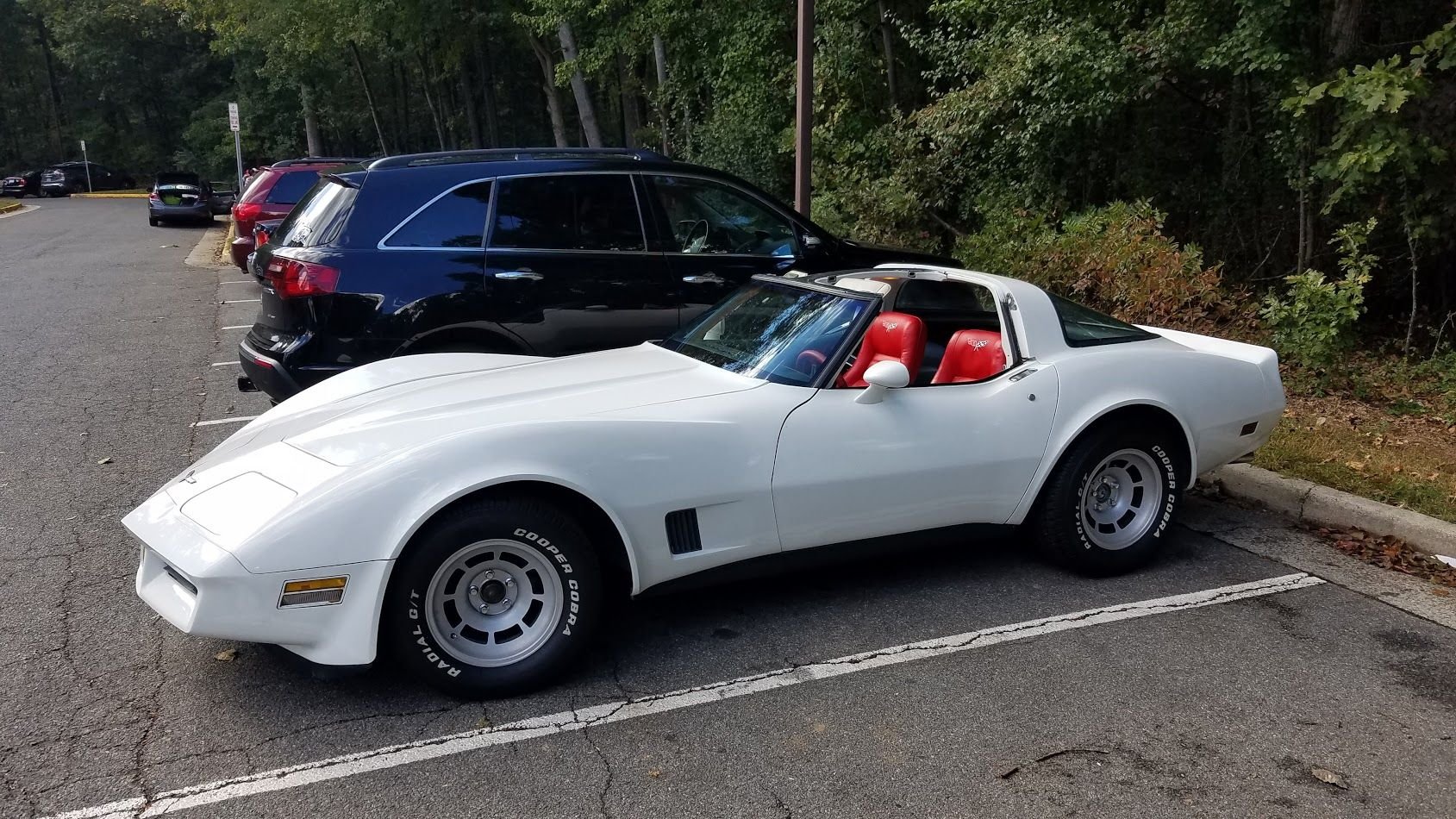

Back on the road! Well, sorta. A quick test-drive at least.
I need to refine the rear alignment, and re-bleed the brakes. The car pulls in both directions. And the master cylinder was dripping fluid when I got home, so that will likely need to be replaced.
But at least she's on her own four tires for the first time in months!

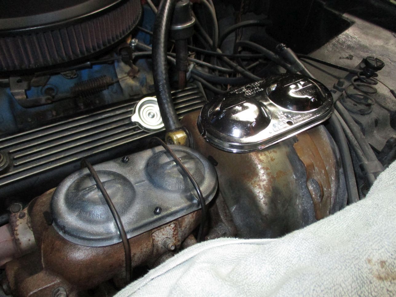

As they say, if it's chrome, it's gonna leak. Well, that was true of the brake master cylinder cover. The old one leaked, and looked terrible. The new one was chrome (and looked a different kind of terrible), but it did come with a new gasket. I took the old one, wire brushed it until it was shiny (and convered in tiny, shiny pits), then I coated it with gun bluing, along with the two straps. Here's the end result. A third kind of terrible, but it doesn't leak, and didn't cost me $40 like a new zinc cover would have.

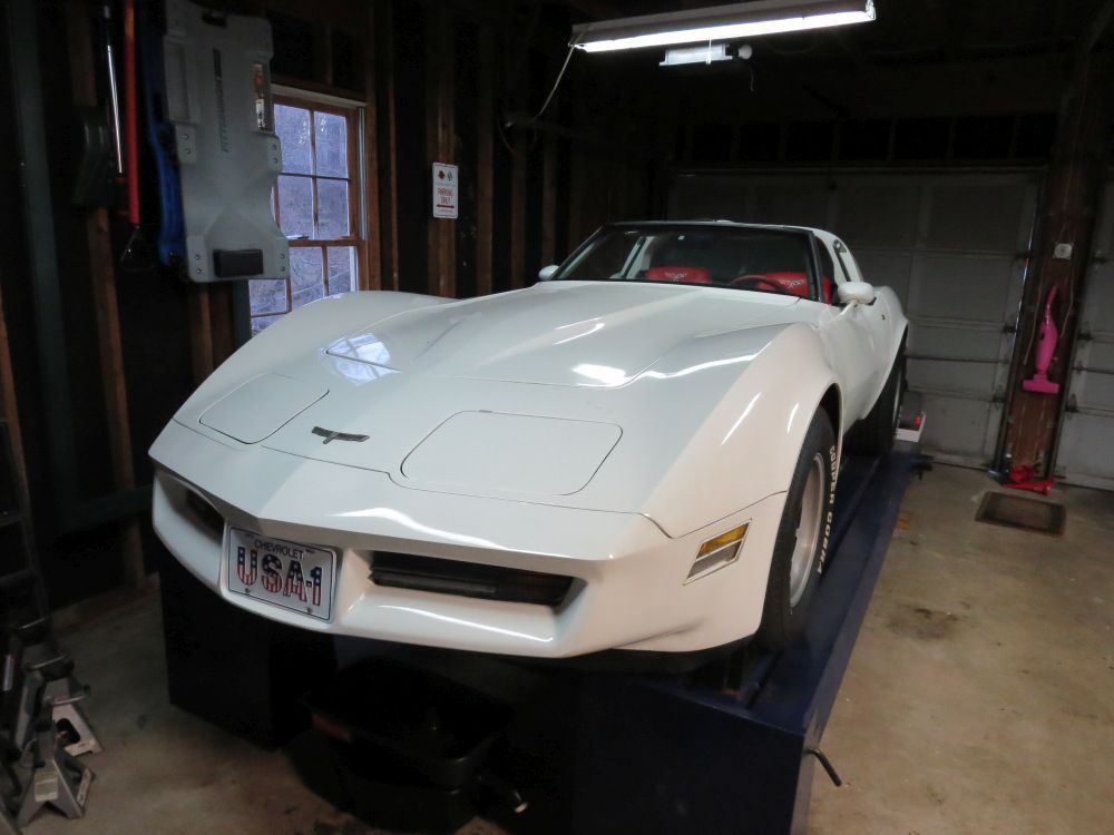

Here are the rear calipers, finished but before installing them. I used the new "High-Heat" O-ring rebuilt kit from CSSB Inc, and used ATE Dot 4 brake fluild. I used G2 Brake Caliper paint, which is a two-part epoxy. In the photo on the bench, they are still wet. When dry, they smooth out a bit. I had more than enough for two coats on all four calipers, but I ended up throwing a lot away and only did the rear calipers for now. I may go with Wilwood D8-6 calipers in the front, or just rebuild them with another set of CSSB O-ring kits.
I purchased a set of Crowfoot wrenches to help tighten up the power steering lines during the Borgeson install in my wife's 79 Corvette. The stainless brake lines I bought for this application did not fit into the brake line retainer on the rebuilt trailing arm the way the old rubber ones did, so the crows foot wrench set was extremely helpful in keeping the hose secure while I wrenched the steel line into place.

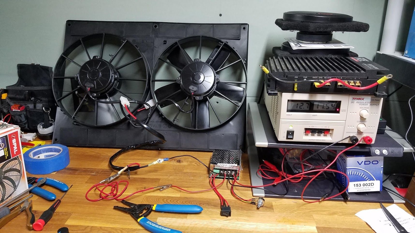

I bought a DeWitts dual Spal fan from a fellow Forum member, delivered via AllVettes4Me at Carlisle (Thanks David!). I hope to get it installed soon, but I tested it today. Here's the test setup. It is connected to a DROK 40A motor controller. My benchtop power supply maxes out at 11.5 A, but I'm within 90% of full power at that point (the power supply is current limited, the voltage dipped to 12.5V from 13.7). Below full power, the voltage held steady at 13.7V, so it appears that the PWM works just fine. One of these power supplies should be able to handle both fans, but I'll use two for a bit of redundancy.
The potentiometer works as both a speed control and an on-off switch. Now that I know how it works, I'll figure out a circuit. As you can imagine, the description on Amazon didn't exactly match reality, and there was no circuit diagram. I added the "Input" and "Output" labels, as the label on the device is in Chinese. I don't need more ways to turn the fans off, but rather a way to turn them on a bit at operational temperature, with the option to go at full blast when needed (both automatic/temp controlled, and an override option).
The DeWitts kit (SP460) came with a single 195 degree switch. I s'pose I'll try to wire it so that the fans are always partly on with the ignition, and then switched to full-on with the temp switch. Or I'll need another temp switch, but I'm out of places to put them.

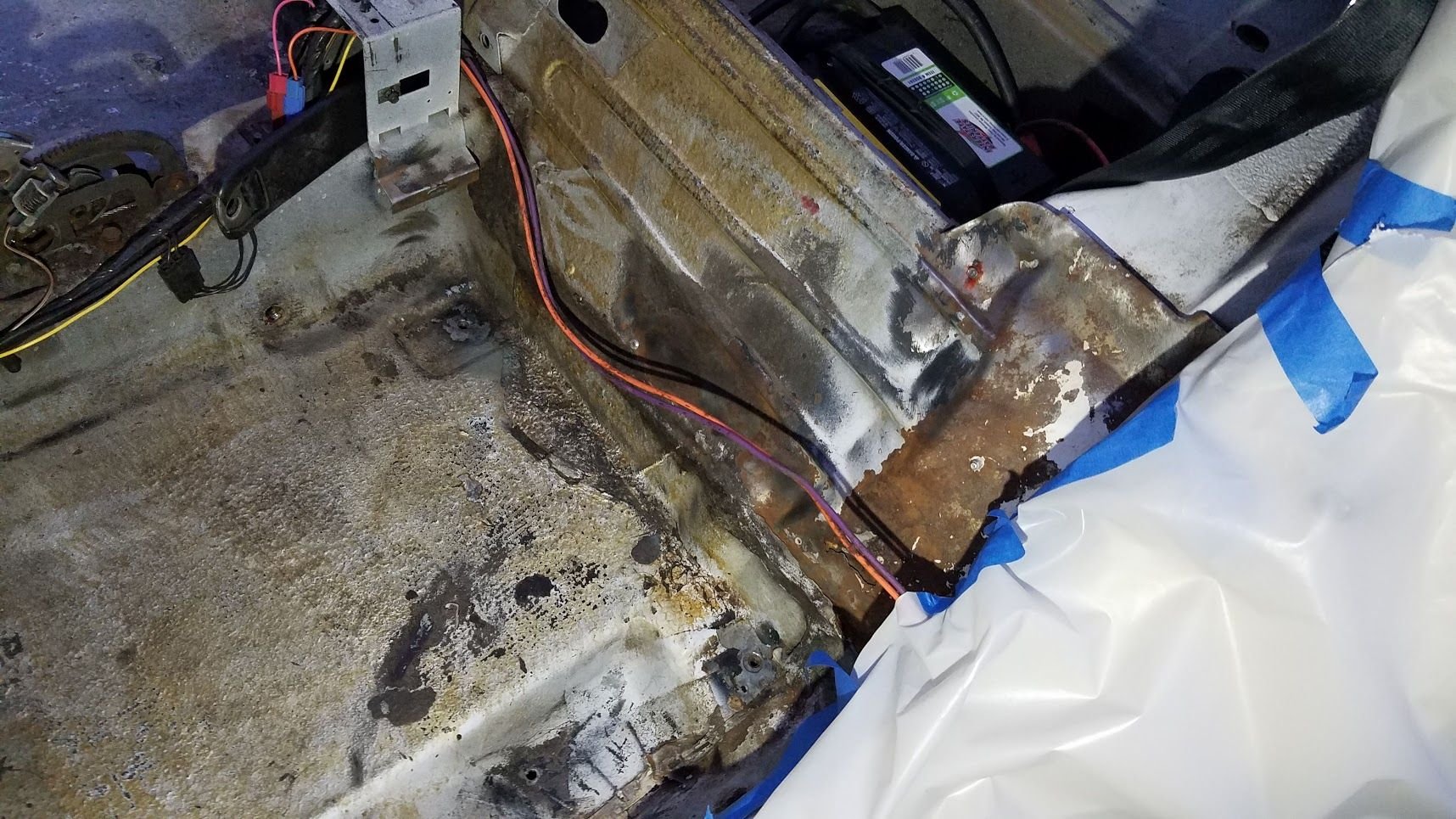

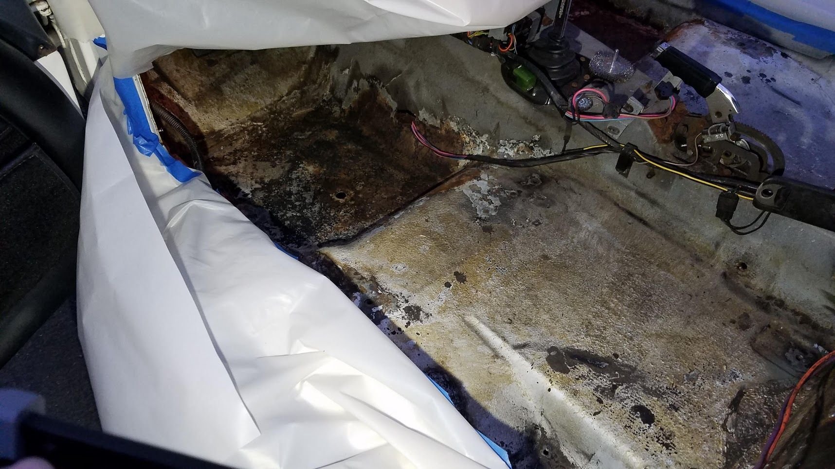

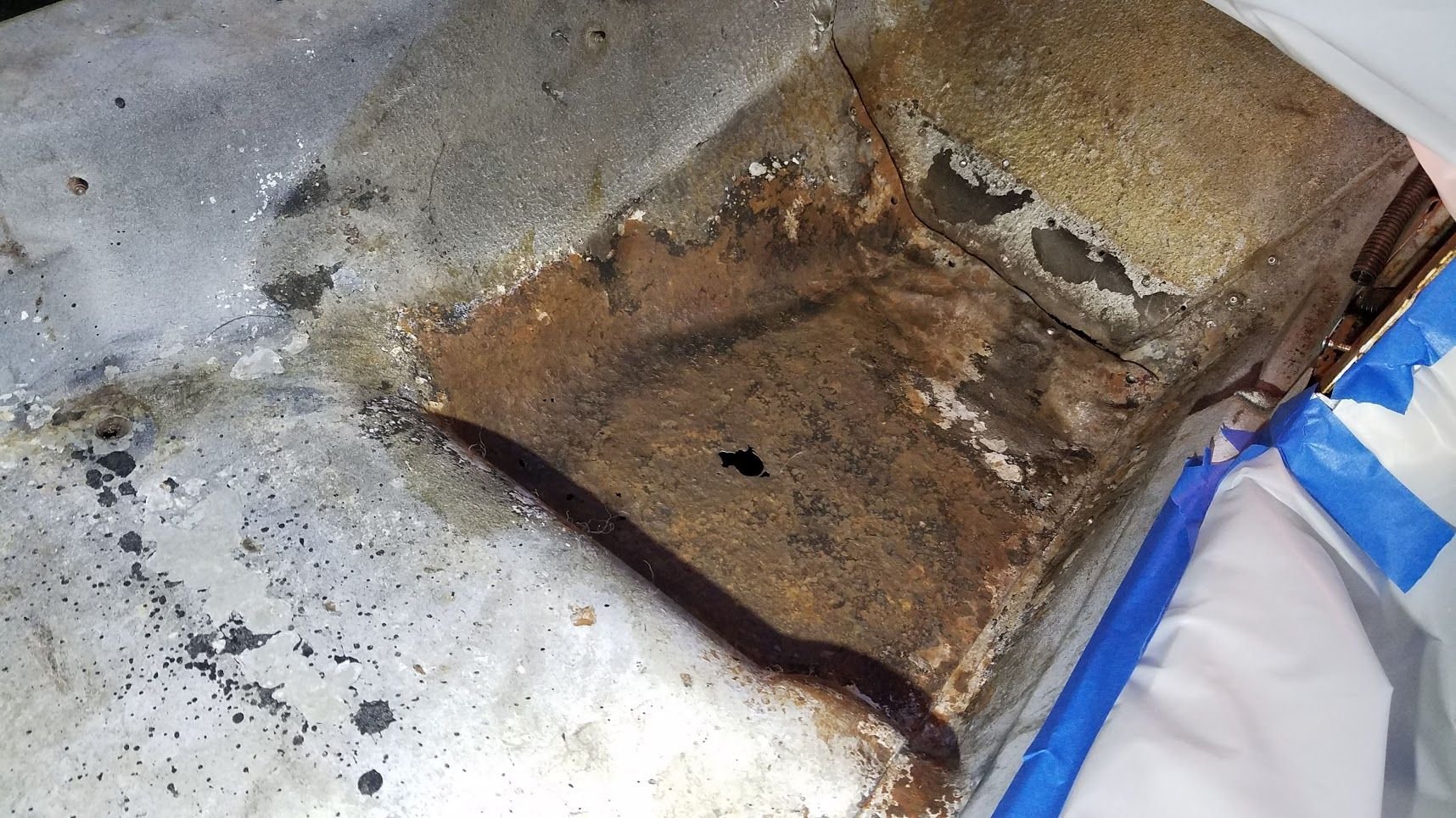

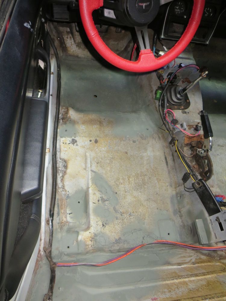

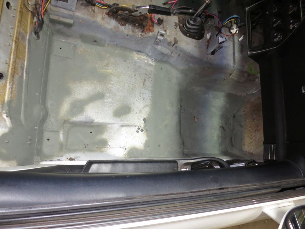

This past week I pulled the seats back out of the car, and started grinding the rust on the floorboards. I have a complete passenger side steel floor, and some day I'll put it in. In the meantime, I ground out what I could without going crazy. I'll reinforce the passenger floor before putting down carpet.
As it was getting dark, but before it snowed, I was able to paint the bare metal (or bare rust) areas. I used Rustoleum Self-Etching Primer (dark gray). Go ahead and second guess me, but my reasoning is this:
I'll be back in here someday, likely grinding and cutting, so I didn't want to use zinc chromate or POR-15, as I had with removable parts and the (entirely replaceable) frame
I didn't want to mess around with neutralizing or cleaning acid from hard to reach places, so I didn't bother with Ospho, as I had with the frame
Final appearance doesn't really matter, since it will all be covered with carpet
On previous pages are the true before photos. Here are the after grinding, right before painting pictures. FWIW, in the spots where the galvanized coating was still intact, there was no rust. The worst was where the heater core had leaked, many years ago.

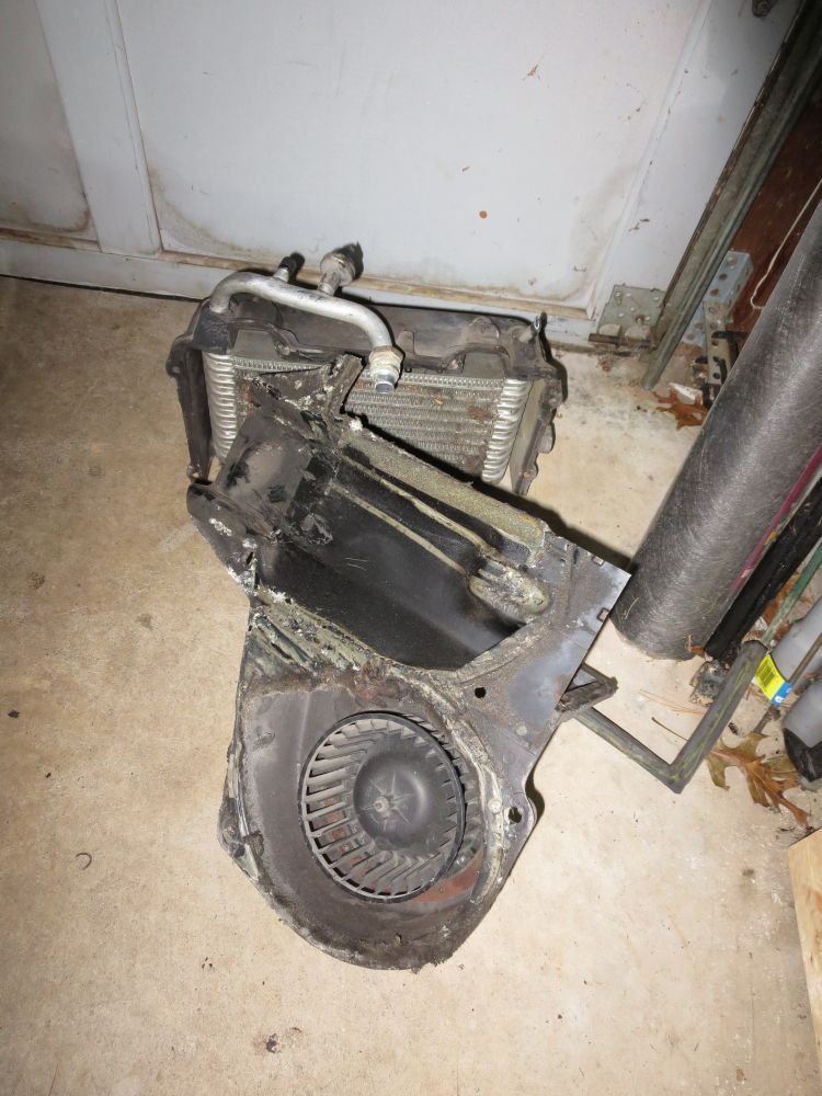

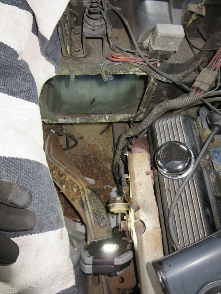

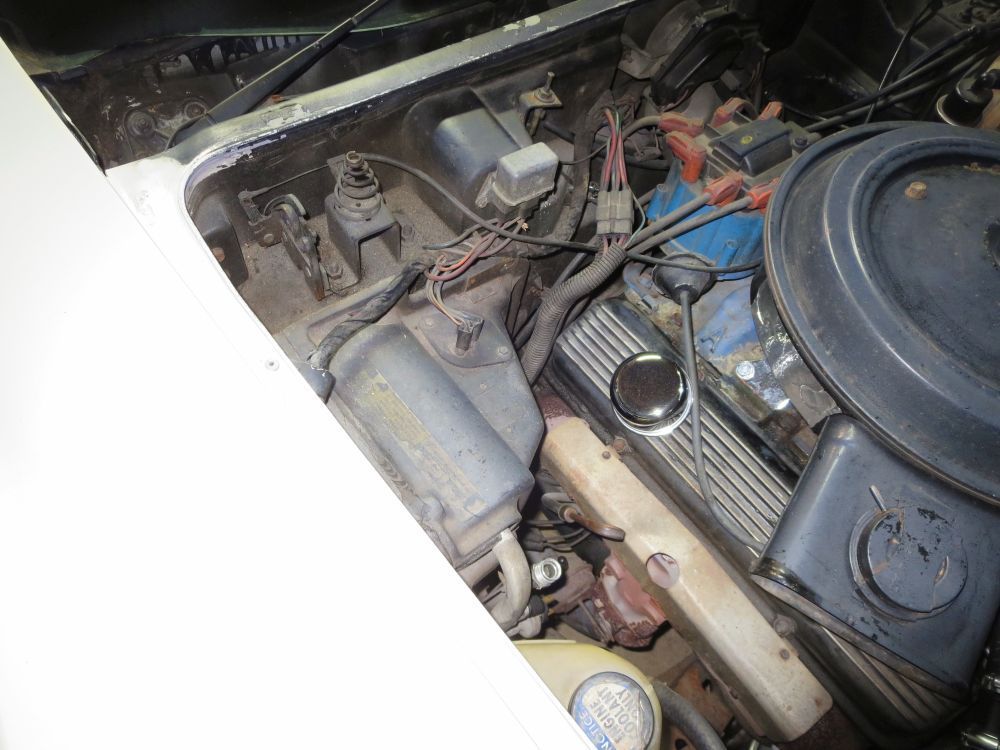

I removed the AC box and blower fan assembly from the engine compartment. I had to break it onto two pieces (and had a hell of a time finding the last screw), but it did come out without removing the engine.

There is so much more room in the engine compartment now. If anyone needs any 1980 AC parts, or a nearly complete system, let me know.
Here are the primered floors, ready enough for carpet.

Removing the AC box is tied to the fan project. I will use the newly recovered space to mount the relays. Also, after thinking about it for a bit, I made some progress on the wiring. By shorting two of the pins on the potentiometer, it is possible to make the fan run at full blast. So, as long as I don't mind having the fans run at low power all the time the ignition is switched on, I can have the 195 degree temp switch control a circuit that shorts the potentiometer pins together for full fan blasting when needed. I'll have two On-Off-On switch such that I can have positive control of each fan (normal run, off, and bypass on), and still use the supplied relays to control power to the circuit. I'm thinking about mounting the motor controllers where the radio would go, making it easier to access them. I'll try to post a circuit diagram, if I can find my copy of Visio.
I have deleted all my A/C parts except the evaporator housing, it's on the list, I plan on using the AGM firewall delete cover.
Do tell, where is the hard to find screw?

The inside components have already been removed from the car. So the leaking heater coil, the mixing box, all that stuff under the dash was gone. There were only, I think, two nuts left holding the evaporator box to the firewall. I removed the coolant overflow tank, those two nuts, and the box peeled away from the firewall easily.
Then I was stuck. With great difficulty, I removed a bracket from the box, including one large screw. Still not enough room to pull it out. Then I removed the remaining 5 obvious large screws that hold the two halves together (my car is on the ground, with the front tire still mounted, but there was barely room to crawl under the car to reach the bottom screws). I tried prying the pieces apart, but no luck.
The hard to reach screw at the bottom. It's an 8mm screw. Like with everything, I needed a mix of SAE and metric tools to do this, and I had to get this from under the car.
I took pictures, then promptly lost my camera. I'll post them when I find it again.
Under dashboard components previously removed
I am planning on retaining the use of the fan for defrost purposes and thus the reason for the AGM firewall cover though I have long since deleted the heater hose fittings on the waterpump and intake, then capped the heater core inlet and outlets. I may possibly add a Vintage Air system someday, perhaps another years winter project. Are you going to install sheet metal on the firewall or glass it in? (Never mind, question answered by the WTB post. )
Thanks for the information on the difficult screw, I have side mount headers so reaching from underneath in that area is limited.
Looking forward to seeing more of your project, enjoy it!

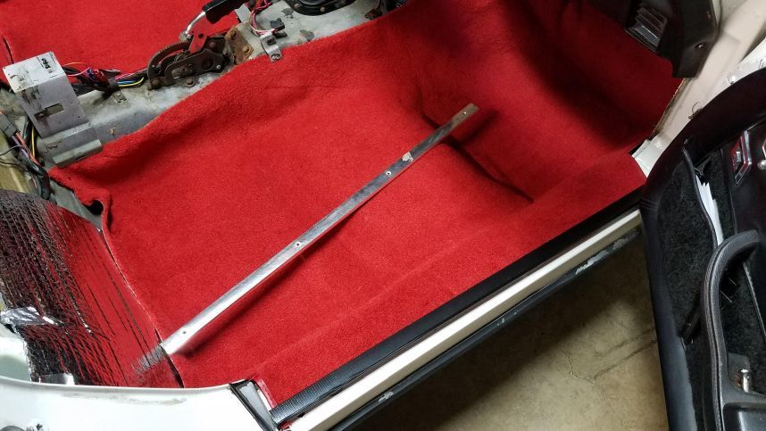

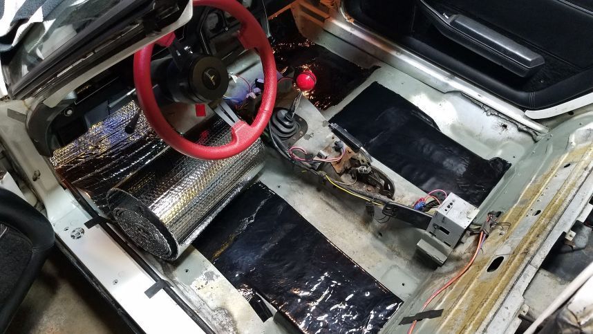

Here are some photos as the carpet goes back in.
I used 4 lbs of Hushmat, which was hard for me to do for a car that is intended to eventually get on the track. But I still have to drive an hour each way to get to the track. The rest of the floor is covered with Reflectix. The carpet, ACC from Wilcox during a weekend sale, has the Jute only under where your feet go, not on the sides, and not on the firewall (with the pedals there, I guess that's a good thing).
I hate chrome, BTW. I don't mind it on the exposed parts under the T-Tops, but anywhere else on the car, I hate it. My shiny aluminum strips that hold the carpet edges down under the door look like crap. If I clean them up, they'll look like chrome. So I found some carbon fiber wrap in the garage that was a perfect fit!
It's actually just black Gorilla Tape.
Bikespace is offline

Did you use anything (adhesive) between the Reflectix and the dynamat to hold the reflectix in place, prior to installing the carpet? I just got my mat down and have the reflectix to go in next followed by the same ACC carpet set also from Wilcox. Trying to cancel noise and heat but worried about the carpet etc feeling like its moving around under foot when its done. GIL
