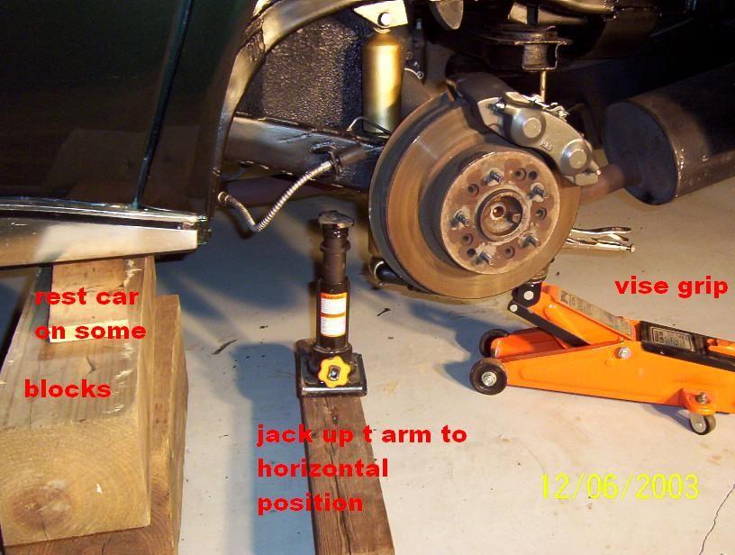

Originally Posted by Ed T
take the pressure off by jacking up the T arm to near horizontal ( with a second jack), also do this when you are ready to install the bolt for your new spring and it will drop in easy.
Thanks everyone for their help, I tried this and the good news is the bolts are off. Bad news is, it helped make my decision on new trailing arms a whole lot easier, the wrench tore through the side of the trailing arm when i was using a breaker bar to get the bolt off. So off to get new TA's I go.
