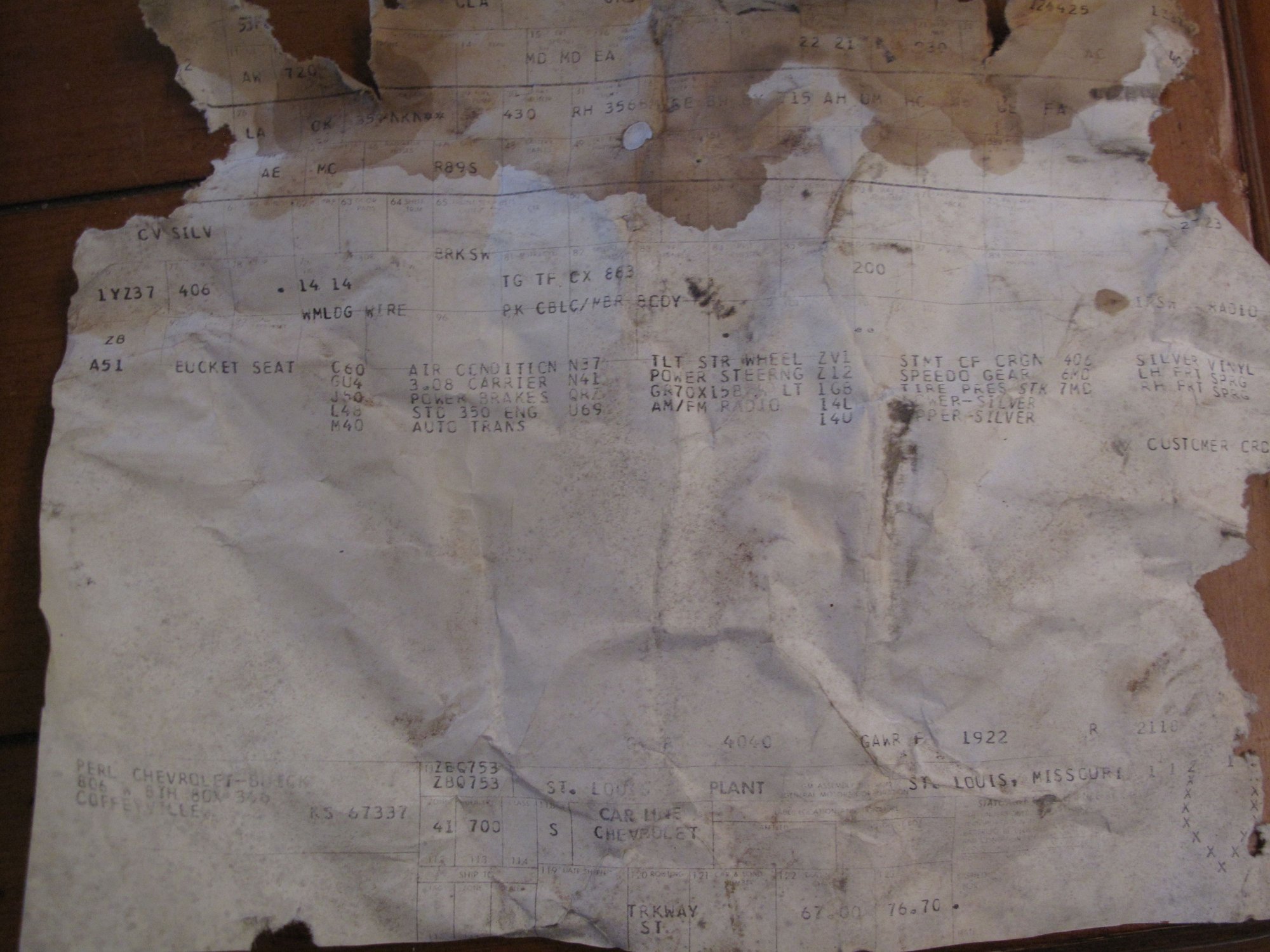

Bought my red '74 coupe last August. Someone totaled their 74 and bought a good chunk of their interior. I'm replacing the lower dash panel and as I'm slowly pulling it out, I see some papers between the tach and speedo. After what Bubba has done to the car (I only paid 3k...so you can imagine) I figured there was no possible way the build sheet would be saved...but sure enough! Pretty exciting! Car has made it from Coffeyville Kansas to Madison Wisconsin.

Nice find! I found a build sheet in that same exact location on a '73 I had back in 2002. As I was working on the steering column little flecks of familiar looking paper kept dropping out from behind the dash...I picked up the pieces and thought could it be? Lo and behold, I dug a little deeper and found it wadded up and stuffed in the brace between the speedo and tach. Much was missing, but I did find that the car was sold at Rockenbach Chevrloet in Grayslake, IL. They were still open at the time I found the build sheet...I called them looking for any records they might still have and learned that if I had found the sheet and had contacted them 3 years earlier I could have gotten the archived sales records for the car, but just my luck, they remodeled and destroyed all of those old records. They are now closed.

Nice find! One of your codes which is a statement of origin code ZV1. I wonder what that was for...most unusual. If you have other paperwork, it may tell you the car went overseas before returning to the states.
