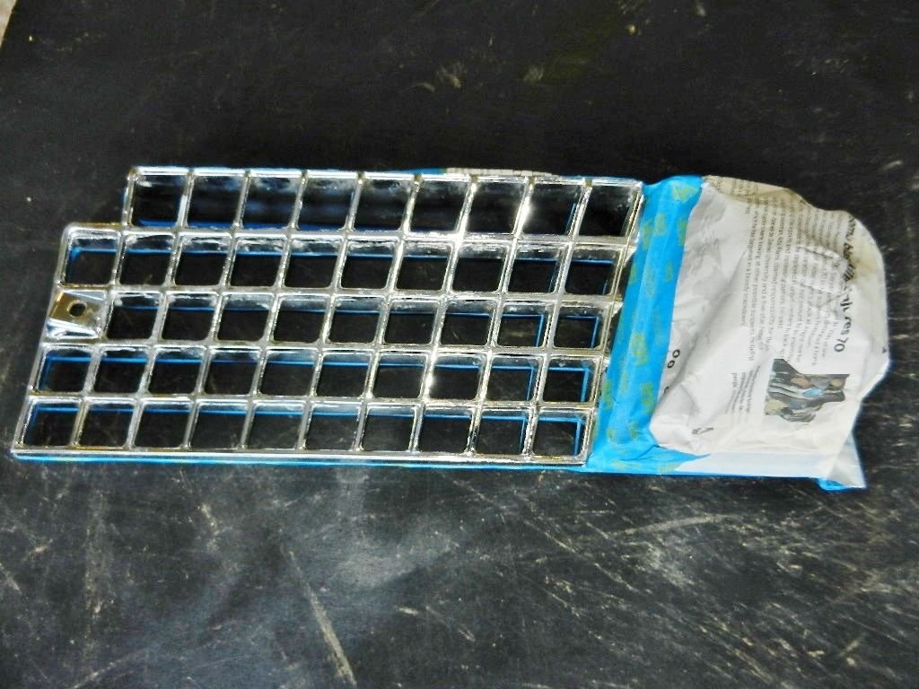

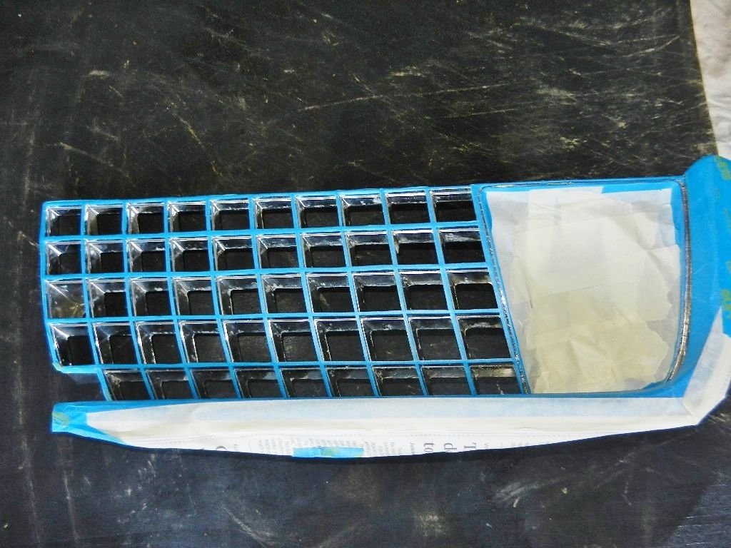

I found that the GM grill paint was more difficult to remove than any other paint or finish I've encountered. Alan's choice of the Eastwood paint is mine as well. It really looks nice and is close to factory paint. If you like all chrome, then stop there. The grills are easy to remove in the future in case you change your mind. Here is a couple of pictures of masked off grills. I simple cut the tape in narrow strips for the edges; others have said they used pin stripe tape.
