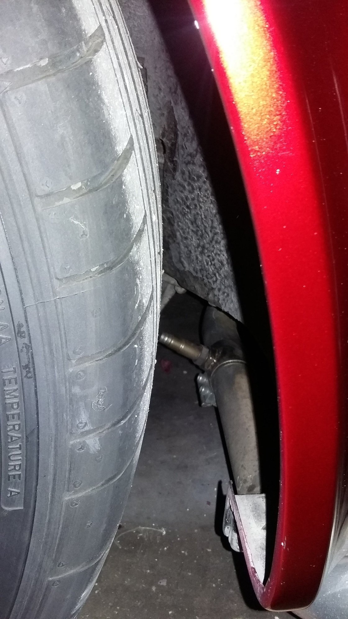

Originally Posted by imariver
I have sidepipes on my car, Where would the o2 sensor go?? Any pics of an o2 sensor in a sidepipe system?
Thanks

Originally Posted by bdhulderman
I was able to point the sensor 45 deg down, i.e. with the wire pointed up. You definitely don't want to drill the hole on the bottom or you will get moisture in the sensor and ruin it.
Condensation is why I asked, I've always been taught it could take out the sensor and, not seeing a picture, I was curious if you were able to manage a good angle.
If I remember, I'll try to take a photo for you so you can see exactly where I put it if that helps.
If you can, that would be great, thanks.
It's a little hard to see, but it's pretty much in the middle of the straight portion of the header. Believe it or not, this is actually the exhaust for the number #7 cylinder, back one, as recommended.
