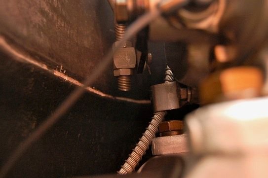

Hi 873,
Here's a photo of the typical connection at the steering column lever.
Note that it's the end of the cable WITHOUT the rubber seal.
The second photo is the cable connection at the transmission reverse lever.
The cable should follow a gentle arc from the steering column lever to the transmission reverse lever.
There should be a small bracket on the upper front bolt of the transmission to guide the cable's arc.
Regards,
Alan
The bracket that guides the cable sheath.

Thanks for the photos Alan. I don't have the bracket shown in your photo that is mounted to transmission. Other than that everything looks identical to your photos. I noticed in the photo for the "correct" cable one end doesn't seem to have an eyelet so I am not sure if the photo is correct. I do know this the shifter is definetly easier to move with this cable disconnected so maybe it's just a bad cable. BTW I plagiarized this photo from the Willcox website so maybe they can advise.

Hi get,
The 'eyelet' is the same at each end of the cable.
It's the rubber seal that determines which end of the cable is attached at the transmission reverse lever.
Regards,
Alan
