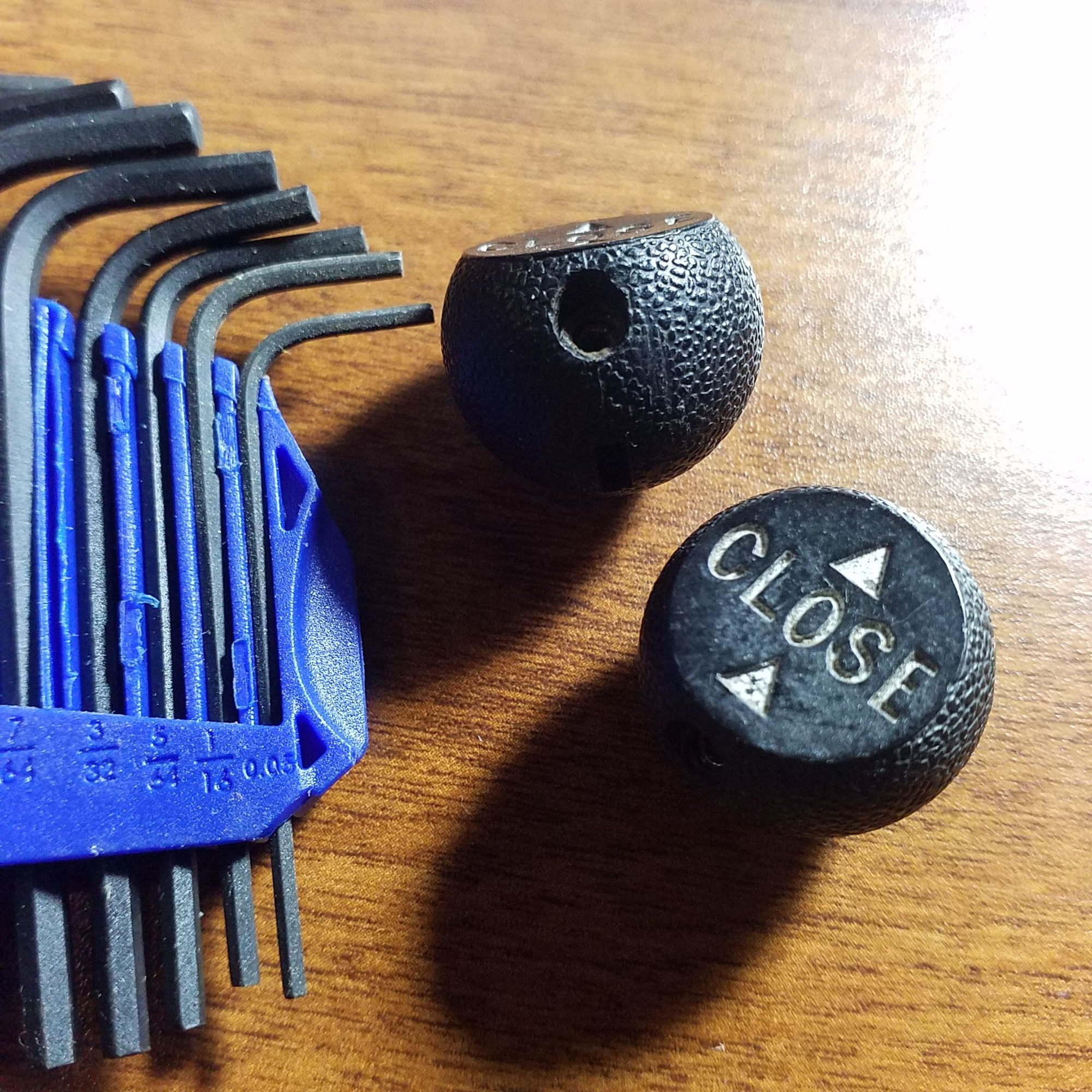

This thing is so tiny, I don't have anything that small. What is it?

Tiny allen wrench

Thanks, RF. I'll go looking for something that tiny..... really tiny. Also, SUPER impressed with my new tablet. Great pictures up close.

Allen key
.050" if I recall correctly

just go get some cheap imported Allen wrench set and you'll find the right size. I'm with Mooser, .050 seems to me as the correct size. I can check this tomorrow but you'll probably have them off by then.

I took one of my cheap allen wrenches that was slightly too big and dressed the sides with a needle file until it fit. Then I taped a label on it "Corvette vent ****" and that is the only use for it now.
Hope this helps, I thought it was an odd size allen wrench, I likely filed down a 1/16" allen wrench if the correct wrench size is .050", good to know.

In my '69, the internal hex size for the ***** is 1/16" or 0.0625.

Yup, 1/16. Boogers. Also got me a new Allen key set.
