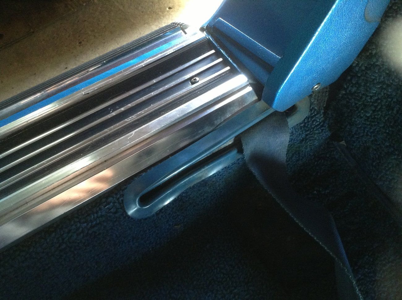

The picture above is of my 69 roadster. The car was built Jan 13 1969 and that is the factory installation/original carpet. The placement of the grommets can vary a little in one direction or the other from the few I've observed.
Are you reinstalling the original hard plastic pieces or are those the rubber reproductions? The originals were attached to the carpet under the flap with heavy duty staples. I worked with the rubber replacements and had to use a silicone to keep them in place. I don't like the repros.

The pic of the blue original interior is very helpful as now I know why some of the originals I have seen have one
corner cut off. That must have been done to fit the grommet under the trim molding.
