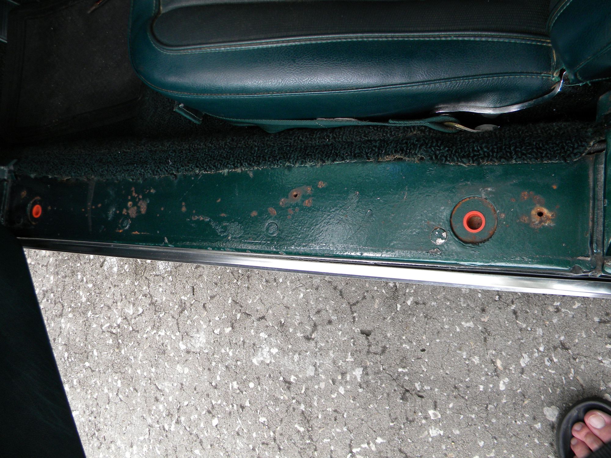

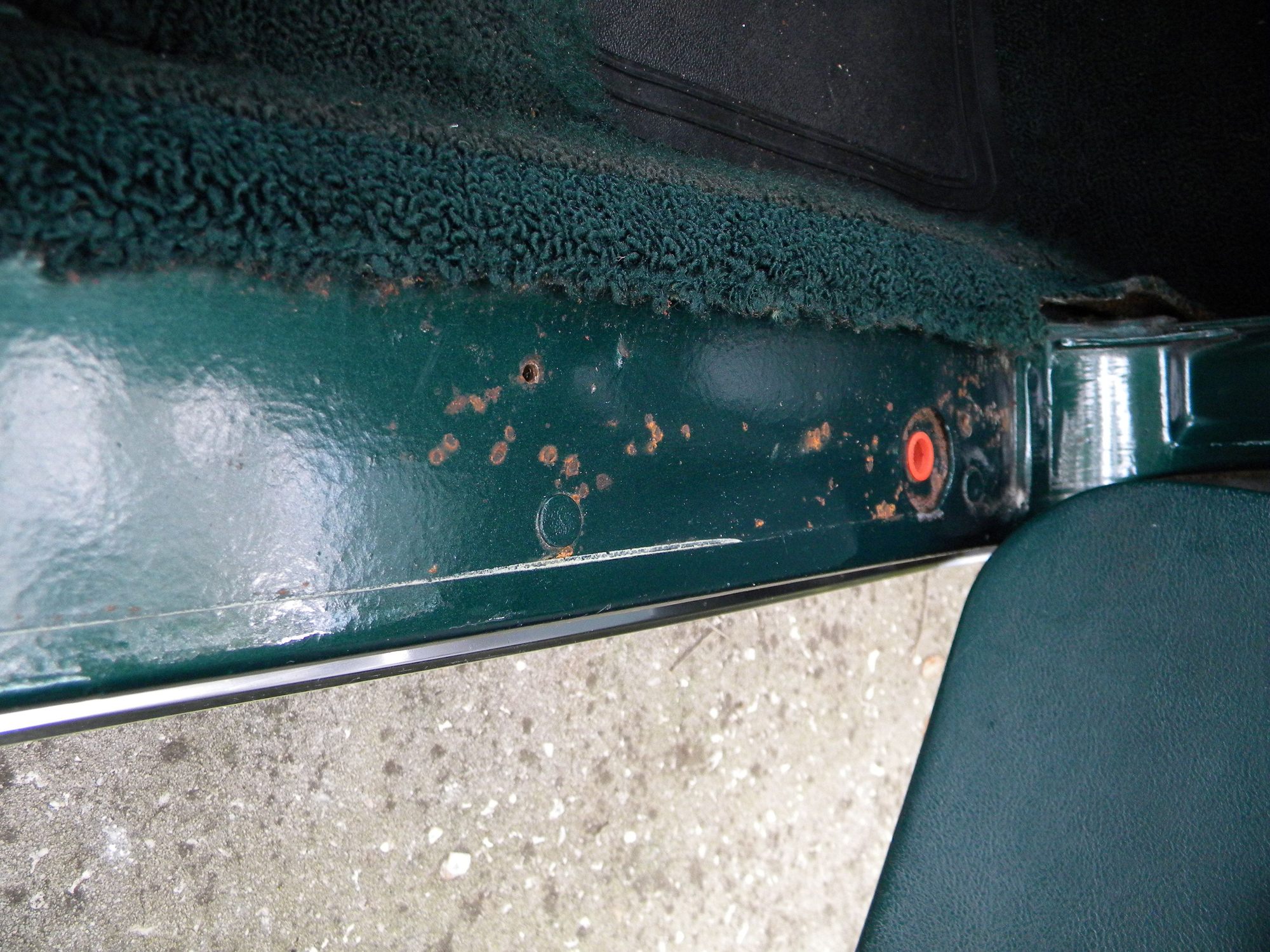

Here's some photos of my '71.
Drivers side:
Passenger side:
