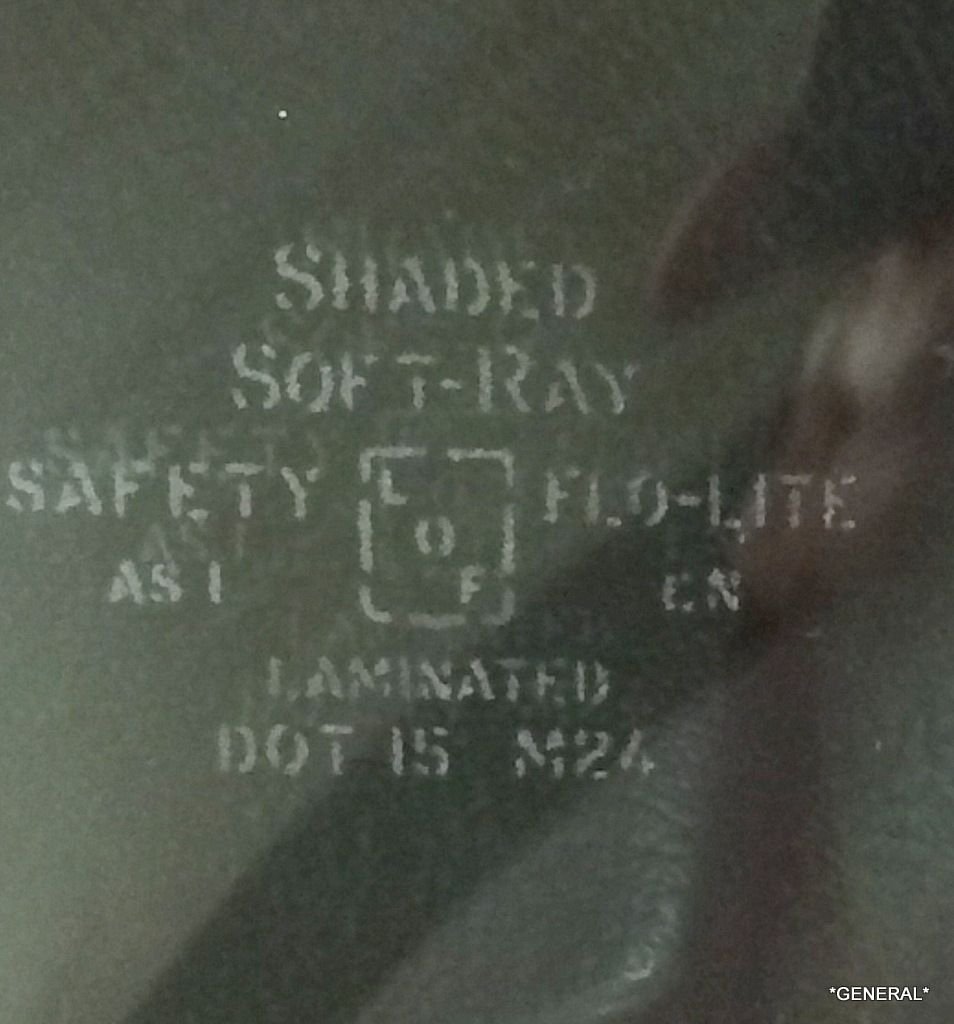

Street Rat here is a pic of my 1972 car built in December 1971.
I think your's is a aftermarket, but can't verify. What year car are you looking at? Ike
