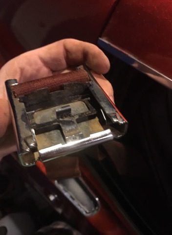

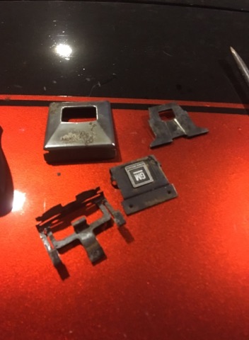

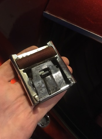

decided to take it apart myself and see what i can do! only because i found how to crack into it... you just need a smallish flat head screwdriver to pry open opposite where you stick the male end in, pry out, and the whole thing pops open.. And i didnt even have to cut and sew anything back together!!!
all internals that you can remove
Anyway, It definitely isnt perfect, as there is quite a bit of rust i couldnt really get to.. Probably still need to replace them in the end. But that is for later Josh to worry about!
