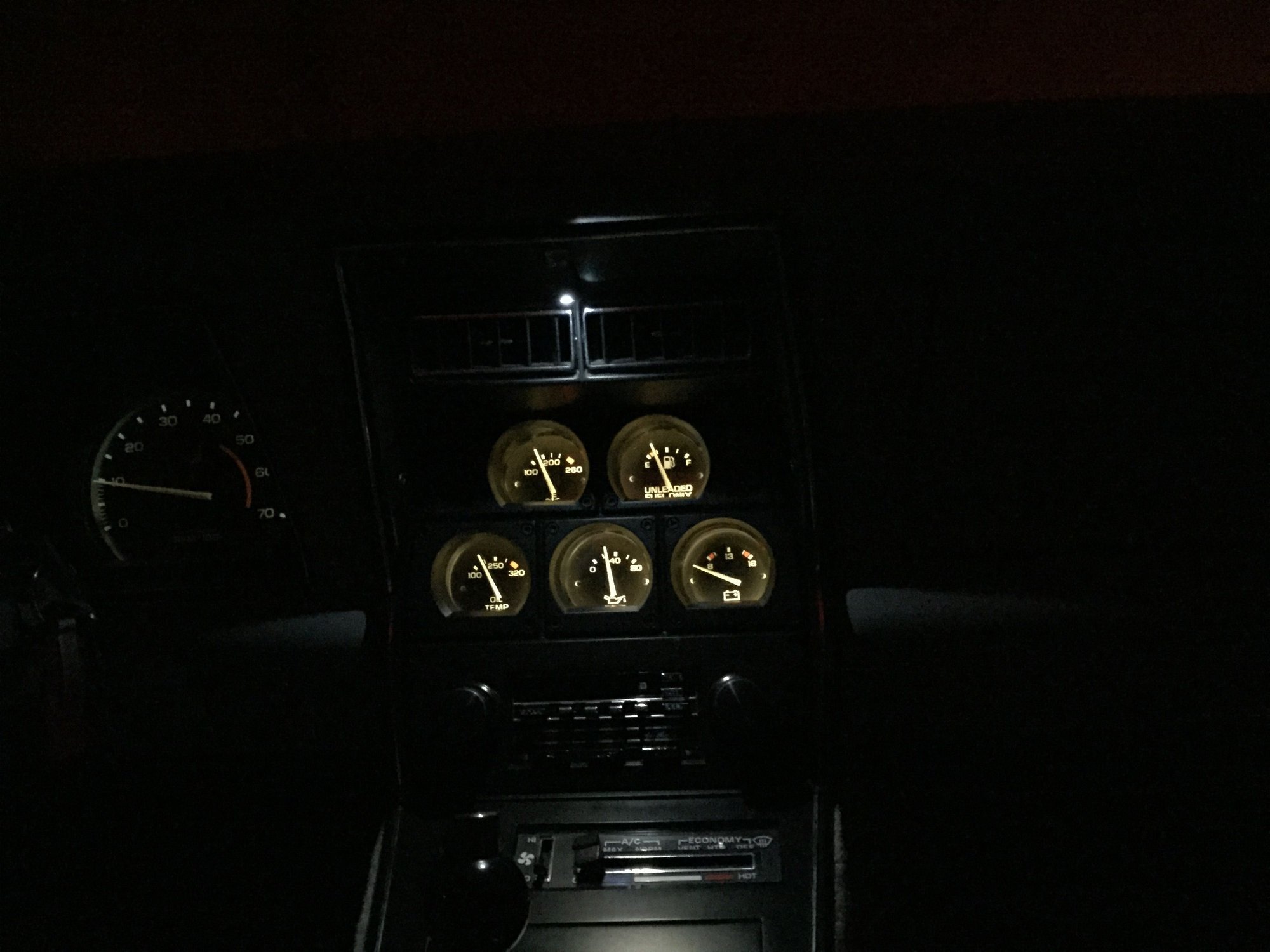

Old Mar 6, 2019 | 11:27 AM
Lakeside49's Avatar
Lakeside49
Posts: 1,206
Likes: 365
From: The Motor City
I'm attaching a photo of how visible the gauges/climate control looks after installing warm LED bulbs. Note the comparison with the speedo/tach which were on full bright with the original bulbs. You couldn't read them at night with just a glance. You can see them now.
Note: I took this picture in my completely dark garage where you couldn't see your hand in front of your face. So, in a normal driving environment there is ambient light from the outside which further washes out the gauge visibility - so, it doesn't look this bright when you are driving it at night but you get the idea, especially comparing it with the weak OE lighting performance. It is an easy upgrade, discrete (likely no NCRS issues which I respect), and a safety improvement.
Hope this helps others!
