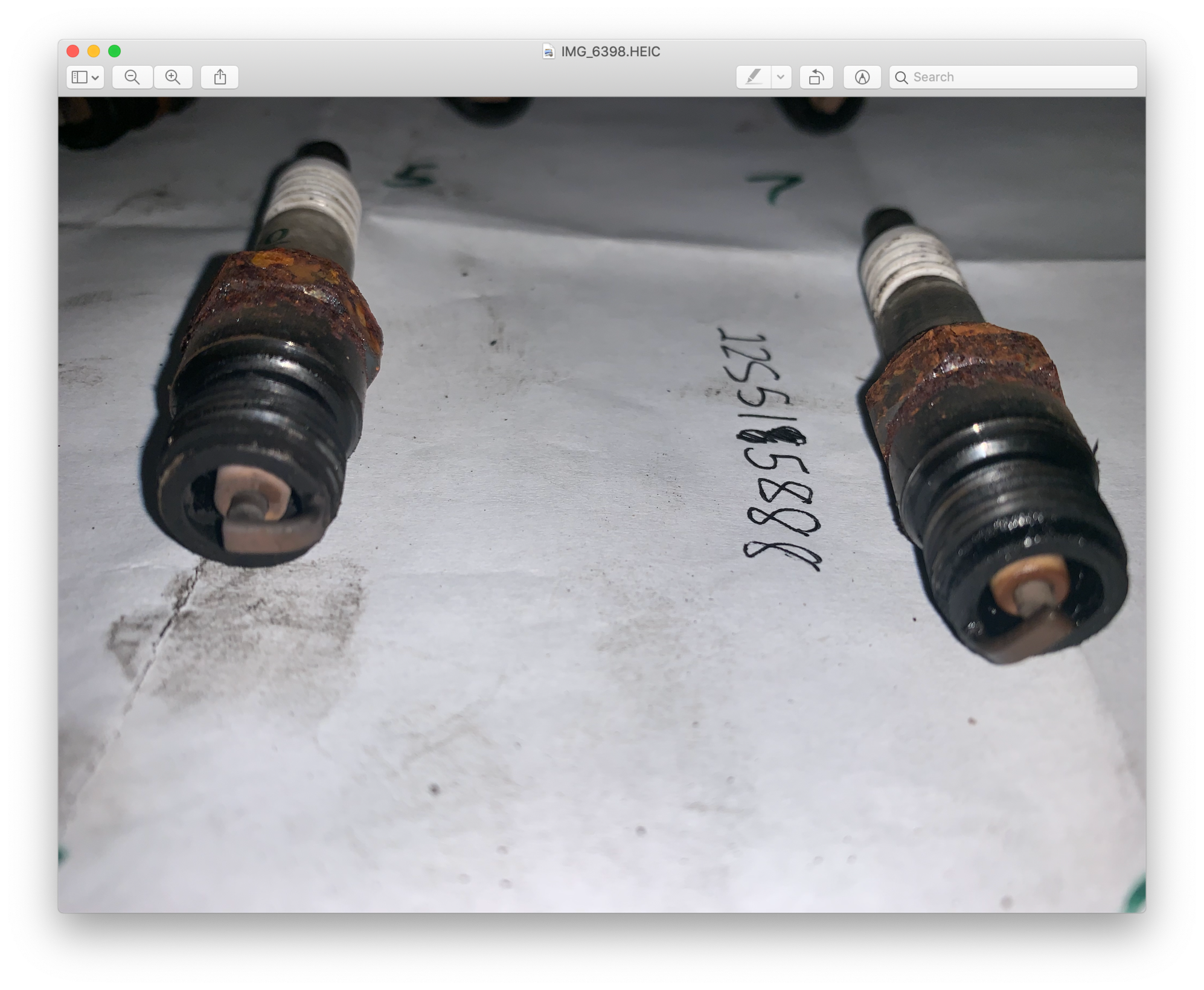

I finally had a little time to start investigating and decided by pulling the plugs. Aside from them looking like they are 40 years old, I don't see any issues. Granted, I'm not sure what I'm looking for. They all seem to look the same. I will say, getting them out was a major pain in the rear. Are the chrome guards really necessary, as I think it will take forever to try to get them back on.
I also decided to replace the fuel filter, although I haven't go to that yet. Bought it, but haven't installed it.
So does anyone see any issues with these plugs?

Thanks SpeedReed. I just ordered the AIM, as I believe my wires will route in a way that may require specific wires.
Does anyone have any input on the condition of the plugs? Do they look like the engine is running correctly?

Originally Posted by Hig116
Anyone?
The plugs look a tad rich but otherwise ok......
What distributor is in this car right now?
Drive it close to home til it quits.....hop out and whack the throttle and stare down the carb throat and look for Accelerator pump squirt......if there is none....stop playing with the ignition.
Jebby
