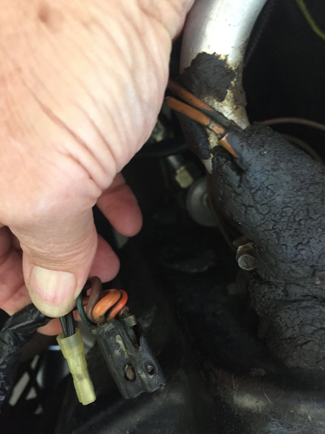

Found this looking for my no start issue. Was told this is a relay for the ac/heater fan.
Obviously seen better ( cooler) days. Replaced with new relay and connectors
Ended up starter / solenoid replaced and all seems good..... for now
