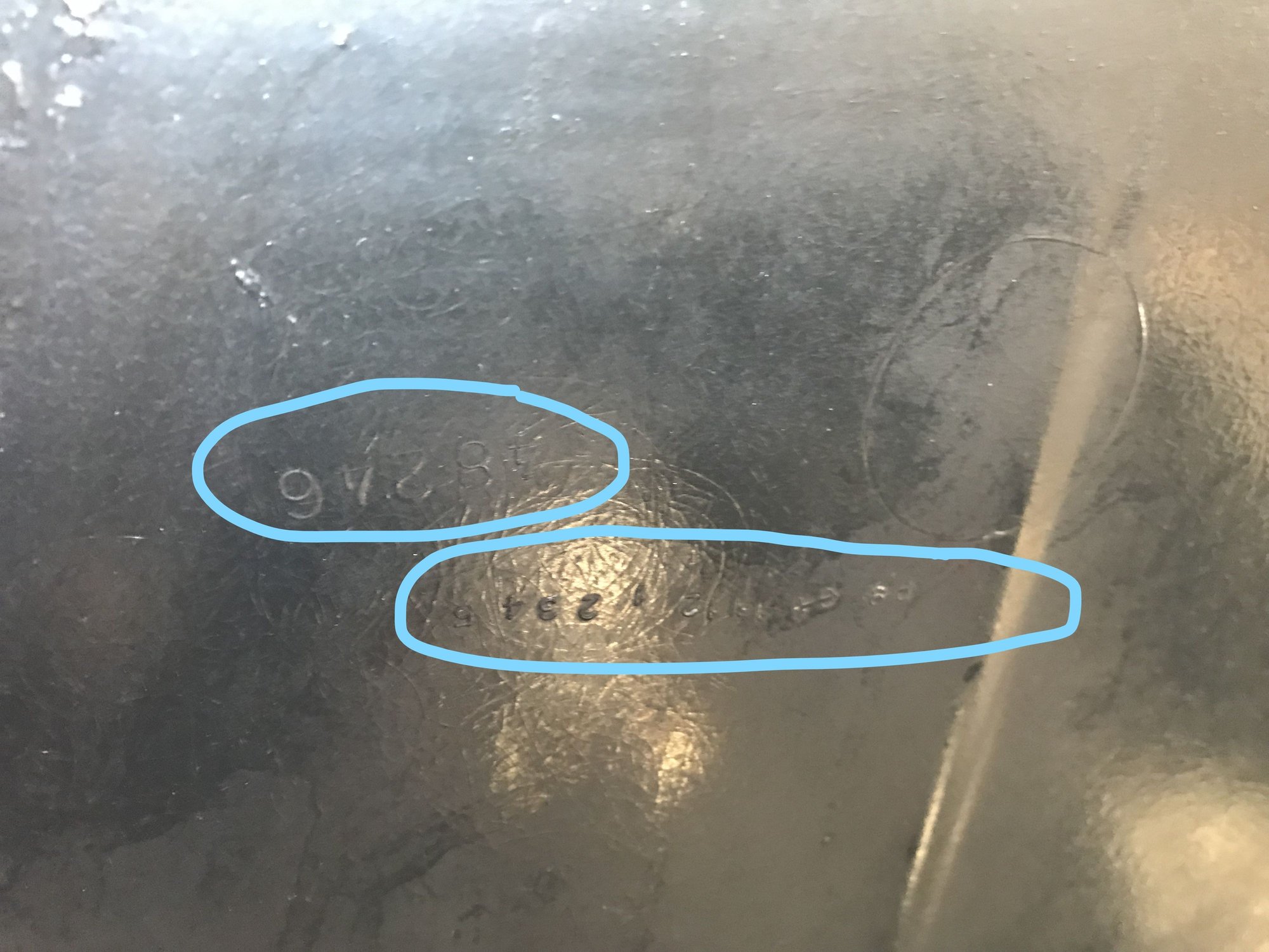

Ran into two sets of numbers on the underside of the hood. Car is a 1969 L-46 350 cubic inch / 350 horsepower air conditioned car with PS, PB, M-21 close range, 370 posi-traction car. Build date is October 31, 1968.
First set of numbers are 1/4" tall and read 48246
Second set of numbers are below and right of the 1/4" numbers, these are 3/16" tall and read 89 01 1112 1 2345
Not sure what the numbers mean. I have the older 3rd Edition of the 1968-1969 Corvette Technical Information Manual & Judging Guide and there is nothing mentioned about numbers in the HOOD section on P.24 or in the MECHANICAL SECTION for engine compartment on P.68 HOOD UNDERSIDE. Pretty certain this is the original small block hood but do not see anything about stamps or numbers mentioned in the judging guide. Anyone have an idea what the numbers mean or how to decode these two sets of hood numbers? Thanks in advance for any help.
numbers are located underside of hood just above where the master cylinder is located when the hood is closed, closer to the firewall on the driver's side.
the group of five numbers are 1/4" tall. The other group of numbers are 3/16" tall.

Don't feel bad L-46man. We've had this car 10-years and it's the first time I noticed them because I'm getting ready to put the '69 hood insulation blanket mat back in the car. Two of the retainer pins are intact. The base of the third pin is intact but the etainer pin itself broke off some time during a previous ownership and I was trying to figure out the best way to repair the third retainer pin when I noticed the stamped numbers under the hood. I'm going with epoxy and will just dremil off the pin of a newly purchased retainer pin from Corvette Central (PN 463066) rather than risk damaging the hood trying to remove the very very secure third base.
I'll be interested to hear if your '69 L-46 also has this group of numbers stamped on the underside of your hood. Looks like a manufacturer stamp to me. Guessing that GM was the manufacturer of the hood but that is just a guess. There's nothing in the 3rd Edition 1968-1969 Technical Information Manual & Judging Guide book about the manufacturer or these stamp numbers.

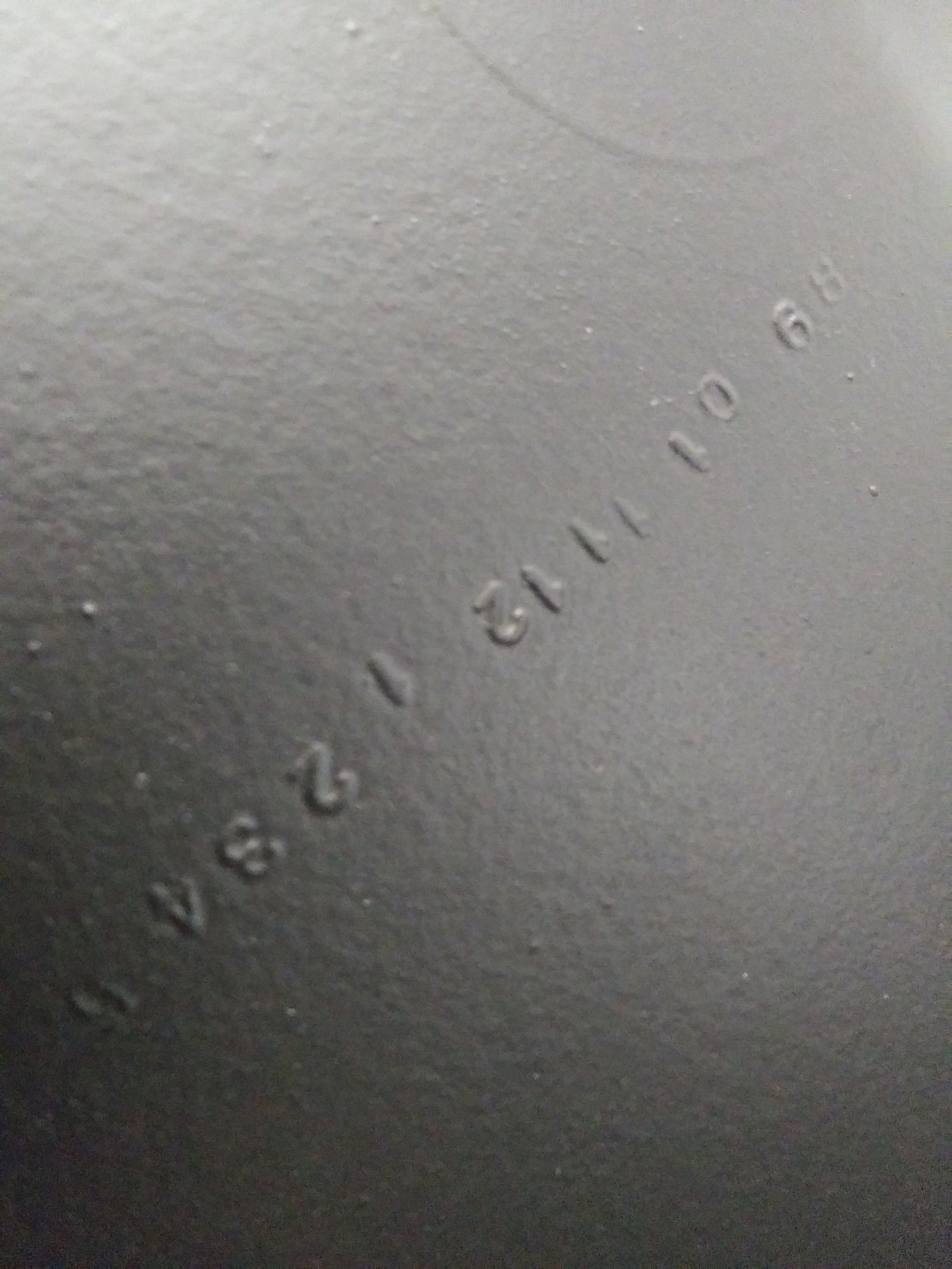

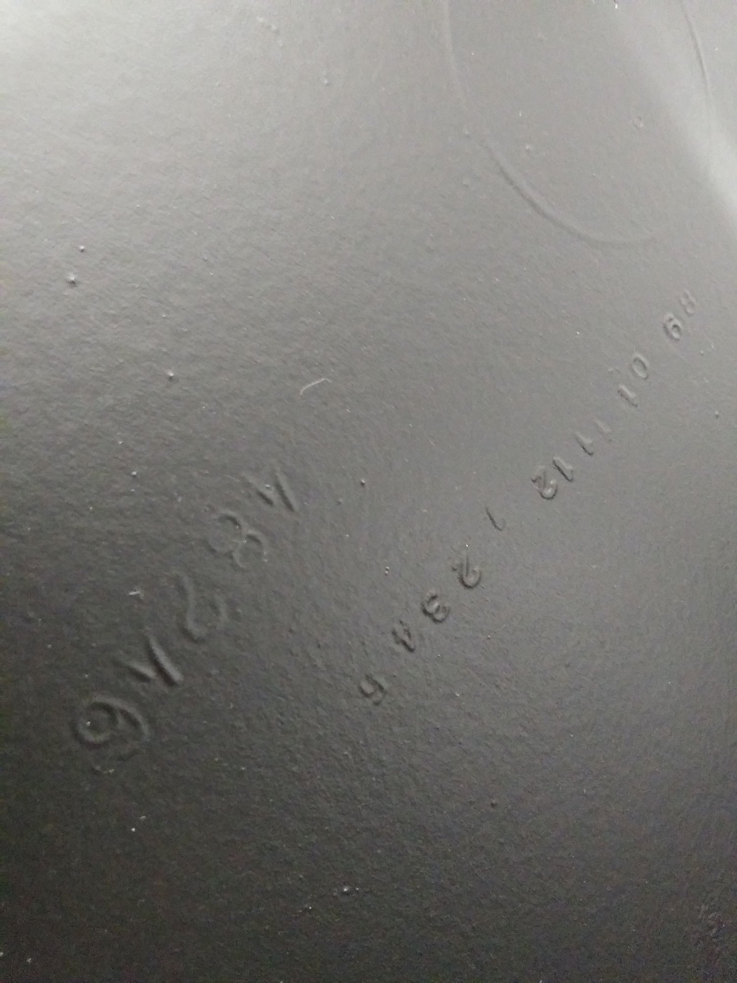

  • So I took the photos....Yes, your hood is the 'analog' of mine. The numbers are the same.
  • You've got some numbers reversed.
  • Some of them ,I think are not used...as in 'check digits'
  • Some of them are mounded in the matched metal die in PAIRS. They line up with each other.
  • Some are individual digits that are rolled over or individually placed in the die...they don't line up and are askew.
  • The upside down numbers = date code= 10-68 October 68...completely correct for an 'Early' 69 (both of ours, ARE).
  • 12345 are I think check digits...not used.
  • 48246 is the part number.
  • 1112 ITHINK is the MFG code number...who made it. I don't think its a 'shift' or time stamp....but others may know.
Bottom line; Correct original 'all is good in the world' HOOD!
69 hood part # and date code EARLY
Enjoy!
UNKAHAL

Just so happens I took a photo of the hood serial number on the '69. Early production DEC-68.
no-AC
unkahal
