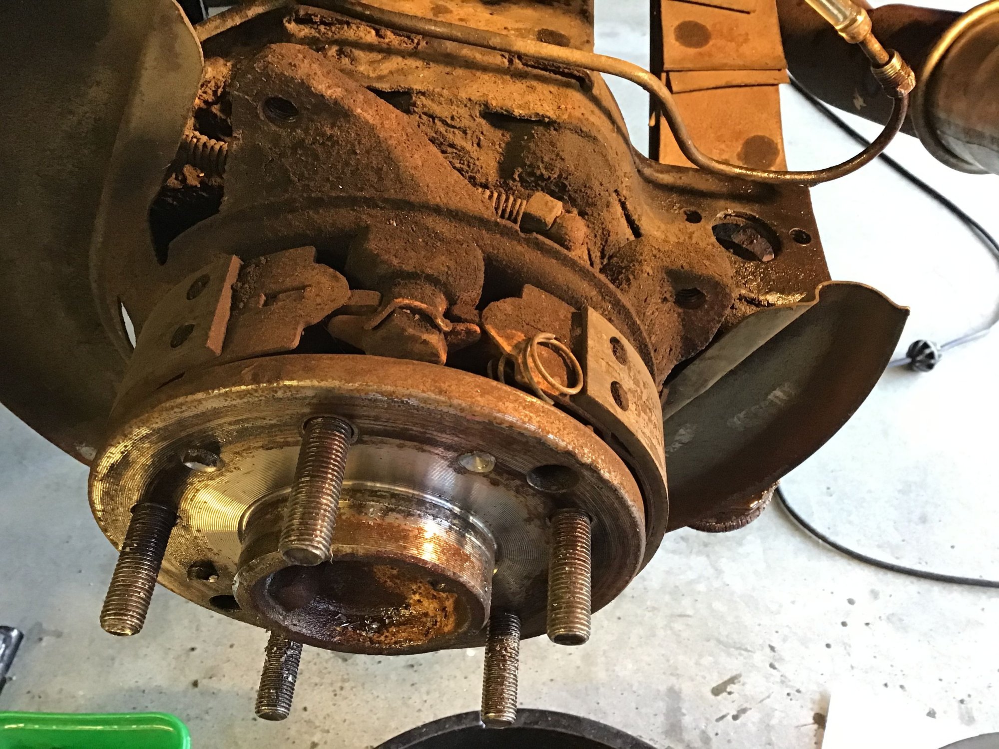

I just bought a 78 that’s been languishing in a garage since 2005. The rear tires don’t want to turn. I removed the brake pads thinking they were the problem and that did nothing. Any suggestions? It acts like it’s in gear but it’s in neutral.

probably emergency brake shoes inside rotor..assuming you meant removed pads from caliper..emergency brake shoes inside drum rotor.

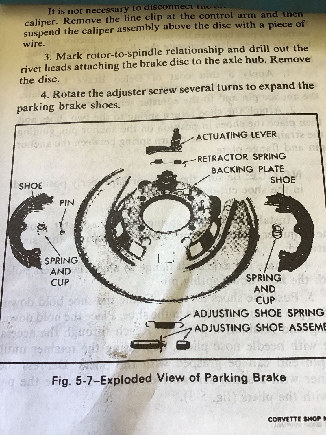

1.There is a hole in the rear of the backing plate to back off the starwheel....it's in the service manual.
2. Rap the rotor edge on with an 8lbs 'lumping hammer'...this will probably free it up.

It was the parking brakes, wasnt pretty but I got them apart and now I have a roller. Thanks for the help!
