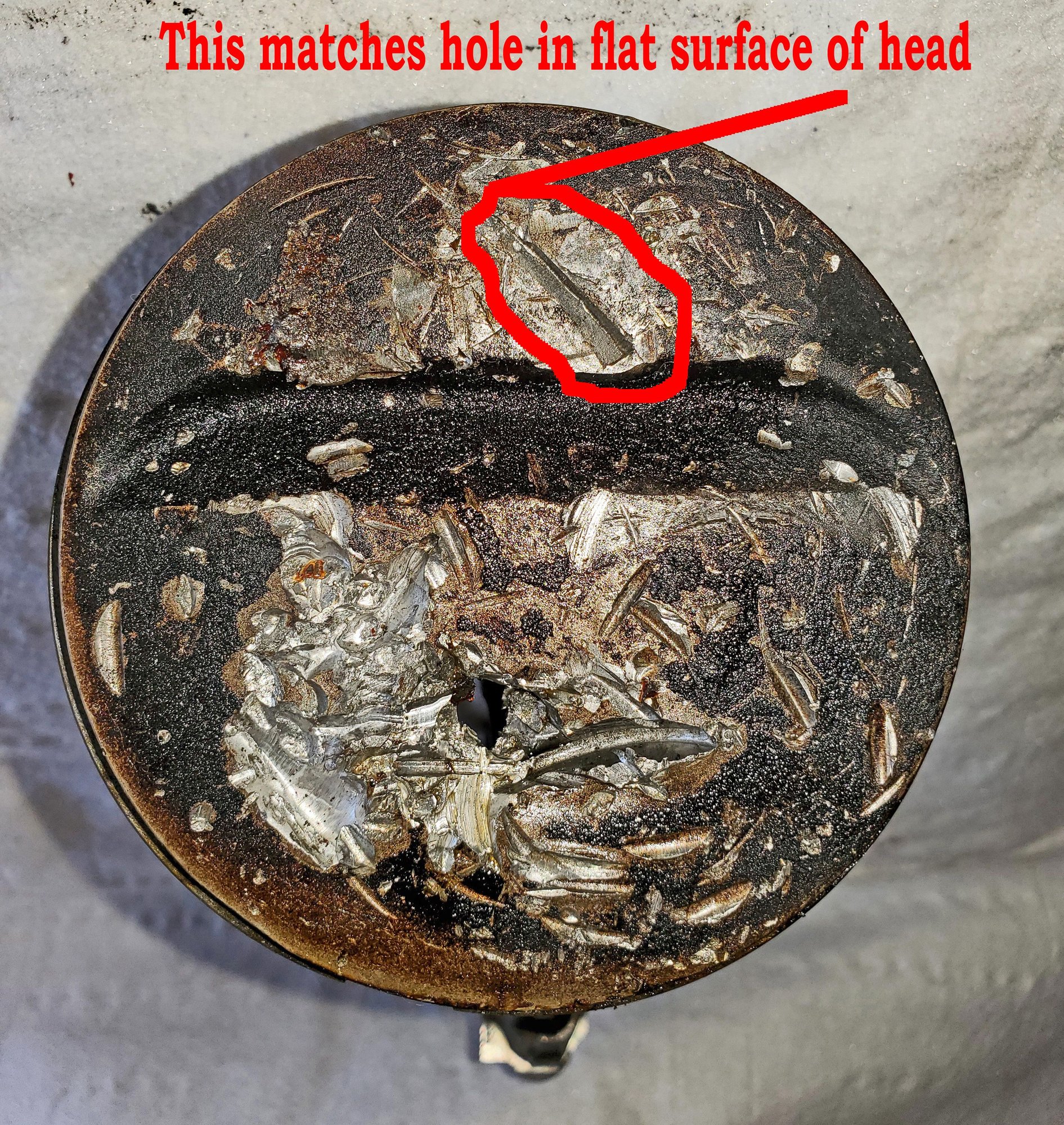

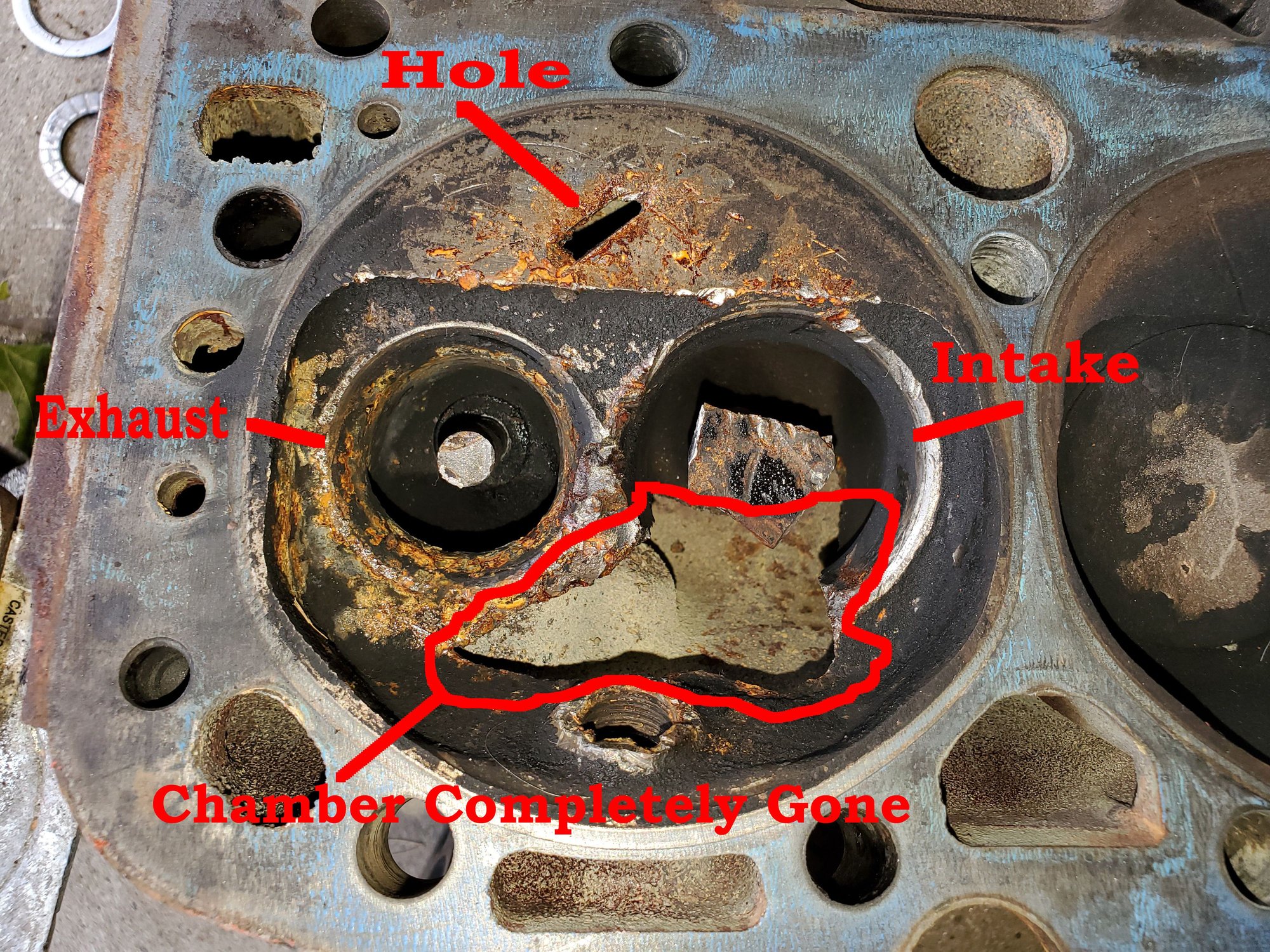

Come on now. let's not be building conspiracy theories, or become paranoid about someone out to get the OP.
Geez. That is not a header bolt. OK,
Somehow, sloppy mechanics, the bolt found it's way into the intake manifold and EVENTUALLY destroyed a valve and pieces of the valve and bolt destroyed the piston.
You know you got a destroyed piston, scarred cylinder wall, cracked block, probably a bent rod.
What is condition of head? Not good I'll bet.
I'm not so sure that I would even look farther. I'd get a new crate engine and move on.
Oh yeah, save the bolt, put it on a shelf, every now and then look at it and mutter a few choice words,. That will help the healing.
This is my cuss-a-lot.
Head cracked in chamber, coolent filled cylinder, hydrolocked, blew the section of chamber away, broke both valves which destroyed piston. bent 3 rods.
But I reused block, did not have to sleeve, and I had a set of heads waiting to install.
Kept piston and rod to cuss at. Hanging in garage.

If YOU can't come up with what bolt that is (7/16" when you are only dealing with 3/8" bolts?????) and where it SHOULD be used, someone else MUST have lost it [or 'added' it] in the carb/intake/engine. There might be a 7/16" bolt used somewhere on the intake and it's assembled parts.
Who is really upset with you??? If you have forgotten your last 3 anniversaries, wife's birthdays, or any combination of those, check your food & drink carefully .
An employee pissed-off at the shop where you had your car could have done it...just to spite the shop. Hope that's not the case, but it happens.

Suggest tamp down the conspiracy stuff; bolt probably an accident.Heck, perhaps it may've been lodged inside the intake Before y'all installed intake ...
... does bolt look like existing intake bolts? Exactly which intake do you have ? make & pn ?
Regardless, you're gonna have to come up with a another motor. I like the above L31 crate. There's a fellow CF member ( bmans vette ) with a hi-grade all-new motor project for sale; AFAIK it's Not assembled.

# 8 puked right? Look down into pics plenum ... see the fore-aft "ribs" cast into plenum floor ... leading to # 6 & #8 ... that's OE iron intake ... maybe yours was similar.

That's what I was getting at, the bolt could have sat in the intake for weeks.
No way it was in the headers and got sucked bavck into the head. There is always a pulse exiting down the pipes.
Stuffed into a spark plug hole. That would have destroyed the piston on the first turnover. Not weeks later.

One thing jumped out for me is that bolt size is not measured by the bolt head that the OP showed with a wrench on. Bolt diameter is measured by the outside diameter of the thread or shank .

I doubt it's an 11 mm bolt head, either. Measure with calipers, and check the thread count with a tool, or compare against taps in your tap set. Even if all of your intake bolts are in place, I bet that's what it is...

The problem I would have with reusing this block is that it is cracked. Yes, it can be sleeved, but a cracked block is still a BIG problem and could cause problems down the road.
And if he was to just to get a short block, at least one of the heads is junk. So block and heads at least,
How many rods are bent? Crank? etc.
Might be less money to drop in a crate 350.

Apparently, (OP's post # 5) his OE motor "gave up" after 100K miles and perhaps is rebuildable?
Seems the motor which just suffered bolt calamity was a fresh crate motor.
Perhaps that catastrophe can be sleeved with requisite decking ...
... also replacing head/piston/rod/crank etc as needed And fully rebuilt ... but certainly not for $2500.
