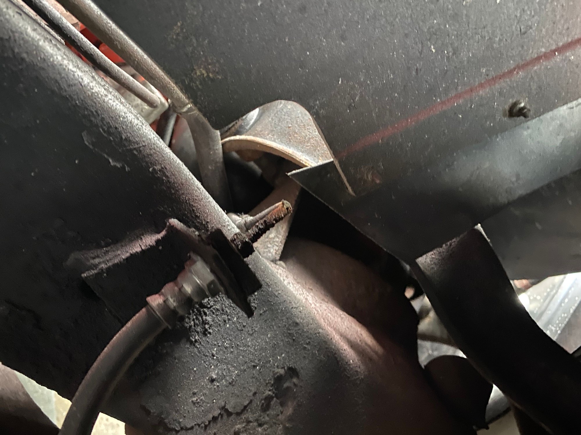

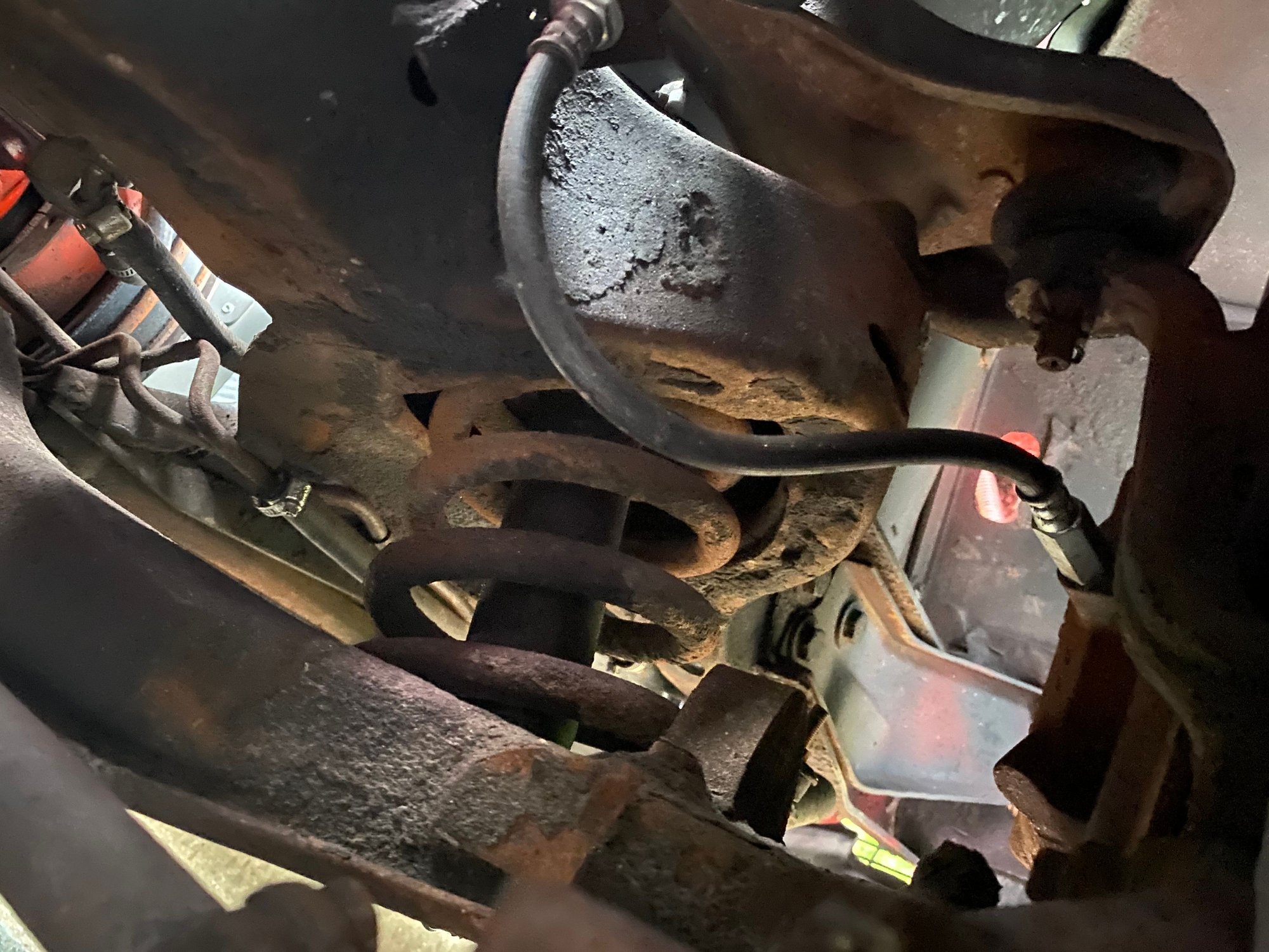

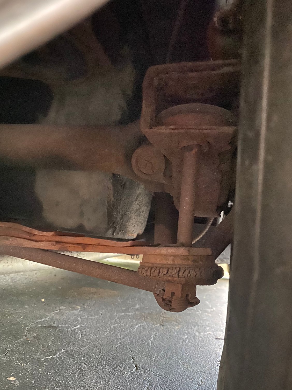

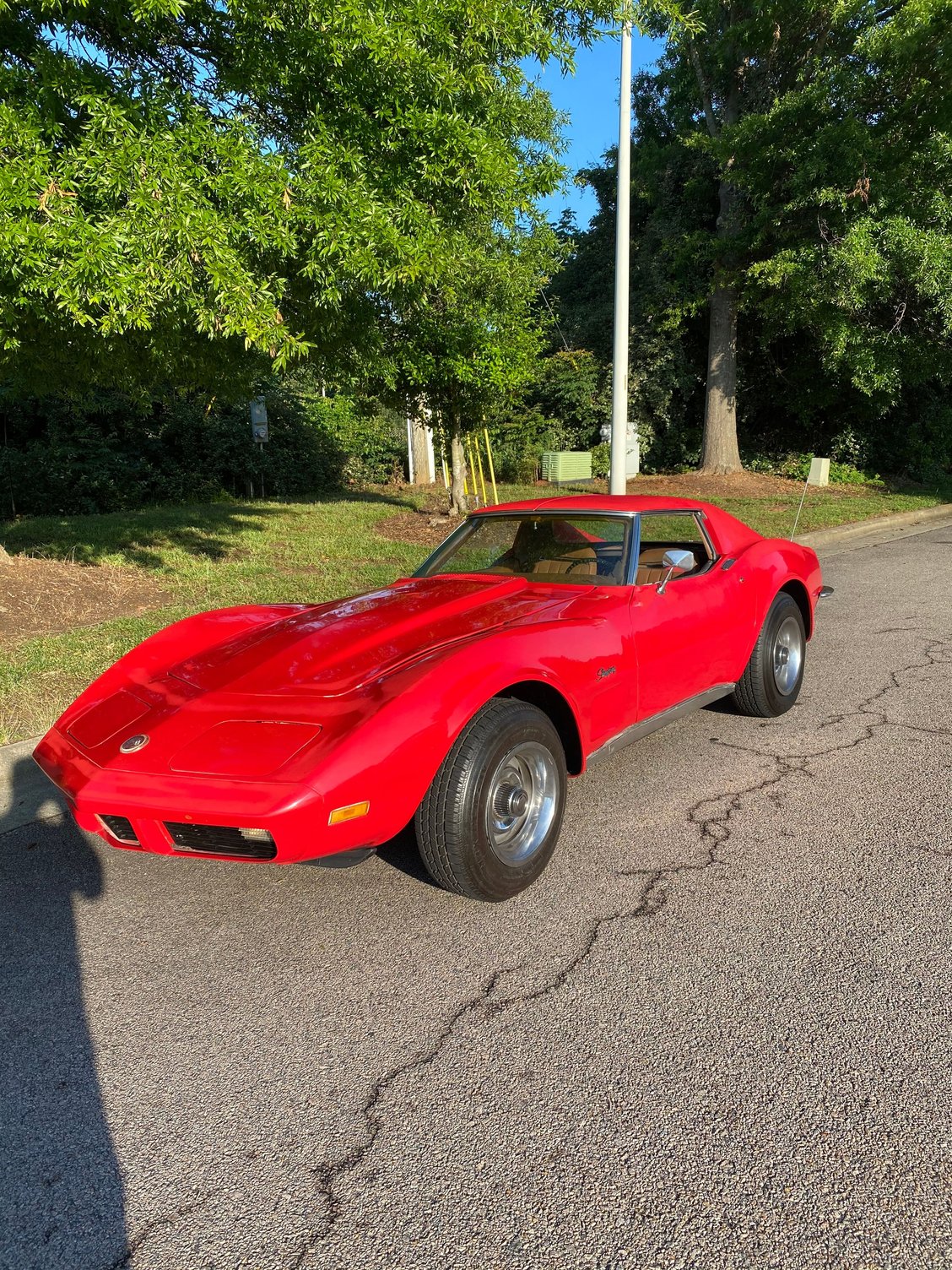

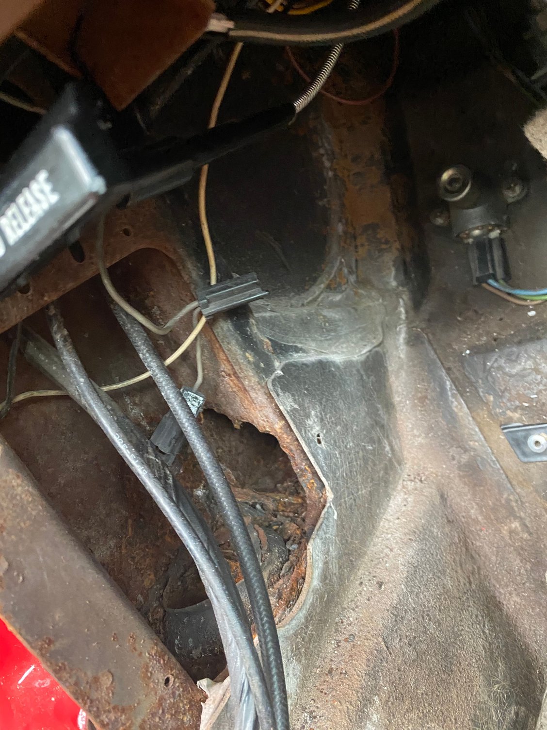

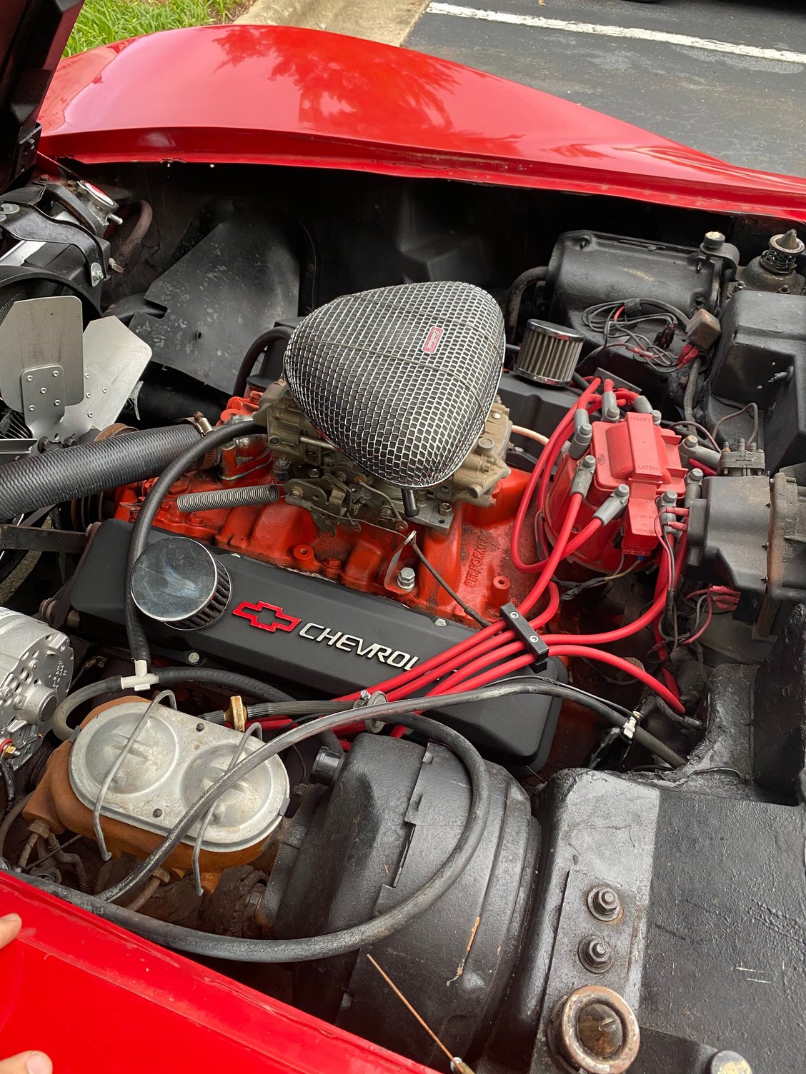

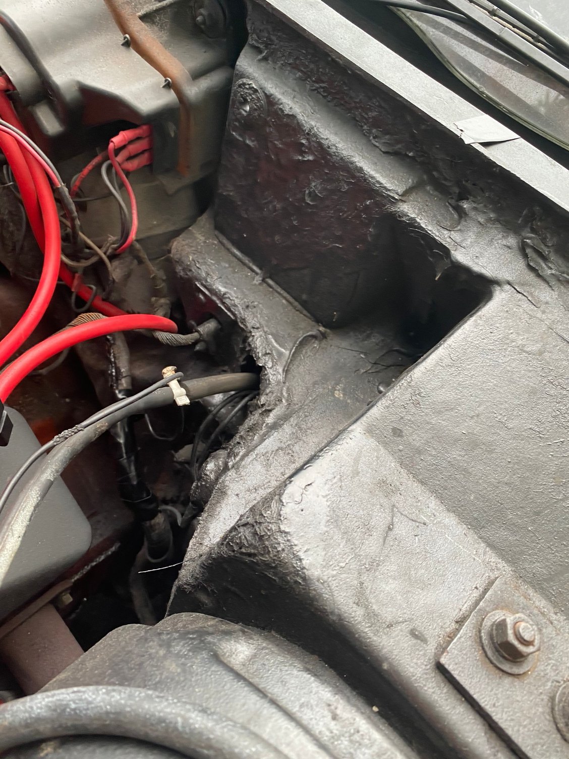

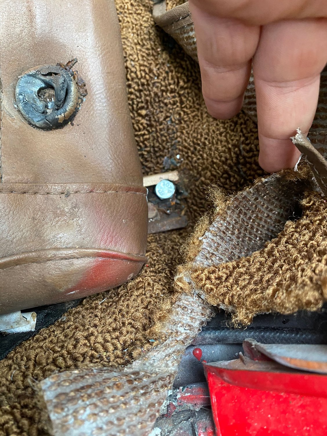

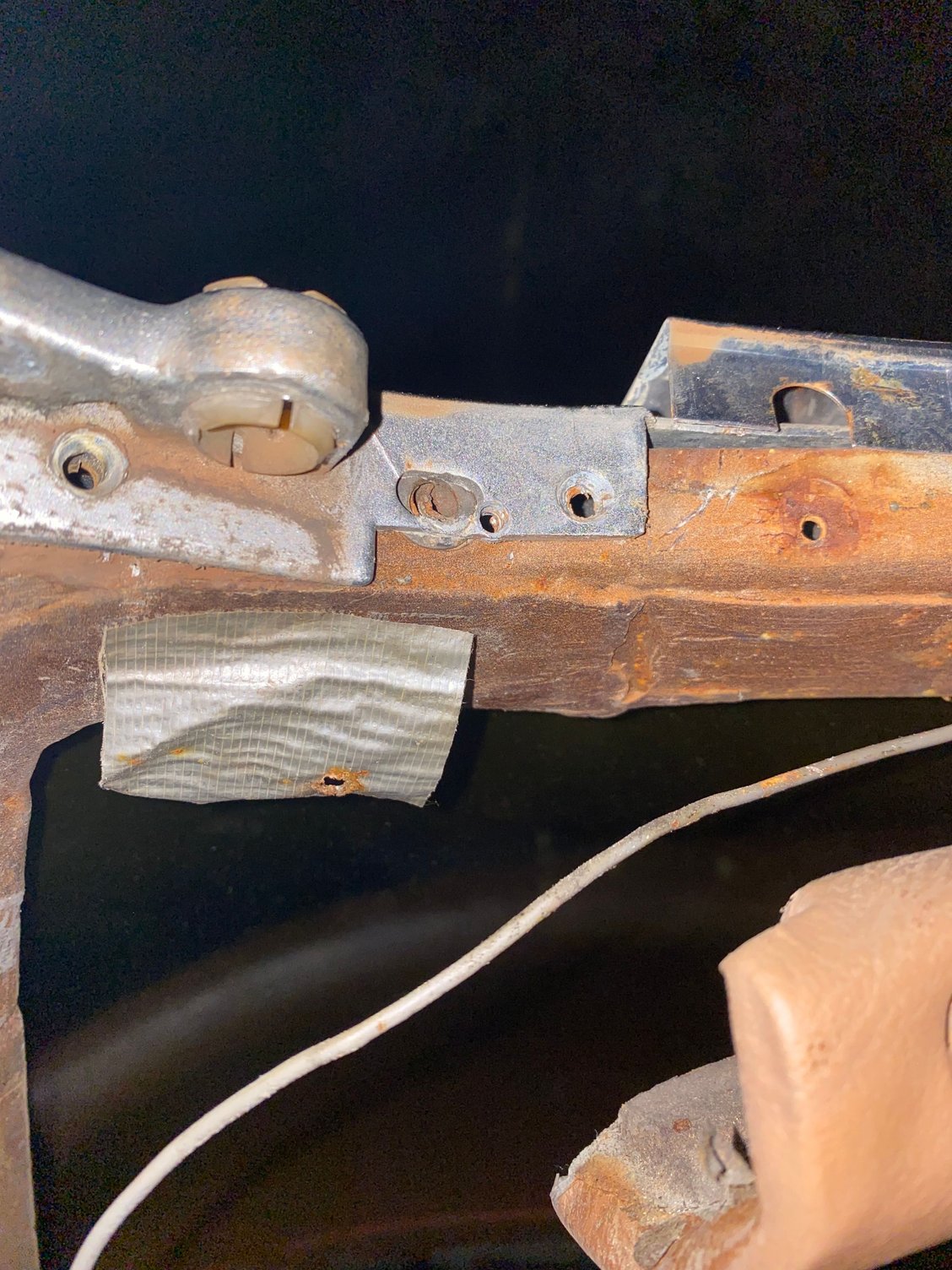

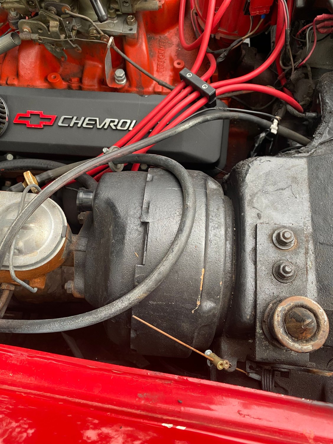

Hey guys, I just purchased a 1973 vette for 8500. I was looking for a nice car just for cruising, weekend rides, maybe some trips to the mountains. I was looking to spend about 5000-6000 over the span of some time slowly fixing some stuff myself.
I looked at a few and ended up purchasing this one, I wish I had came across this forum or read the 10 rules stickies. I knew the car would need electrical work, all new harnesses as gauges and some components did not work. As I’m spending more time reading the forums and inspecting the car better I’m finding some issues.

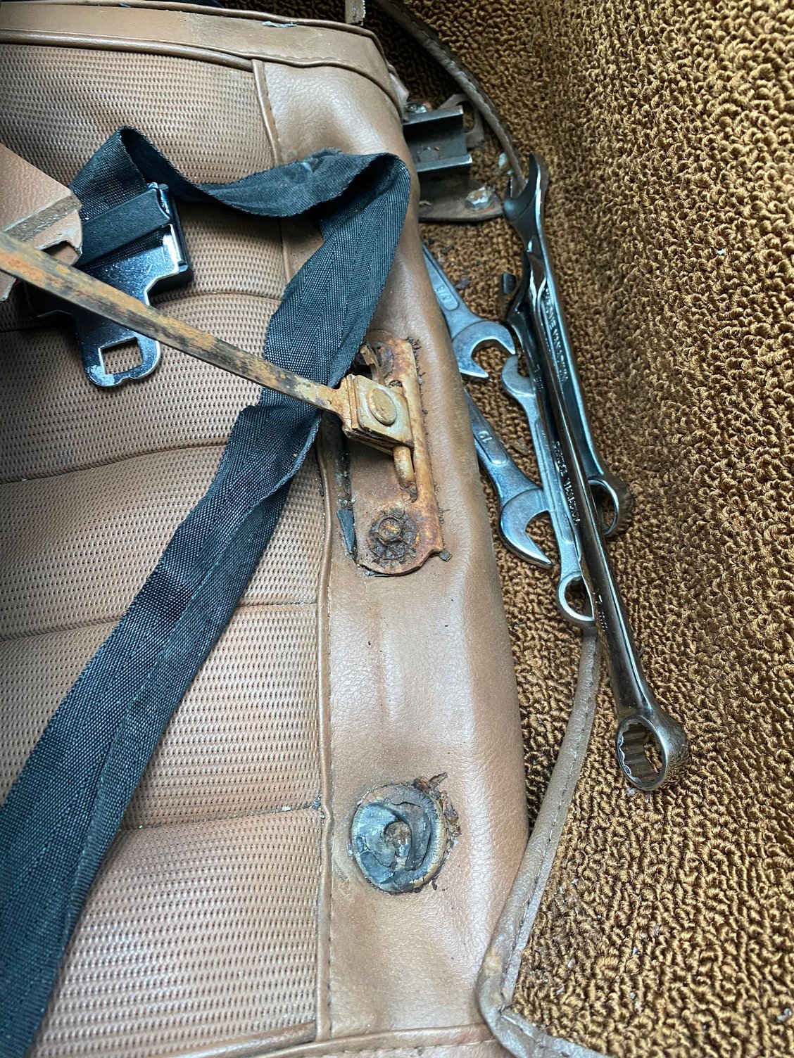

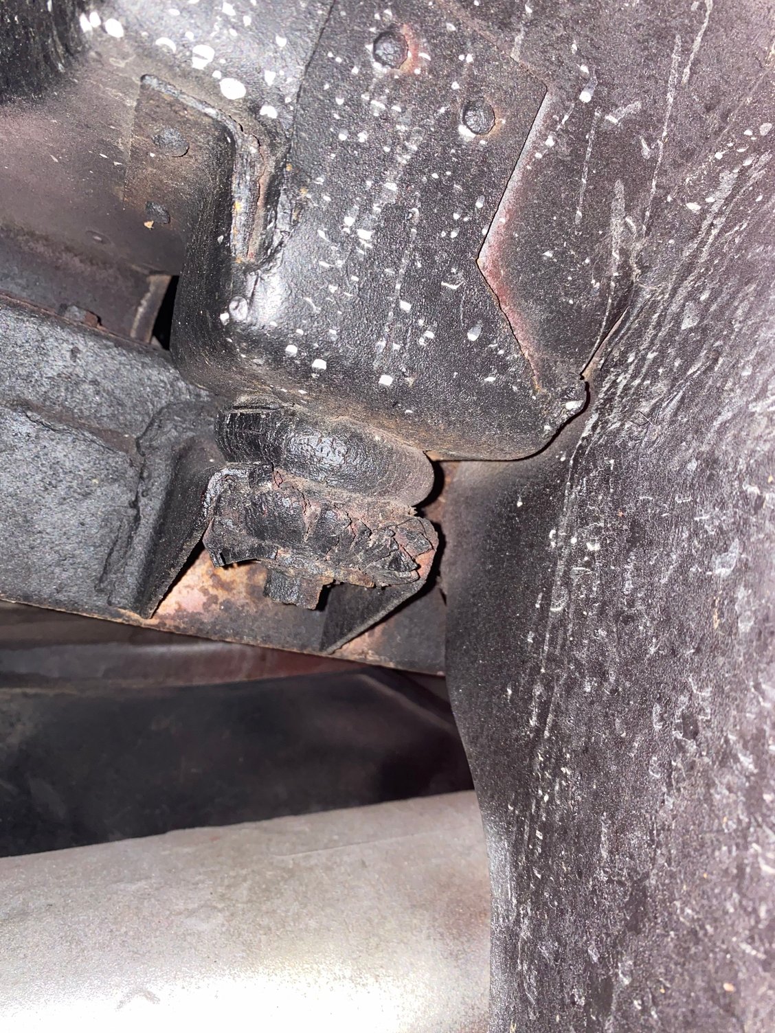

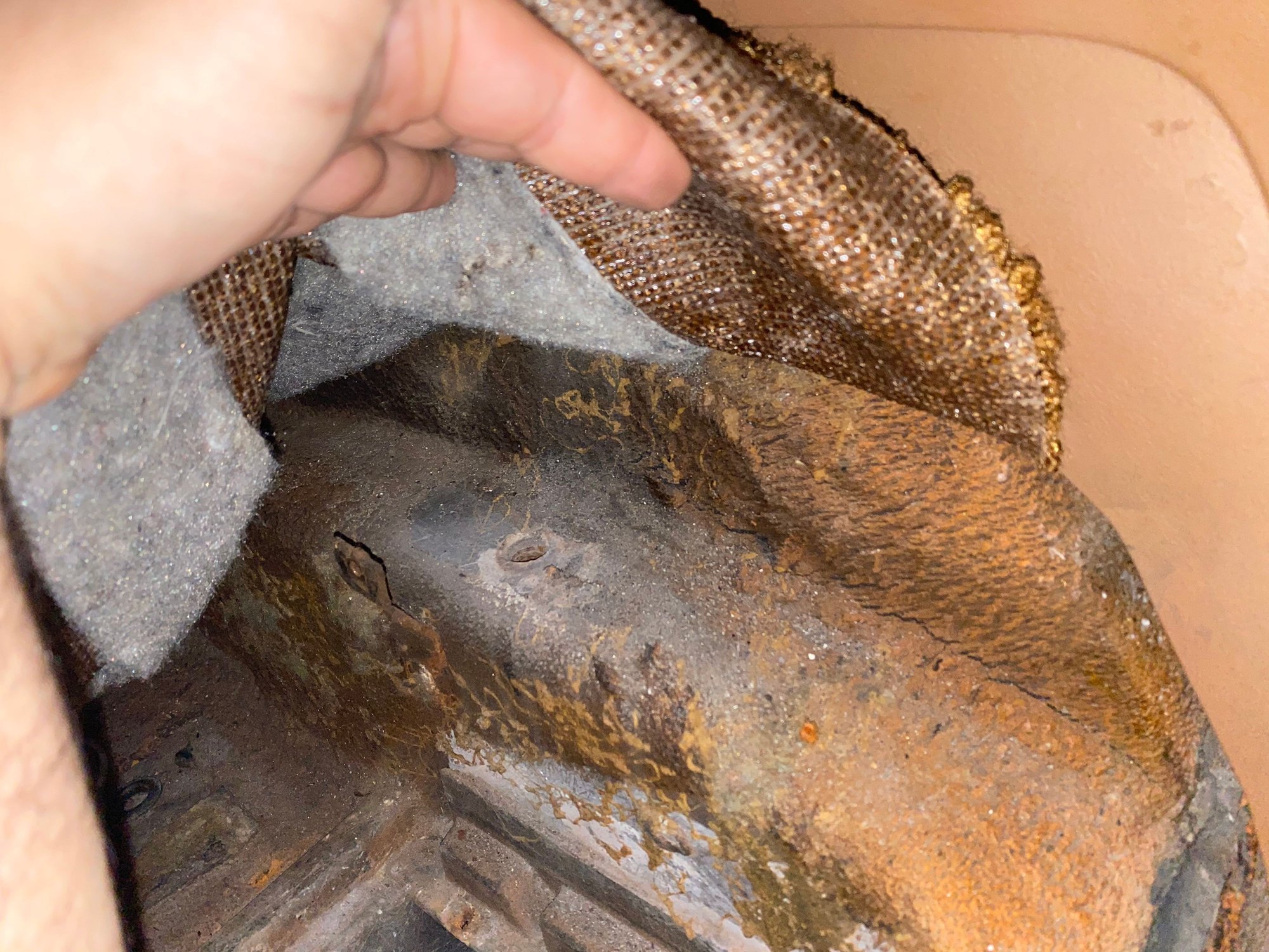

in regards to rust I check the kick panel and sure enough it’s rusted bad, the suspension is rusted and some areas under the car. No holes in floorboards, but removing the carpet I found the seats were bolted down with new holes and holes drilled thru the railing. Looks like previous owner painted something over certain areas. I can do a good amount of work myself as I worked on a 1987 camaro. I plan in doing all the wiring, and ripping up carpet to put in insulation and new carpet done right.
Any tips on handling the rust? Any thoughts on condition from the pictures I’ve attached?

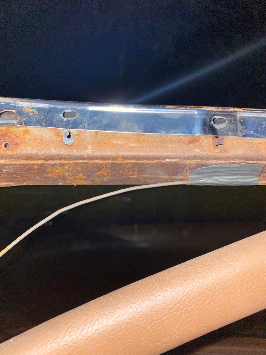

I inspected sone more, it looks like someone tried to
stop rust or prevent it. Some kind of material has been sprayed over bottom and certain areas that hardened up. On the bird cage I can’t tell, does it look like something was done to it or does that second plate belong there.

IF it was my car, I would do a complete body off restoration. Unless you do that, each individual problem will rise to the surface, a little at a time, and will always be a continous nagging issue till you get tired of it and sell it. These cars are old. Either way, if you are going to do it right, it will cost many times more than $5000 to have a reliable quality car to drive.....if that is what you want. IF you just want a garage queen to look at occasionally, and drive to parking lot car shows, you could milk it for a long time, if you have the patience and a tow truck company phone number.
Sorry to sound negative, but its the truth. And you should not consider the restoration a bad thing. I enjoyed mine. I would love to have your car to rebuild into a fantastic car.

Oh my man.... you have bought a nightmare. Do yourself a huge favor and bale on it. Sorry.

Sorry but it looks like a flood car😖

Heres the thing... if you store the car indoors and only drive it on nice days it will likely remain in that condition or close to it for many years.. and you can use products to coat and slow it down even further... so if your just looking for a car to have fun with an use as a sunday driver your probably fine (may want to have someone check it over for safety concerns though) If your looking for a car to restore and get resale value out of it that will be higher than what you paid then I dont think this is a good starting point. My 74 has rust but nothing close to that and I paid 2700 for it but the tradeoff is it needed everything else redone like engine,interior bodywork and paint.. It really is about what you want out of the car. some of your pics like the adhesive spray under the carpet are totally normal to see for cars like this and the "damage" is cosmetic.. other areas like the base of the birdcage in front of the doors look very rough from water leaking in at the base of your windshield (which is a common problem on these cars)
BTW the floors in a 73 (as well as a 74) are fiberglass... I believe they went to steel sometimes in 75 so at least your good there if its not rotted. again that brown stuff under the carpet is something that was sprayed onto the fiberglass as carpet glue or possibly sound deadening.
It doesn not look like flood damage to me.. just a car thats seen and sat out (possibly on a stone or dirt driveway) in rain and a leak at the base of windshield which caused the interior to act like a humidor..
