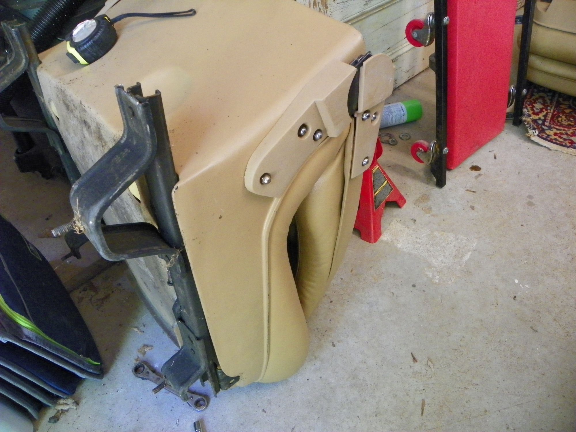

I just bought 2 seats for my '72. I was told they were '71, but I think they are '78 or later. One seat has a stand-off mount, while the other doesn't. Which is driver and which is passenger? Any advice on conversion?

Based on your pic, you have the 79-82 clam shell style seats. There is no left or right, they swap unless you have the 81-82 power driver's seat..

Thanks Mike, but note that one of the seats will set about 4 inches higher with those "legs"

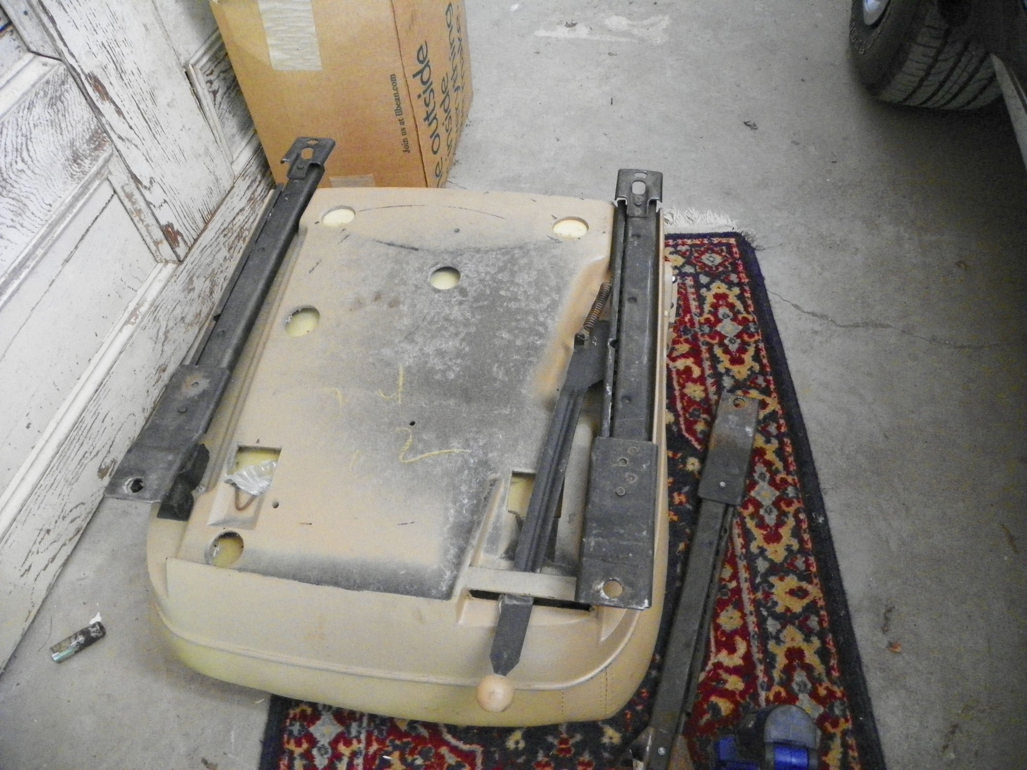

Use your 72 seat tracks on the new seats.

Got it. Thanks, and that's what I decided to do. I stared at both for a few hours and finally figured out how to remove them. I had to put spacers under the front of the old mounts because the new seats don't have flat bottoms.
