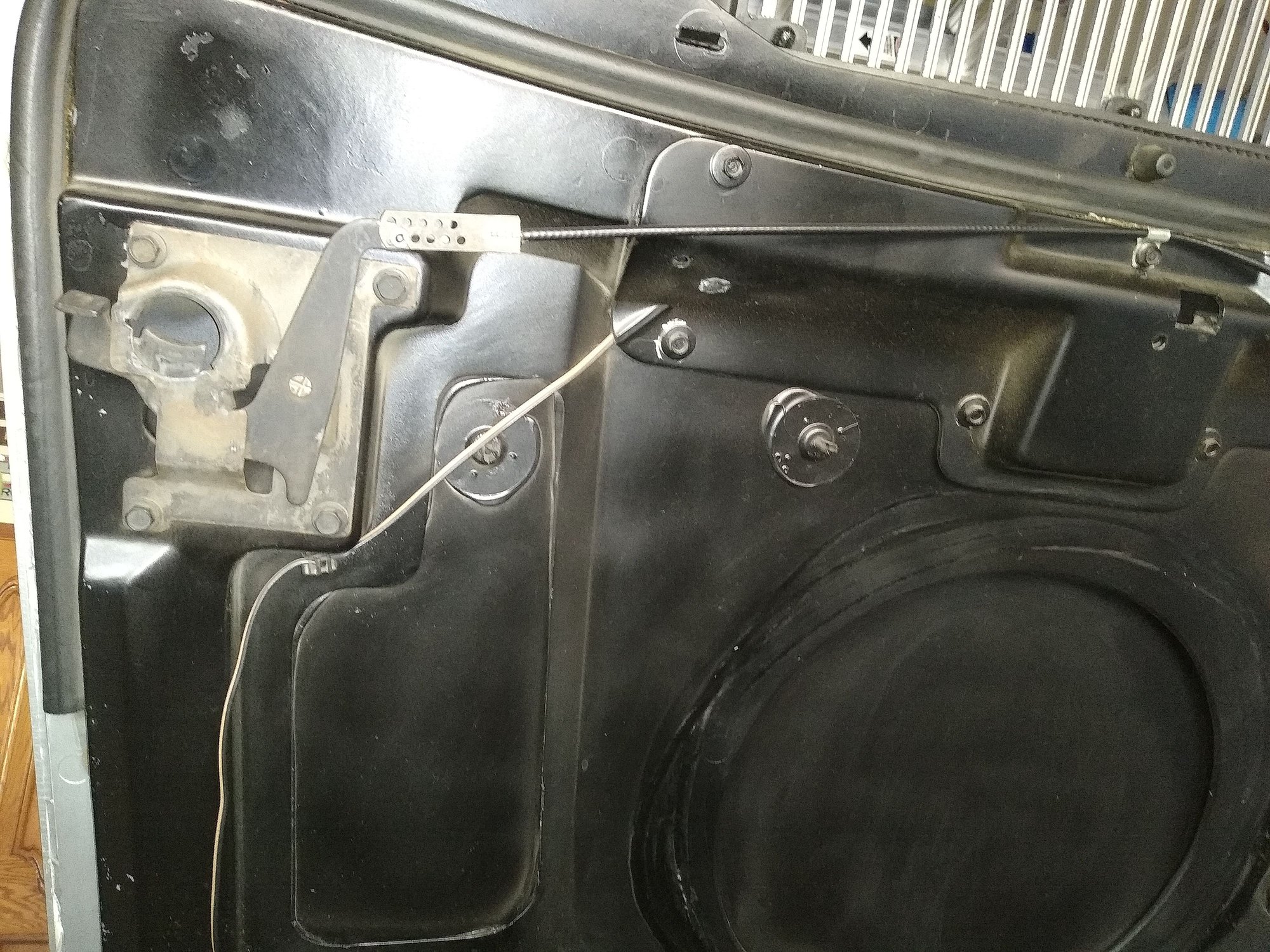

Can anyone the purpose of this wire ? To me, I would guess its some sort of hood light. Have no idea where it plugs into and if it is a light, it doesn't seem to have a bulb of any sort. the wire runs from the plug and up the hood and seems to end at the top center as in the pictures.

1973-75 cowl induction damper actuator power supply

Looks like yours is missing the actuator (located under the plate located at the rear center of hood in your picture) should have a 2 conductor wire with two plugs on it that runs along the drivers side of the hood to plug into the plugs in your picture

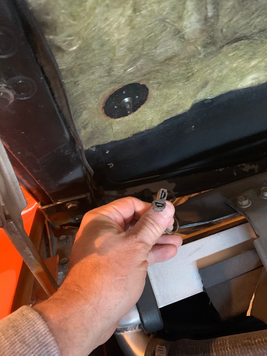

Hello Vinnie--always glad to help a fellow '75 owner.

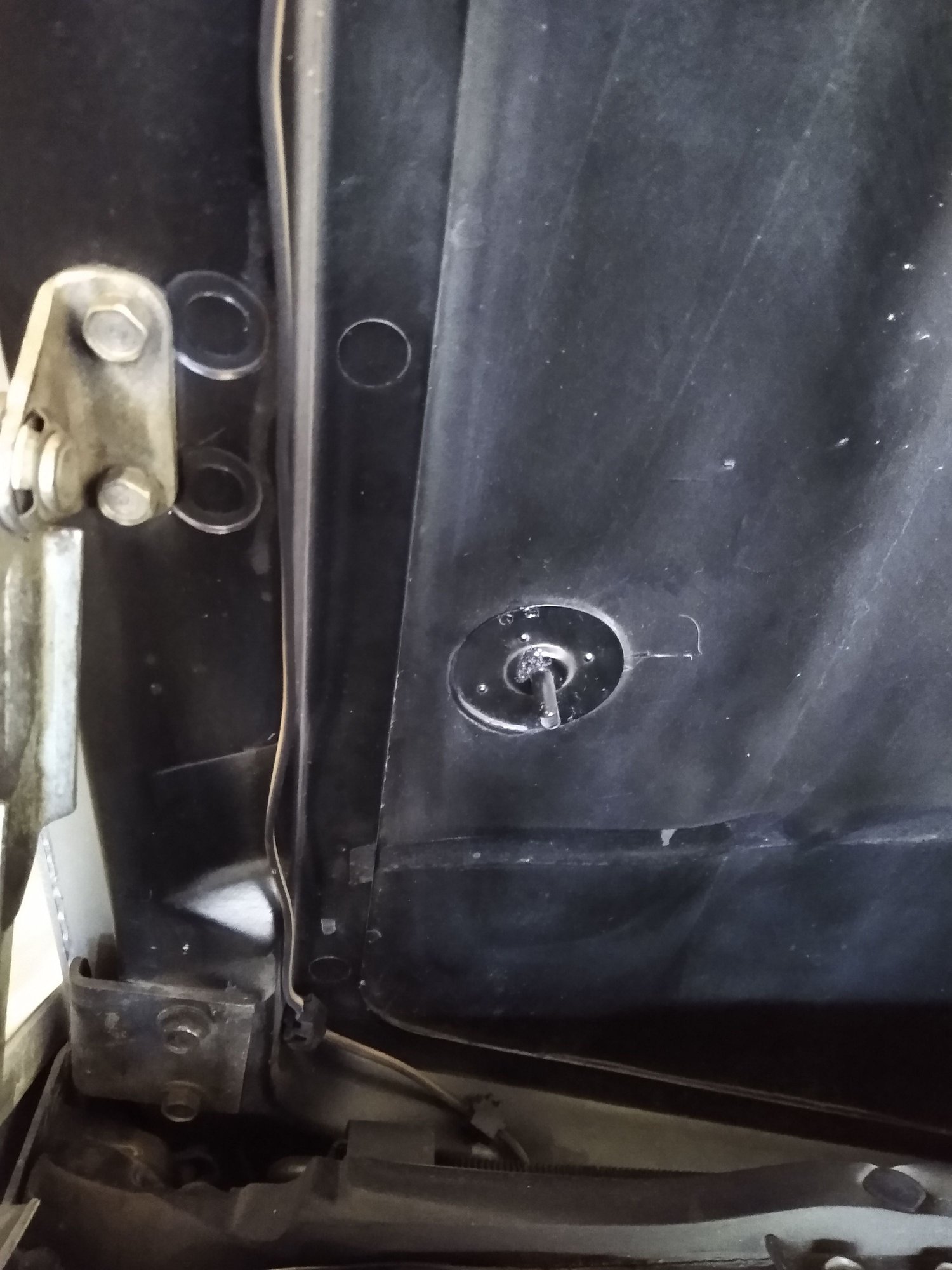

Here are some pics from my '75. Hood insulation has been removed to make it easier to see the harness.

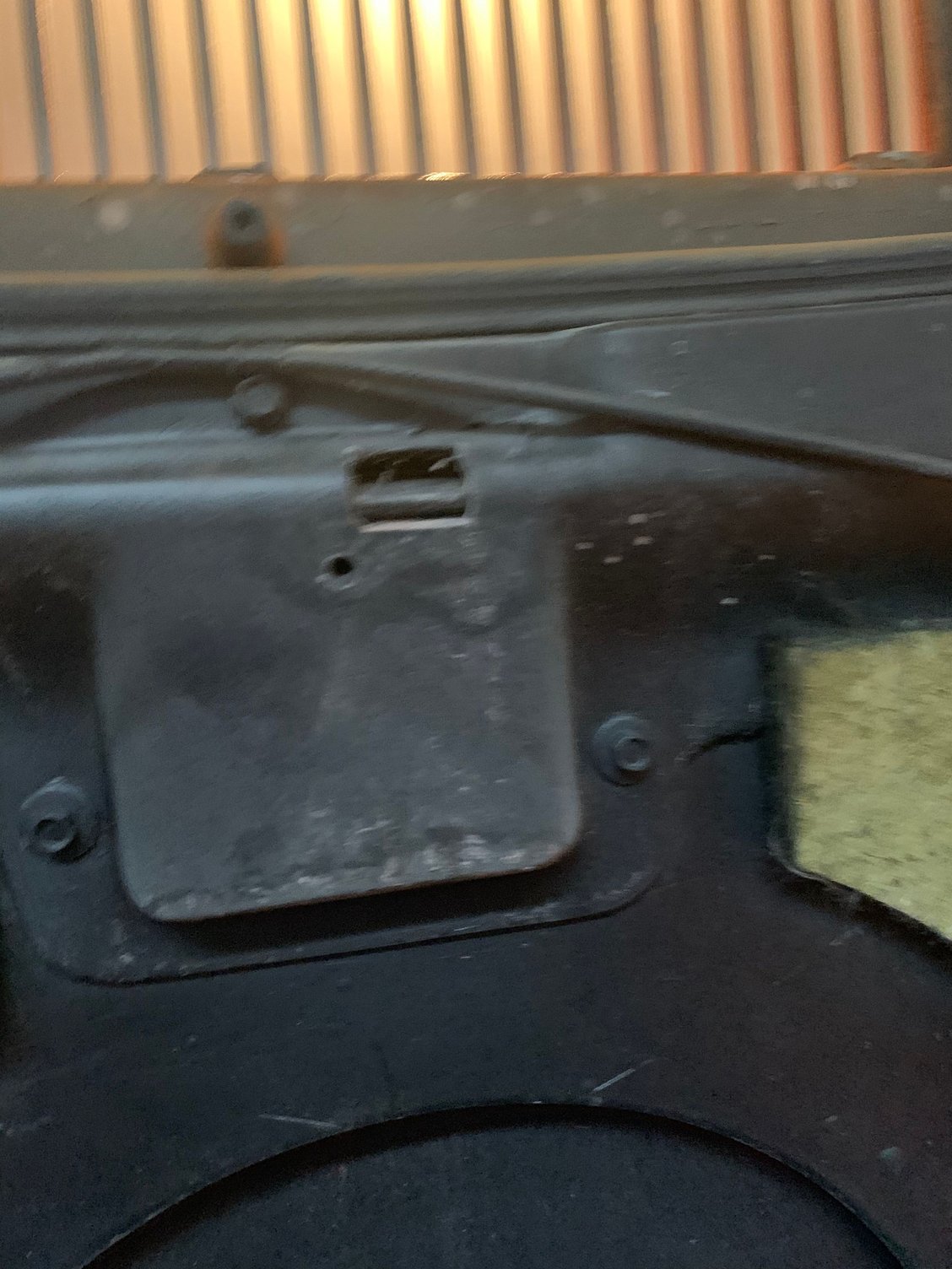

The two-wire harness plugs into the connector you are holding into your hand. The harness runs up the drivers side of the hood, turns towards the center of the hood and is tucked under the plate that holds the cowl induction actuator and damper. There is a bump in the plate that allows the wire to run under it.
Wiring is to the right of the hood support
Wiring is to the right of the hood latch and proceeds diagonally to the damper/actuator plate
Remove the 6 hex head bolts to access the damper and actuator.
I hope this helps.

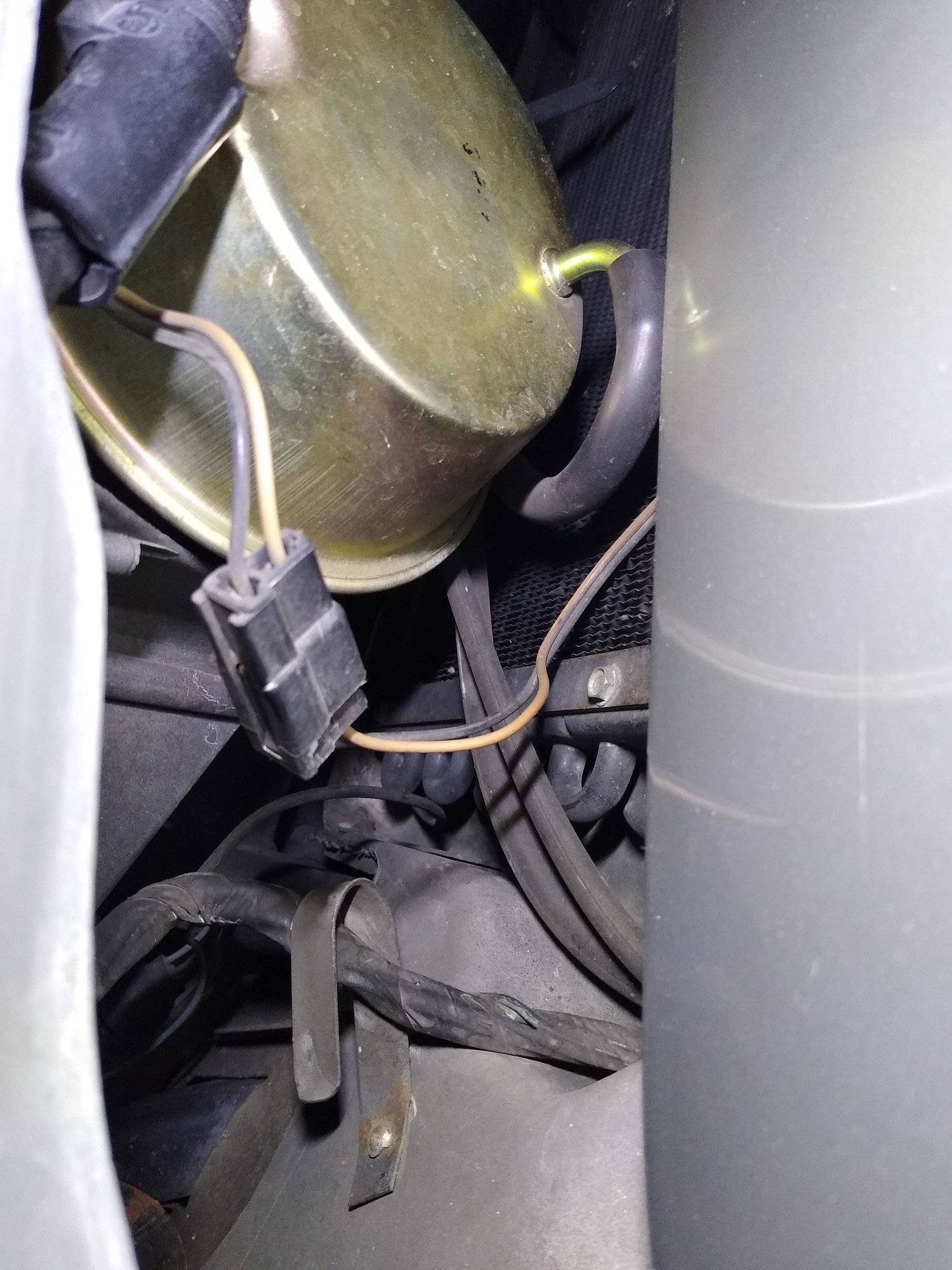

VinniePG had asked me via PM where the cowl induction air damper actuator harness plugs in. I though I would share with the Forum.
On my '75, it plugs into the connector located above and to the left (as you sit in the driver's seat) of the driver's side headlamp actuator. With the hood up, the harness runs down the hood, under the front edge of the hood and plugs into the connector shown in the pic. It plugs into the same connector in the same spot on my '73 as well

I think i am getting closer. my car looks exactly like yours, removed the padding and wire runs up the side and under the cowl as you described. I see your connection, my car is not original. the previous owner had the headlight actuators removed and replaced with electrical components. As I look at your picture, the connector i have should plug into the black & white connector. That is what I do not see. is the B/W connector in the engine harness? I will look to see if the wires were cut off. Also, how does the system work? what turns it on?

Hello VinniePG--The wires are a black wire and a tan wire. The connector is black. The forward wiring harness runs directly underneath the front surround. It contains the wiring for the headlamp system, parking lamps, side marker lamps, the horn, and this cowl induction damper actuator. Look up from underneath the front end for this harness. Look for the tan wire (12V) and the black wire (grnd) coming off the harness by the driver's side headlamp and terminating at the connector your are looking for.
