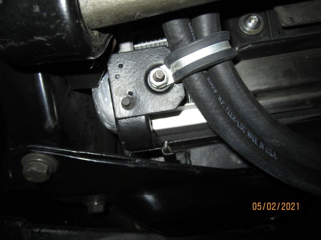

I need (want) to remove the temp sender from the passenger side head and just block it off.
Changing the beer keg at the same time as well and tidying up some of the hoses (because that's what you do when you change the oil-pressure gauge line....)
So I need to drop the coolant level to at least that point and as I recall the drain on the rad is in the least accessible spot available and usually just pours out all over the cradle and everything as you attempt to drain it
Sees to me last time I needed to do anything I siphoned it out of the rad by removing the upper rad hose instead, then out of the keg, unbolting the keg and dropping it below the heater core to drain the lines, the.... etc etc etc.
Seems to me last time I did this I swore I was going to put a drain fitting in the engine block...
Anyway, just getting per-frustrated for the afternoon
M

Yeah mines on the bottom under the lower hose so it's a PIA to get to and then there's no way for it to pour out, just all over the support, a drain on the face of the other end would have been nice.
Lower rad hose I've done as well, BB so again, not much flippin room and it pours over everything until you get it pointed at the tray.
I'll be doing the rad method again this time, just a pain
(First world problem)

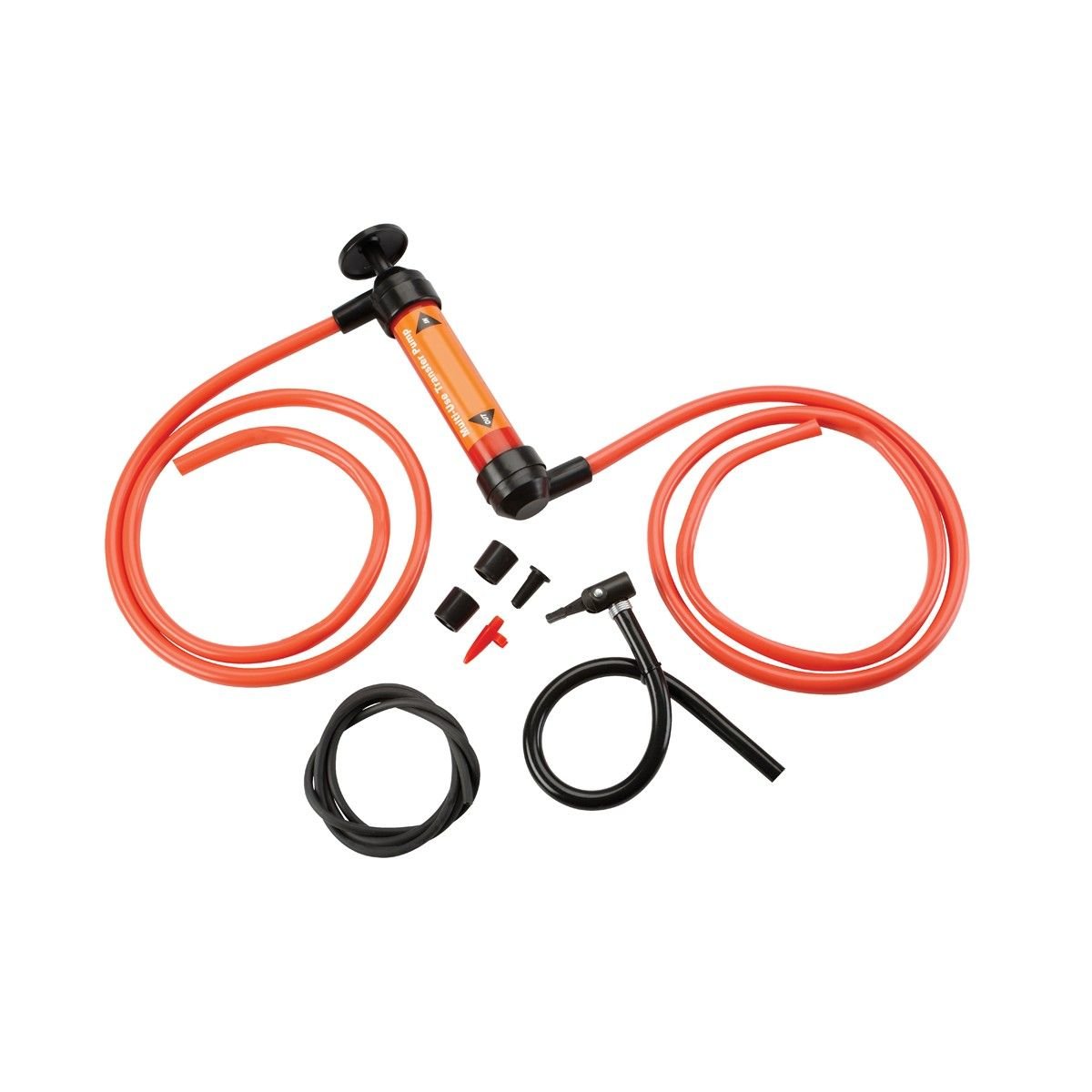

For you guys with radiator caps;
Got to Harbor Freight and buy 1) 36" Pickup and Reach Tool $1,99 and 2) Multi-Use Transfer Pump $6.99. Now cut both end off the pickup tool and you have a hollow tube, connect the inlet hose of the transfer pump to the tube and drop that into the radiator. Take a clean Lowes bucket and pump the coolant into that. Takes all of 10 mins to empty the radiator and most of the block, you can refill the engine with the same coolant through the T-Stat housing. Use a Fel-Pro 35562T T-Stat housing gasket to make this even easier.
Been doing it this way for years.

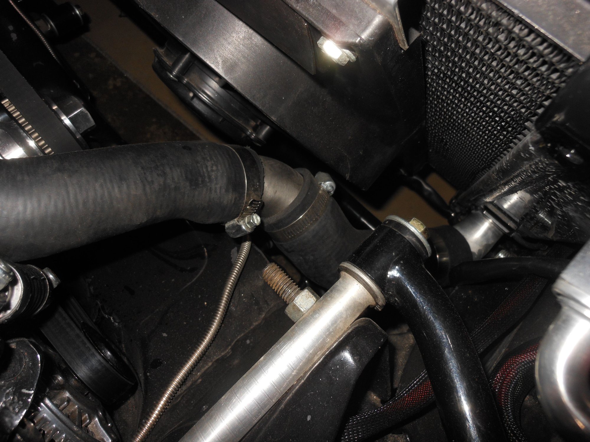

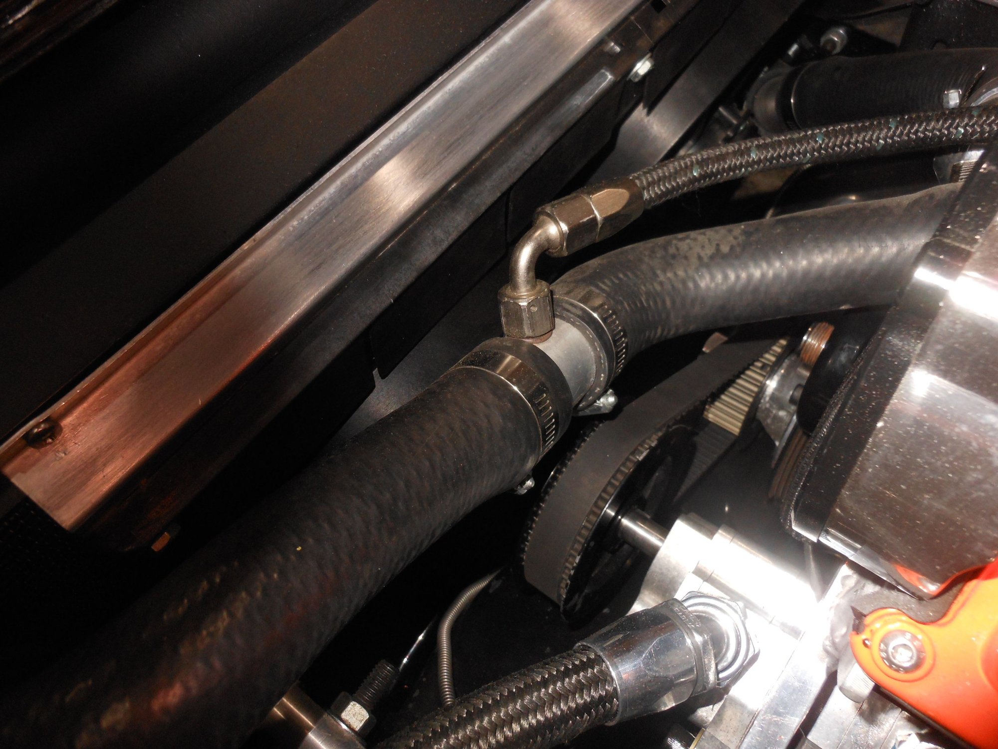

Here you go- simple solution for the Big Block radiator-
I just put a a brass plug where the petcock was and added this-
Also helps out with the possibility of the hose collapsing.

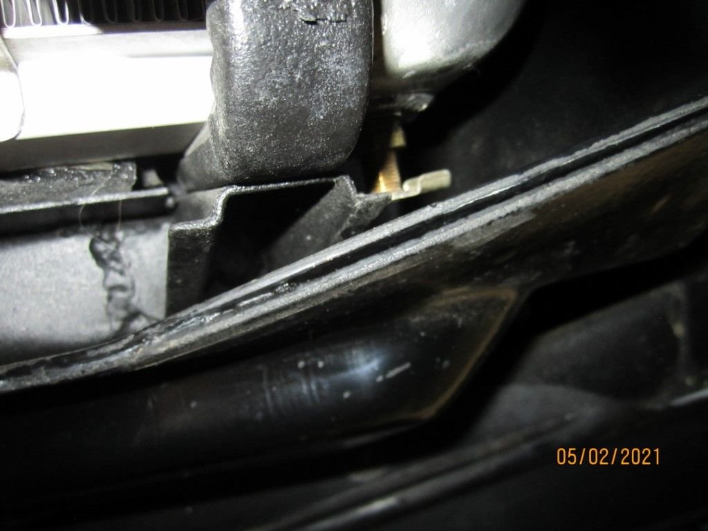

Wow the 68 actually has something right over the later years. The 68 points to the rear on the drivers side and the shielding is shaped so you can get to it. On the passengers side there is a removable piece of tin you you can get in there and tighten the radiator hose clamp on that side.
If it where me I would put and elbow in and a petcock in the end of it if I had that set up.

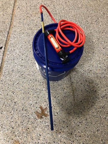

[QUOTE=Mr D.;1603391779]For you guys with radiator caps;
Great idea. Picture of finished product?
The drivers side is better but not great
If I ever have the rad out again I'll have to think about running an elbow out to a better spot... not that I plan on having the rad out again any time soon but with the way I seem to work who knows
I also have some vague recollection of wanting to pull the block drains and replace them with brass plugs or even valves but then calmed down and left it alone
Anyway, just another simple job on most cars that are a different on our beloved C3s
M

This does look a possible solution for my trouble with draining my big block with ac. I assume you cut your lower hose in half and splice this device in? Has anyone done this yet? They come in black also btw.
I used one for my steam port- big block Dewitts rad and support -but not a Big block.
Next time I drain $50 of coolant out I'll upgrade to it. I already removed/replaced the useless rad petcock already- and was just going to undo my current coupler to drain.
Pretty Basic
