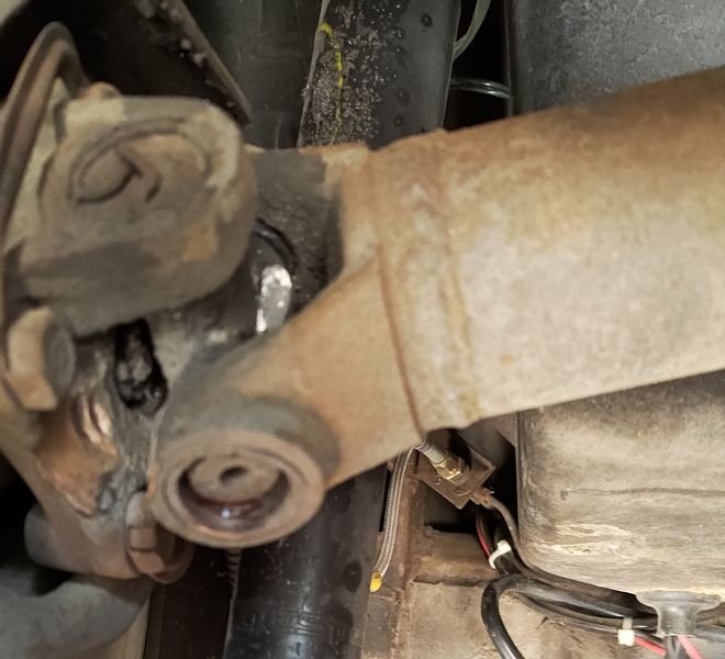

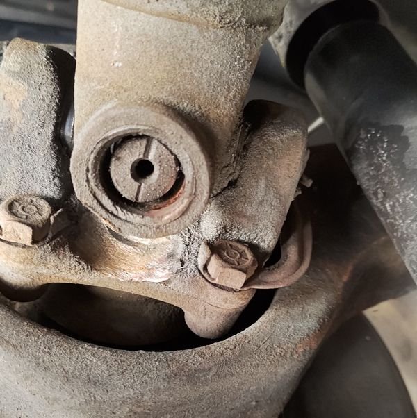

If my battery cable issue wasn't enough, my car has also developed a pretty bad negative camber on the drivers side. While I had it on the rack I was looking at the back tire, and U-joint is shot. It looks like a retainer pin came out and the cap fell off.
Its pretty loose in their.
Can I just order a Ujoint (I hear good things about Spicer) or do I need to order retaining pins, new caps, etc?
How big of a job is this? Can I do it directly or do I need to remove the spring and everything?
And I guess it isn't really driveable? I only ask, because my kid asked me about a car show at his school on Thursday, but its about 15 miles away.
Thanks!

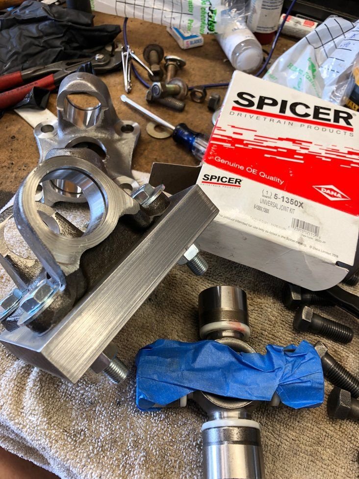

great advice below and generous offers.. as tampa says use a backer..
if helpful here is my replacement job
https://www.corvetteforum.com/forums...anual-l82.html
Thanks, that was a great read. Definitely have to get the backer.
