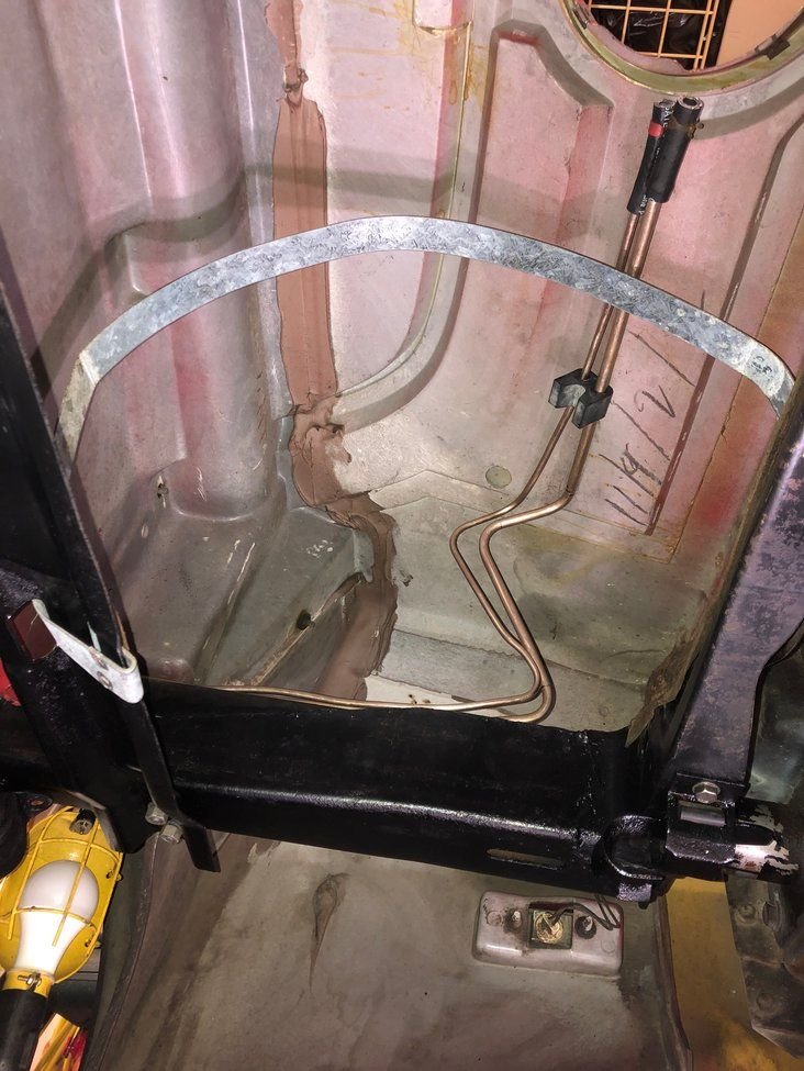

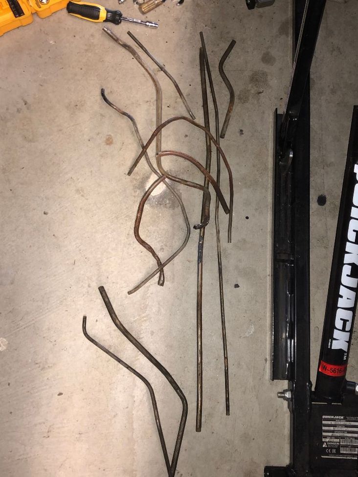

no clue how much difference in 79 to 69 but i did not lift body. Nicop lines and a connection or 2..still leak free..
Save your old ones for bending like oem and it gets you pretty close.
around post 130..
