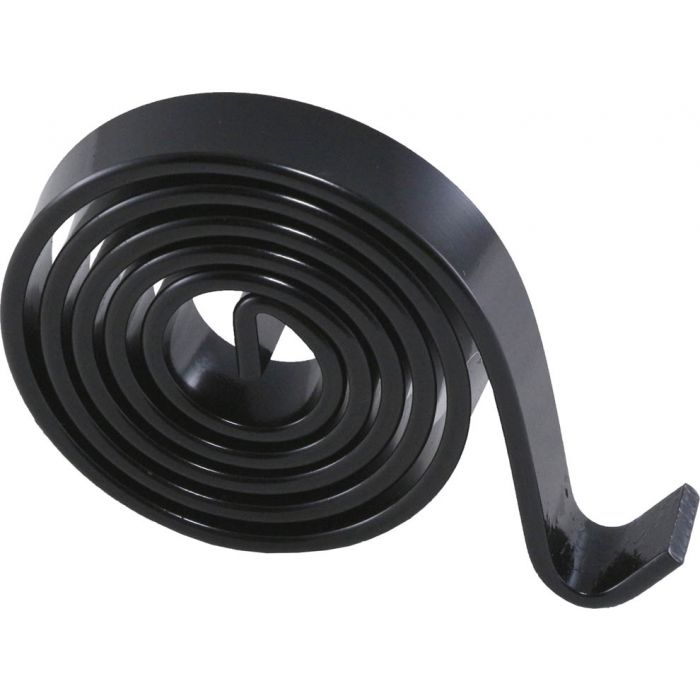

Try the windows with the door open, if it works it's the weather stripping. If not look for a screw / debris in the window tracks. A super dry door window seal can cause issues.
I would run power to the window motor from the bat and put a ground jumper on it .. If it still has issues , it's either the motor or the tracks are jamming / out of alignment.
Do you know if the spring is broken or rusted? That can do it also.

All new regulators, springs and motors. Tried with door open, no difference I bypassed the switch and it didn't work. Motor works. I am leaning to a bad ground. especially that the light dim when pressing switches. My problem is that wiring is foreign to me. I am a complete novice. I know I have to find where the ground is bad, but i have no idea how to do it or what to look for. I did look at all ground wire connections and they are all grounded tightly to bare clean metal.
