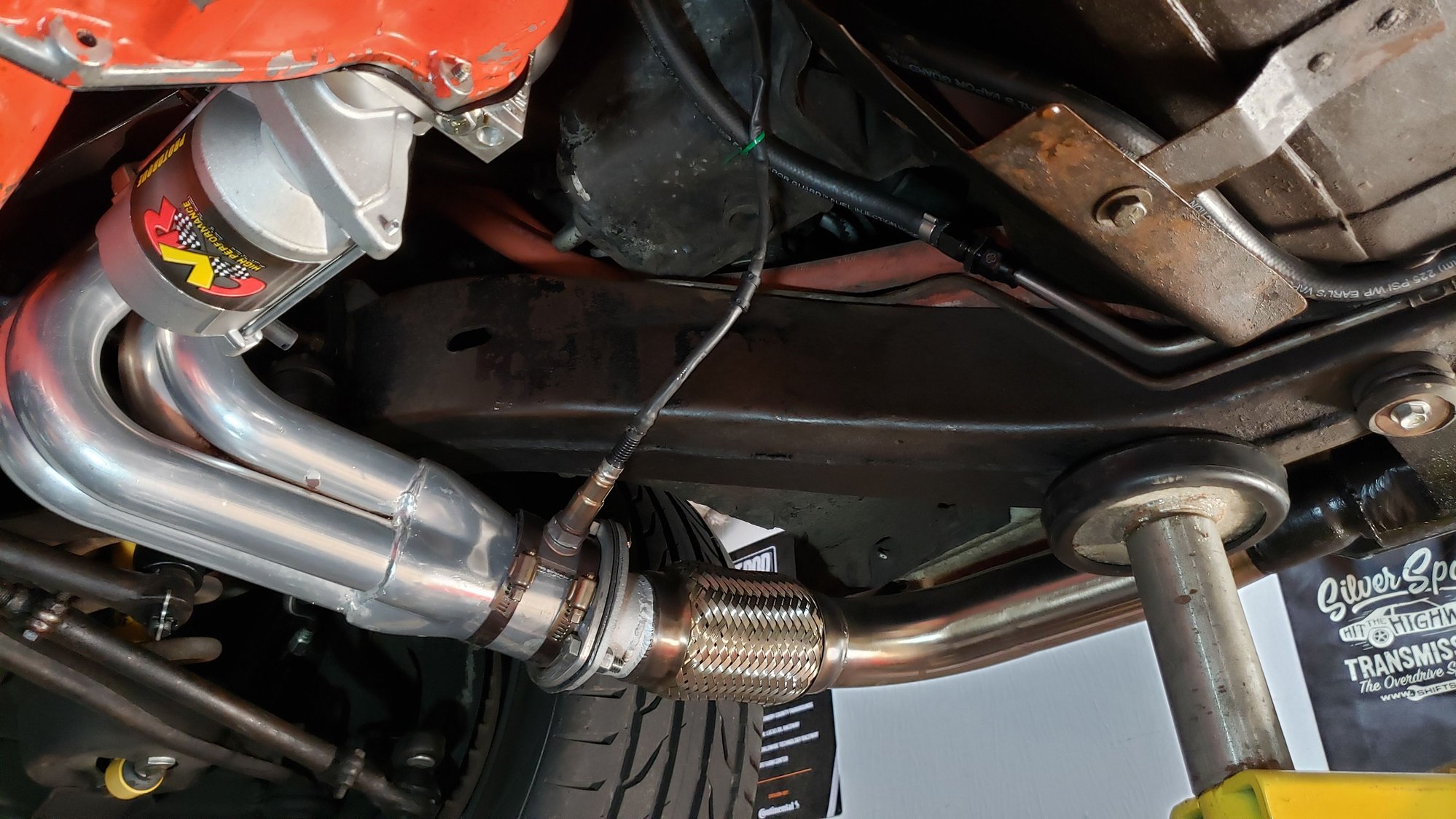

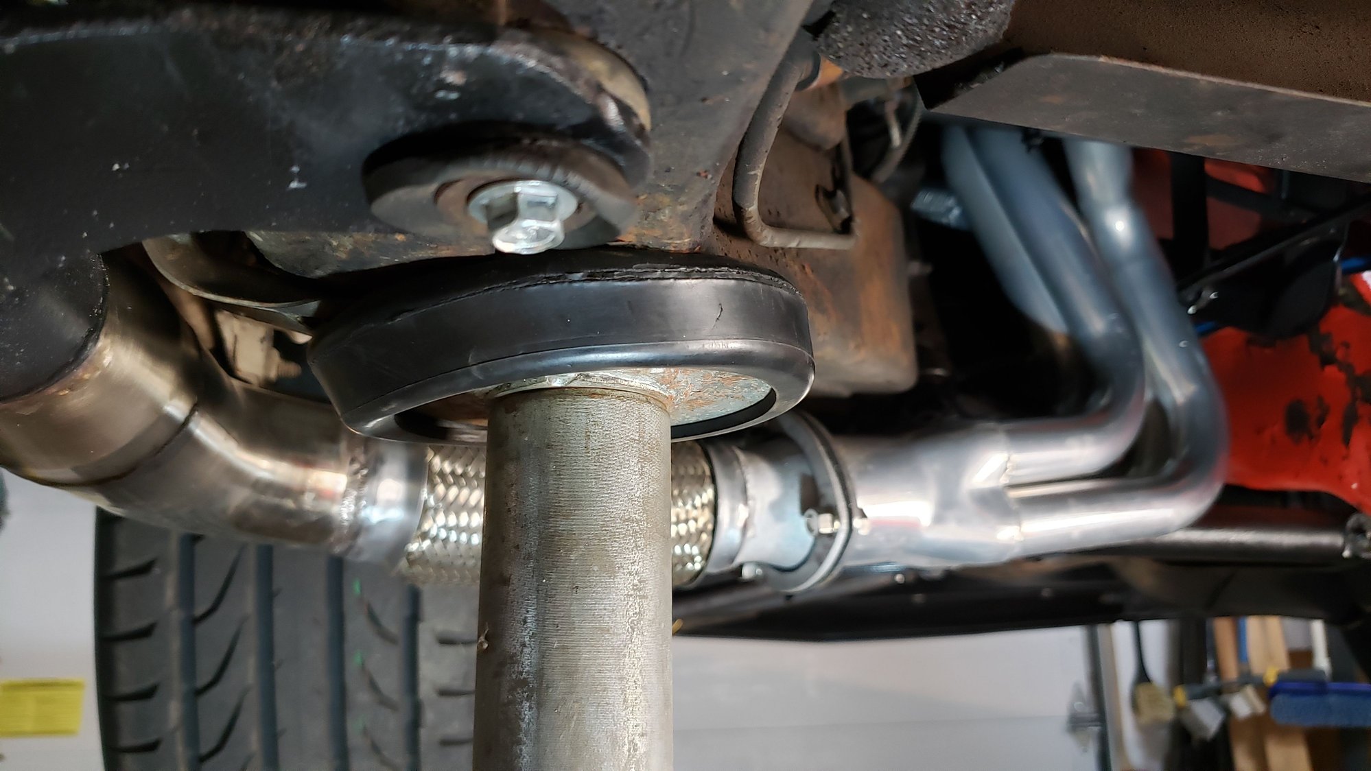

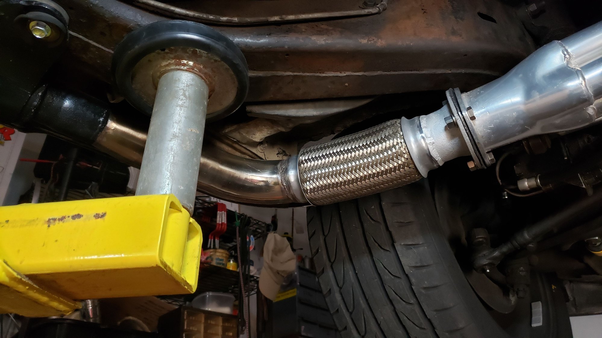

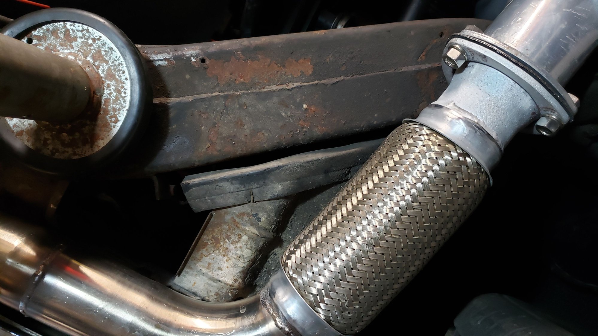

I found flex SS pipes online , turned out, I used a shorter flex on passenger side because of the engine off-set, and header length, but no biggie, no one really sees it,, Just takes a little fit-up, and all hooked up great. Its all welded from side-pipe muffler to header collectors..
Hopefully ya get the idea of what i did.
