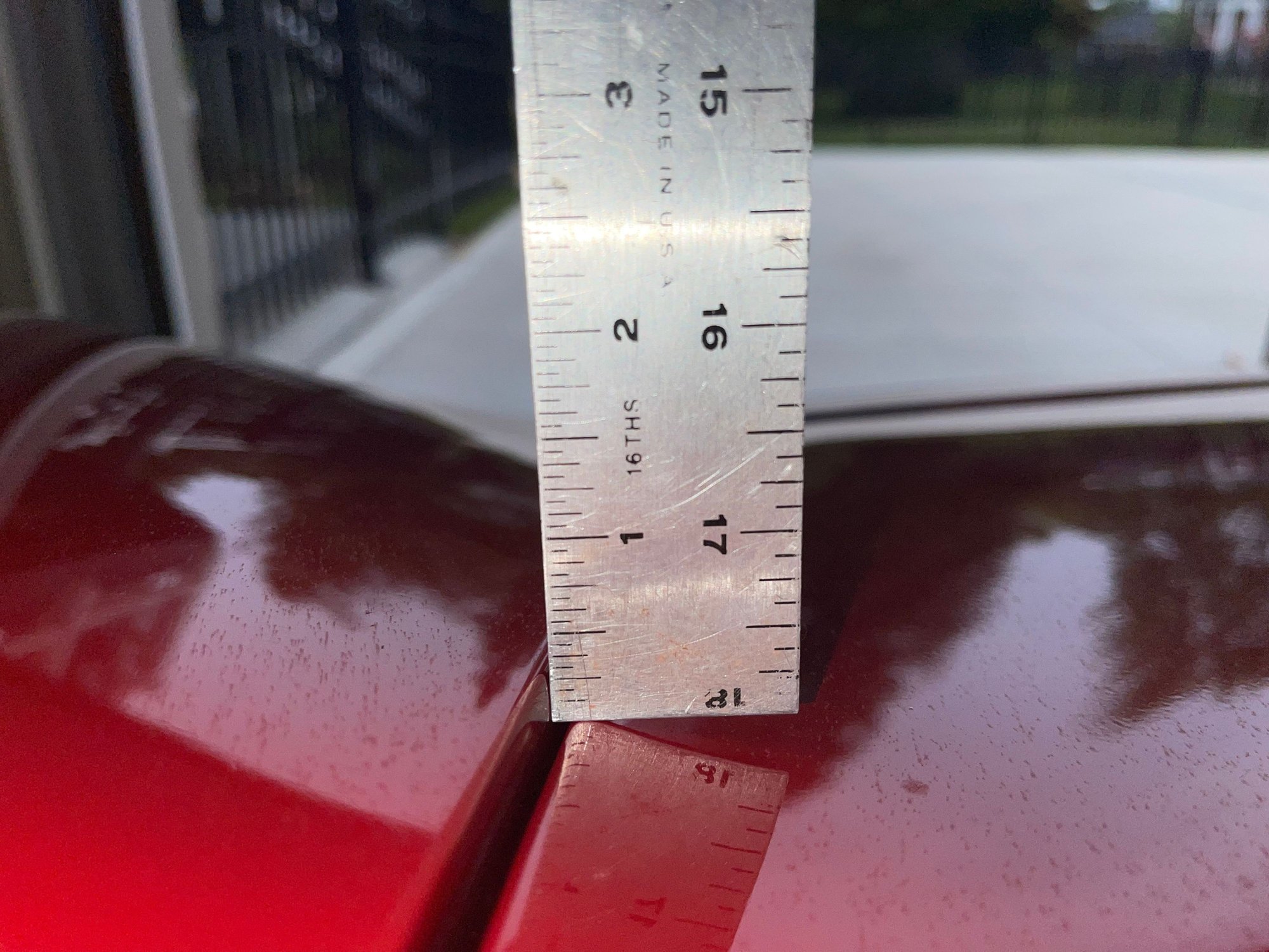

Just installed a set of 4 hood bumpers purchased from one of our vendors..
I added them bc the PO had removed them..
My ? is what am I supposed to be looking for in the alignment of the hood vs the fender seams????
Not even sure why they were included with the build?
The only thing I notice is that the drivers side section of hood close to the front and matching side of the fender is not flush with each other?
TIA
JJ78

That is what the bumpers are for, to align the hood with the fenders so that they are even. This is were I needed to place the bumpers on my
wife's 73 so that the top of the hood matched the the top of the fender.
Donnie

Tx for the input Donnie and that's what I was thinking...And mine are installed exactly where the glue marks are from the missing ones??
Should I just remove them and leave it like it was before I put then in bc then all hood and fender seams were perfectly even??
JJ78

If you don't need them and the hood and fenders are even, I wouldn't worry about it. You will have them for future use if needed.

How much correction can the bumpers give? I have a mismatch of about 3/8” on the left side, and a 1/4” on the right.
